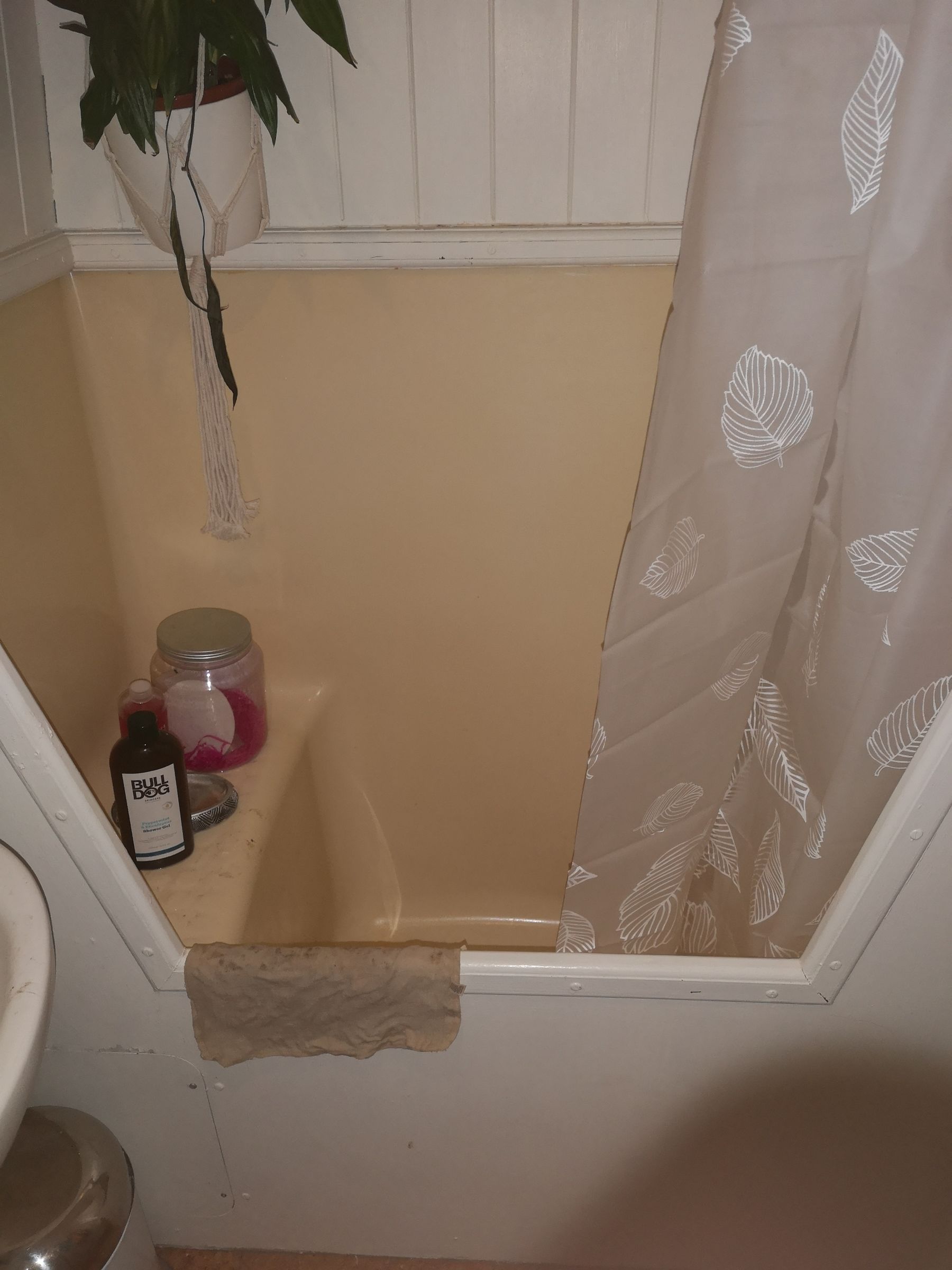

Our shower is like one of those hip bath types things
There is a pump fitted in the plug and sucks the water out when switched on

I suspect ditchcrawler means something like this, a pump in a box with a float switch, they are notorious for leaking. The other option, which it sounds like you have, is a pump connected directly to the bath that pumps overboard.

1.That is an A bath and unless the water is leaking it is very unlikely that shower water can leak out of it.
