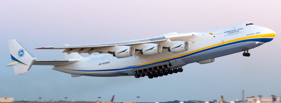

Aeroplanes.  Antonov AN225 ? :)

Doubt if its flying automatically taking off or landing.  Many folk don't really know what fly by wire means which is not really anything to do with auto pilot ''George'' All it means is that all the adjustable flying surfaces are not worked direct by mechanically cables and rods but are electric hydraulic controlled and wired up via computer and still needs the normal pilots input when flying manually.  Biggest plane in the world, that, and only one of them, Ukraniam built near Kiev.
Same as modern car accelerator pedals. It's a wired system not a cable. No direct physical connection between pedal and engine speed control.
