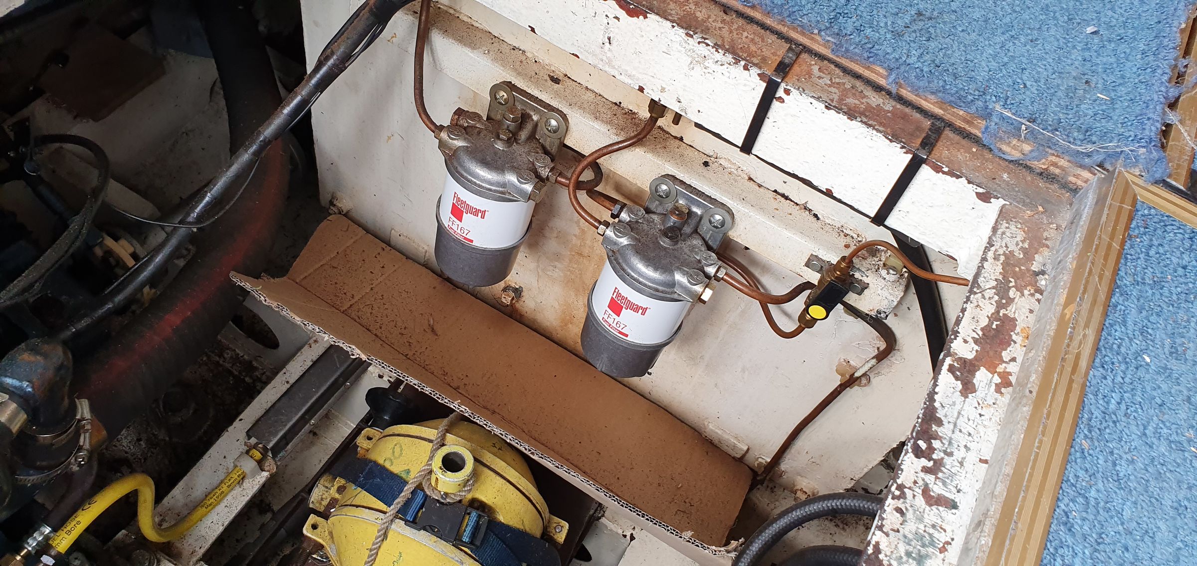

Tomek Posted August 4, 2019 Report Posted August 4, 2019 Hi All! I'm due engine service and was wondering if I should service two additional filters attached to my tank. I know they are fuel filters but my question is... do I change them the same way I would change my engine filters? Thanks!
Tony Brooks Posted August 4, 2019 Report Posted August 4, 2019 I think they supply two different pieces of equipment. One is acting as a water separator for the engine and the other may be acting as a water separator and filter for something like a diesel stove or boiler. The elements are very cheap from motor factors (ask for a CAV 296 type) so it is not worth not changing them and inspecting what they have caught. However unlike spin on fuel filters you will not be able to fill these with fuel and care needs taking to ensure you get all 3 or 4 O rings in the correct place. If the tank is full of fuel I hope you can bleed them by gravity from the 10mm hexagon on top of the small turret on each filter head.
Drayke Posted August 4, 2019 Report Posted August 4, 2019 If you do change these filters and you have trouble bleeding them try using a vacuum type pumps for sucking the oil out of your gear box, cant think of the name of them, on the 10mm hexagon on top of the small turret on each filter head. Hope that makes sense.
beerbeerbeerbeerbeer Posted August 4, 2019 Report Posted August 4, 2019 The corrugated cardboard looks sturdy enough to last til the next service ? What’s the yellow bit strapped down?
blackrose Posted August 5, 2019 Report Posted August 5, 2019 (edited) 13 hours ago, Tomek said: Hi All! I'm due engine service and was wondering if I should service two additional filters attached to my tank. I know they are fuel filters but my question is... do I change them the same way I would change my engine filters? If your engine fuel filter is a spin on type then the answer is no. The difference is that with the water trap separators in your picture you have to drain the metal bowl by undoing the small drain plug underneath first. (I put an old washing up bowl underneath.) Then undo the screw in the centre at the top of the unit to remove the bowl. Then you can take the element off. They'll be at least 3 different o- rings to replace so make a mental note of where they are as you remove them. There's a large one stuck in a recess underneath the top metal part but some people don't bother to change it. And as lugsy said, turn the fuel tank isolator off before you start. Edited August 5, 2019 by blackrose
Tomek Posted August 5, 2019 Author Report Posted August 5, 2019 (edited) 6 hours ago, Goliath said: The corrugated cardboard looks sturdy enough to last til the next service ? What’s the yellow bit strapped down? Hehe it was there when I got the boat. And as it is my first boat I've no idea why it could be there. Dont want to risk sinking until I know what I'm actually doing so not removing it yet ? and the yellow thing is manual bilge pump . Old school! Edited August 5, 2019 by Tomek 1
beerbeerbeerbeerbeer Posted August 5, 2019 Report Posted August 5, 2019 1 hour ago, Tomek said: Hehe it was there when I got the boat. And as it is my first boat I've no idea why it could be there. Dont want to risk sinking until I know what I'm actually doing so not removing it yet ? and the yellow thing is manual bilge pump . Old school! Might be there to detect/reveal any leaks from the filters or pipes? ? There may have been an issue before, or perhaps the filters were changed and just to check they’d sealed properly card was put under?
Tony Brooks Posted August 5, 2019 Report Posted August 5, 2019 It looks stout enough to support an ice cream carton so you do not have to faff about draining the bowl so can just unscrew the through bolts and drop the lot into the tub.

Neil2 Posted August 5, 2019 Report Posted August 5, 2019 58 minutes ago, Goliath said: Might be there to detect/reveal any leaks from the filters or pipes? ? There may have been an issue before, or perhaps the filters were changed and just to check they’d sealed properly card was put under? I'll own up to never having got a 100% seal on this type of filter and the cardboard is a familiar sight. They are a pain in the neck with all those stupid o rings I'm just glad my present boat doesn't have one.
Kingdom Isambard Brunel Posted August 5, 2019 Report Posted August 5, 2019 10 minutes ago, Neil2 said: I'll own up to never having got a 100% seal on this type of filter and the cardboard is a familiar sight. They are a pain in the neck with all those stupid o rings I'm just glad my present boat doesn't have one. I don't understand why you should have problems with the O rings on these filters. They have been a standard fitment for over 80 years on all sorts of diesel engines, in LandRovers, Taxis, Boats and generators. Inexpensive and cost effective, they continue to be popular.
Keeping Up Posted August 5, 2019 Report Posted August 5, 2019 I too have no difficulty with the o-rings on these filters, though I admit I don't change the top one every time. I did used to have problems with the drain plug not re-sealing with it's original soft metal washer but bought a couple of hard rubber washers from Midland Chandlers and now it seals perfectly. Incidentally you CAN pre-fill the bottom bowl with diesel which makes it a lot easier to bleed the air out.
ditchcrawler Posted August 5, 2019 Report Posted August 5, 2019 32 minutes ago, Neil2 said: I'll own up to never having got a 100% seal on this type of filter and the cardboard is a familiar sight. They are a pain in the neck with all those stupid o rings I'm just glad my present boat doesn't have one. All my filters both pre/water and on engine are this type so diesel reaching the on engine filter is effectively already cleaned by the first on
Neil2 Posted August 5, 2019 Report Posted August 5, 2019 55 minutes ago, Boater Sam said: I don't understand why you should have problems with the O rings on these filters. They have been a standard fitment for over 80 years on all sorts of diesel engines, in LandRovers, Taxis, Boats and generators. Inexpensive and cost effective, they continue to be popular. Don't get me started ..... Tattoos, beards, Love Island, Facebook, Football, Donald Trump, Strictly Come Dancing.......all these things are apparently popular these days but I reserve my right and my opinion to dislike them all. (That is not an exhaustive list, by the way.) 1
