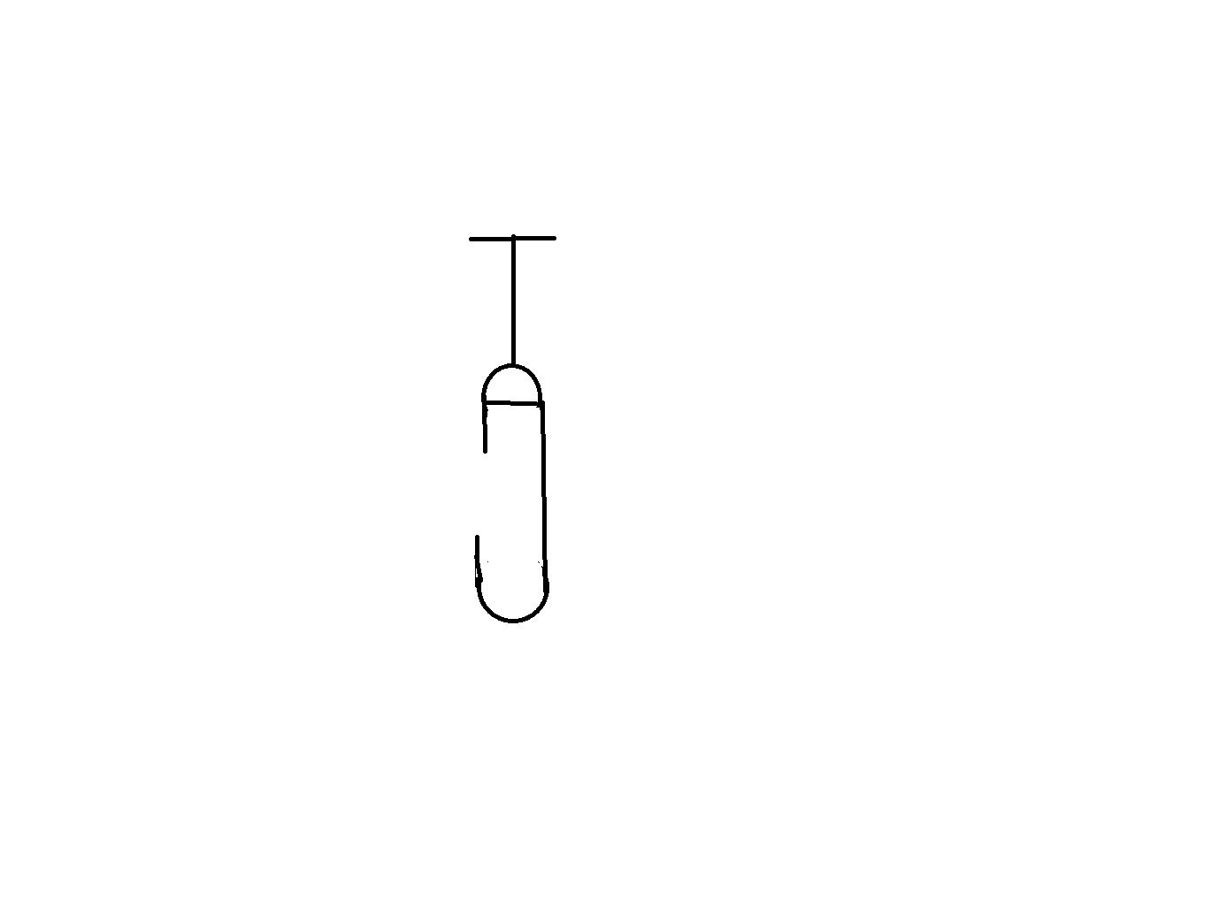

Not bought, they had them made, just a length of rod welded to the top of the hook and then a T handle

12 hours ago, ditchcrawler said:
I have seen Nappie Pins with a T handle welded on the top so you dont have to bend down to slip them in or remove them
I've got them!
When I mentioned them before someone posted a photo of someones. I made mine out of 6mm bar in about 10 minutes each (and I'm no welder). Were I making them again I would use 8mm.
No bending, no wet knees.
I've never seen them available commercially

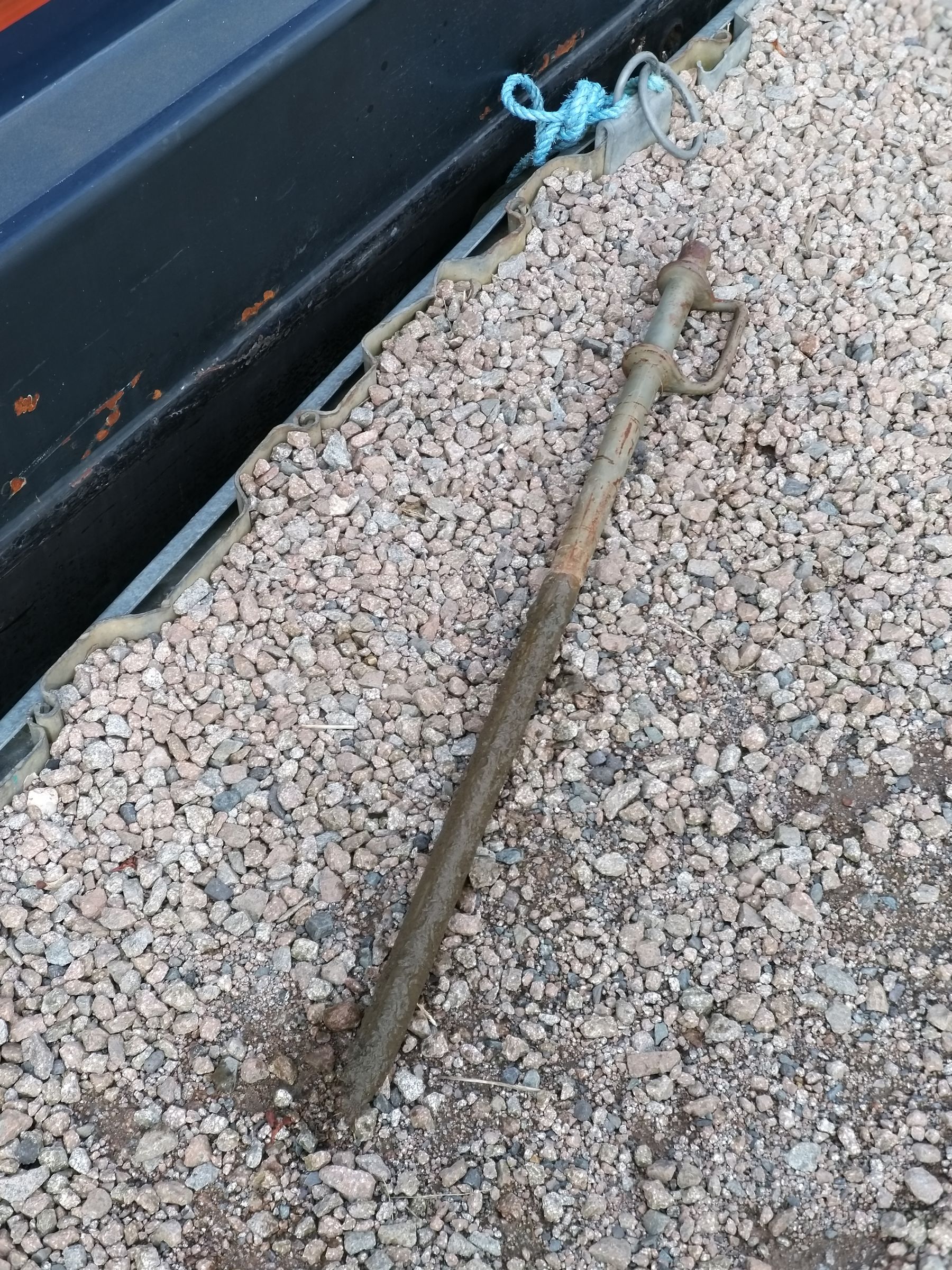

3 hours ago, alan_fincher said:
From what I have seen of the many boats local to here that try to moor with a mooring stake dropped into the piling it can be an unreliable method and they oiften come adrift.
Ah...you've not seen my mooring stakes then have you...
1 hour ago, Slim said:
I've got them!
I improvised mine using a straight length of wood bound with tape to the long side of the safety pin.... but only partial success...the wood was a bit too thick and stopped the pin going through the gap - especially when blocked with weeds.
I guess an 8mm rod would solve the problem for both of us.
...and also as a refinement...  as I found the pins could somehow become un-hooked and slip out during use (weird geometry of angles, pull and height)  I twisted the pins so the hooks were at right angles to each other. .... I used a blow lamp to get the shaft of the pin red hot... and then to make a left- and right-handed pair ... that then are used front and rear to suit which side the boat is moored.....

4 hours ago, Slim said:
I've got them!
Do you mean you made them without any welding? I've never welded and it's a bit late to learn...  in the meantime, I'm picking up a paint roller and a radiator one. Great ideas and my spine thanks you.
Just have to remember to use the right ones, I had a pair of the other type of piling hooks made like that, get them right and they didn't budge, get them wrong and they popped straight out
No, it did involve welding. What I meant was that it was very basic welding. Anyone who welds anodes on could do 2 in 15 minutes.
Thanks. I must know someone who can weld...
