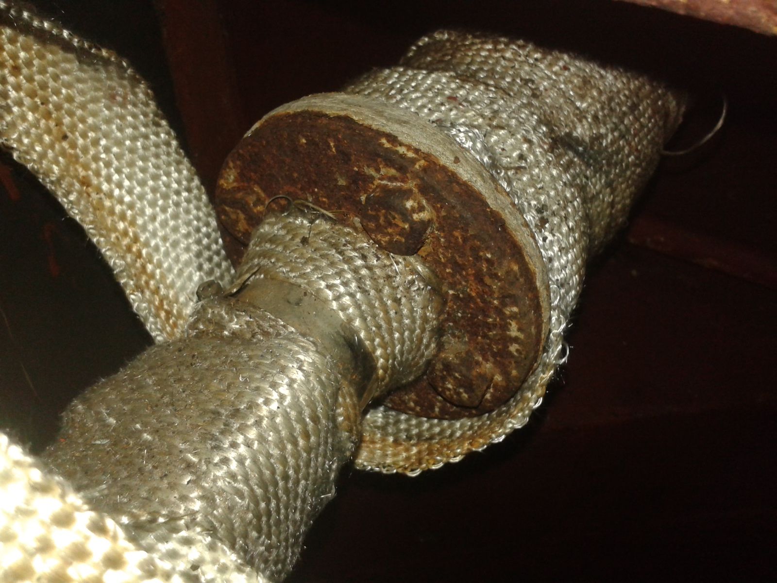

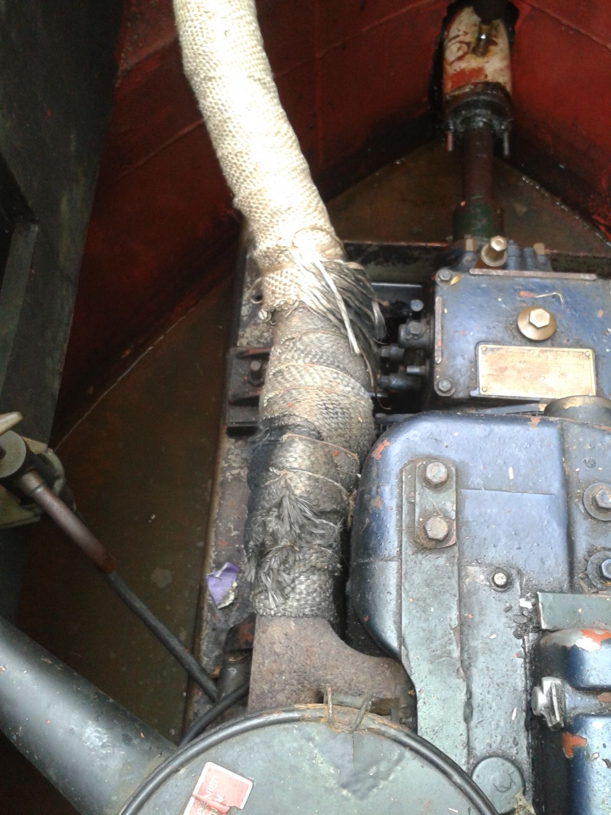

Tom llewellyn Posted August 13, 2020 Report Share Posted August 13, 2020 I have an SR2 lister engine in my boat. There is sometimes smoke coming out of the exhaust thing, see on the photo where smoke marks are around the material wrapped around. Should I be worried? does it mean its cracked in there? Link to comment Share on other sites More sharing options...
Dav and Pen Posted August 13, 2020 Report Share Posted August 13, 2020 Often overlooked is the wire screen in the lift pump which can get clogged up. If the ops engine is burning this amount of oil in such a short time the exhaust would be really blue. It’s an old engine that’s clearly had a neglected past and the oily bilge suggests a leak which should be fairly easy to find. Link to comment Share on other sites More sharing options...
BEngo Posted August 13, 2020 Report Share Posted August 13, 2020 4 hours ago, Tom llewellyn said: I have an SR2 lister engine in my boat. There is sometimes smoke coming out of the exhaust thing, see on the photo where smoke marks are around the material wrapped around. Should I be worried? does it mean its cracked in there? I would be surprised if it is cracked, unless the engine has been moving around. It is not impossible though. There is a join between the exhaust manifold and the exhaust pipe somewhere under that lot. Remove the wire binding and the exhaust bandage (carefully unwind it) until you can see the join. Take some pictures and post here. Run the engine and see where it is leaking. Spraying WD40 into the air intake with the filter removed will produce white smoke which may help with leak finding.Take some more pictures. Post them here if they show where it is leaking. Buy some suitable Jubilee type clips ready to refit the exhaust bandage. N Link to comment Share on other sites More sharing options...
David Mack Posted August 14, 2020 Report Share Posted August 14, 2020 (edited) If there is a section of flexible exhaust pipe onthe end of the manifold, it could well have rusted through. The proper solution is to replace the flexible. The short term repair solution is a baked bean can (both ends removed and split down its length), two or three 2 inch jubliee clips and a tub of gun gum. And then put back the exhaust wrap to hide the evidence. Edited August 14, 2020 by David Mack Link to comment Share on other sites More sharing options...

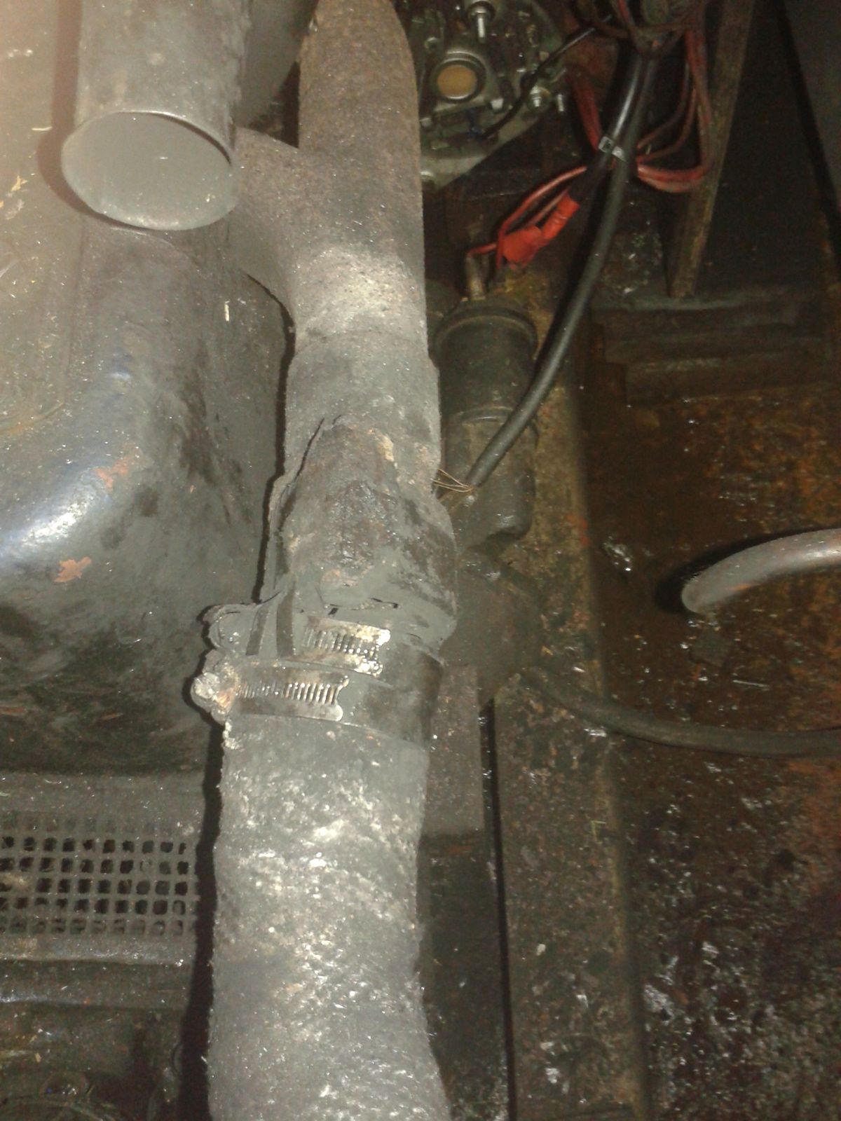

Tom llewellyn Posted October 3, 2020 Report Share Posted October 3, 2020 Hi All, I have finally had time while the boat is in for dry docking to unwrap all the heat wrap. Looks like the exhaust pipe has split before the clamp fitting? Any suggestions what I need to do? Warmly Tom Link to comment Share on other sites More sharing options...
