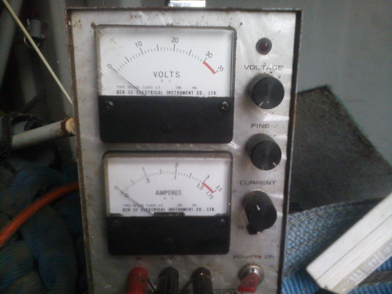

What's a bench power supply?
This? https://www.maplin.co.uk/p/100w-slim-bench-power-supply-n93cx
Yes, you just 'dial in what voltage you want, dial in what amps you want and the output is exactly as YOU dictated.
If you want 15.5 volts and 5 amps you can get it.
That particular one is a bit limited on current but would do the job - you don't need a huge current for equalisation.
Mine is a 1-30 volt and up to 3.5 amps, It rarely gets used as my cheapo 6 amp Halfords charger goes up to 16v (maybe higher, I just switch it off when I think its had long enough).
