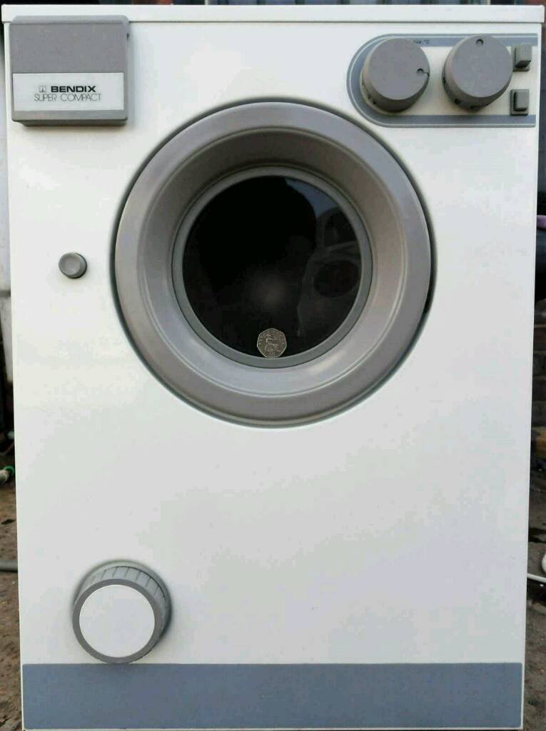

I had a 1980s Bendix Supercompact which was small (2.5kg) but fine for the two of us plus (later) a baby.
The advantage was that it only used 13 litres of water and didn't have any new fangled fancy Dan electronics so would run off any old genny or invertor that was to hand.
It is also built like a tank and is still in service in the workshop to this day washing and preshrinking my creations.
Now we are in a house with two sons (11 and 16) I have no idea how we coped with such a small washer back then.
