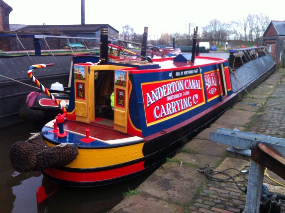

Tiggers Posted February 13, 2014 Report Share Posted February 13, 2014 Shad has finally been relaunched at the National Waterways Museum after extensive work. The work completed includes replacement of a number of pieces of sheering on both the cabin top and sides, the majority of panelling on the port side, new gunwale the length of the cabin, new running gear, a number of pieces replaced in the backcabin, new back doors, new slides, full engine service, new ash strips, all new livery, complete redecoration of the backcabin plus lots more. Of course, she has also been reunited with her original BCN plate thanks to the generosity of many. We are all incredibly proud and a lot of peoples time and effort have gone into this. Now on to Ferret! 1 Link to comment Share on other sites More sharing options...

Laurence Hogg Posted February 13, 2014 Report Share Posted February 13, 2014 Looks nice but I am afraid the shade of blue is far to deep ACC boats had a lighter shade than that and also they were not glossy. I hope you invited David Suchet to the launch as he has funded Shad until the end of TWT,there seems no mention of this? Link to comment Share on other sites More sharing options...

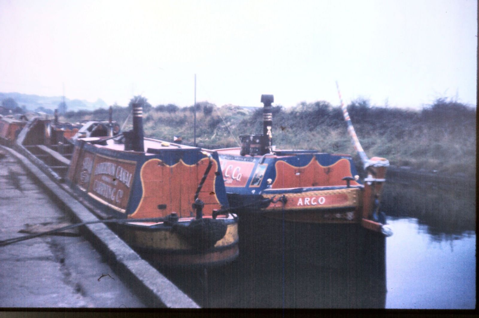

Laurence Hogg Posted February 13, 2014 Report Share Posted February 13, 2014 (edited) Took at the end of their traffic days, note the p/health registration is not on a black background and the red is not a bright shade: Edited February 13, 2014 by Laurence Hogg Link to comment Share on other sites More sharing options...
luctor et emergo Posted February 13, 2014 Report Share Posted February 13, 2014 (edited) My first concern would be the hull. Could do with a bit of blacking... and is that where the BCN plate would be mounted? Edited February 13, 2014 by luctor et emergo Link to comment Share on other sites More sharing options...

Derek R. Posted February 14, 2014 Report Share Posted February 14, 2014 I'm sorry, but when if that is a re-launch was that put back in the water? Very smart and tidy, and a lot of work has gone into it, but there's only blacking down to the rubbing guard, and rust patches and crud along the water line that indicates it's been in the water a while. I hope this isn't spoiling the ship for h'aporth of tar. Link to comment Share on other sites More sharing options...
Tiggers Posted February 14, 2014 Author Report Share Posted February 14, 2014 Sometimes I don't know why I bother trying to share good news. Shad was docked last year, an is coming out again soon as soon as we have the all clear on our bostocks. The colours we got from Tony Lewrey and also looking at mendips original doors, and that's was the only place we could put the bcn plate due to the diesel tanks. And I believe David was contacted. Think this will be all from me on this website, I was so proud when she was done being the first boat I've worked on, and it just gets ruined by people pulling it to bits And we also have pictures of shad clearly showing the registration number is on black. And if that pic was taken at the end of their days Lawrence's, it's likely the red would've faded, as reds do. There was a good couple of weeks consultation over the colours, finding original parts of Anderton boats, speaking with tony and Phil Speight. I trust them over a picture 4 Link to comment Share on other sites More sharing options...

MJG Posted February 14, 2014 Report Share Posted February 14, 2014 (edited) ... any way red fades, any fool knows that. How a boat painted red appears when it was first built or repainted during it's working life and when it reaches the end of it's working life will be different...... Edited February 14, 2014 by The Dog House Link to comment Share on other sites More sharing options...

luctor et emergo Posted February 14, 2014 Report Share Posted February 14, 2014 As one of those rounded on, for not joining the back slapping masses, I'll respond. Yes , the paint job looks great, and there has without a doubt been a lot of work involved to get Shad where she is now. And plenty of people have already pointed this out, and no doubt plenty more will. With or without knowledge. I commented on the state of the hull, because the hull is what keeps the boat afloat.I did not critisise, or put down the rest of the work, just pointed out that the hull needed blacking, urgently, judging by the state of the waterline. And the BCN plate looks out of place. As far as I am aware (and I'm no expert, but did own the front end of a 115 year old BCN boat, and spoke about it with Malcolm Braine when he surveyed my boat), the BCN plate was mounted to the forward bulkhead, not on the cabin bulkhead. Where it is on Shad, looks like an ornament.. If you think this is unfair nit-picking, you should try showing a scale model you made on a modelling website... arguments about the correct shade of paint of WW II vehicles are never ending.. Link to comment Share on other sites More sharing options...
Derek R. Posted February 14, 2014 Report Share Posted February 14, 2014 (edited) Don't get upset about such comments Tiggers. People who frequent the historic section are interested and keen that some aspects of canal history are not strayed too far from original - it happens. Any subject matter that is in the vein of restoration or renovation be it fountain pens, cars or traction engines will have a core who want things just so. Given colour prints ability to capture some things inaccurately, and given that paint - especially red and blue - discolour over years especially near the end of their working lives - SHAD looks pretty good. As to the registration number being on black, most were like that, and from Laurence's old image it looks to me that that was on black too - but there your are, perhaps my eyes are deceiving me. I don't know if the hull has been checked for thickness, perhaps all is well there, but it needs blacking properly. Edited February 14, 2014 by Derek R. Link to comment Share on other sites More sharing options...
