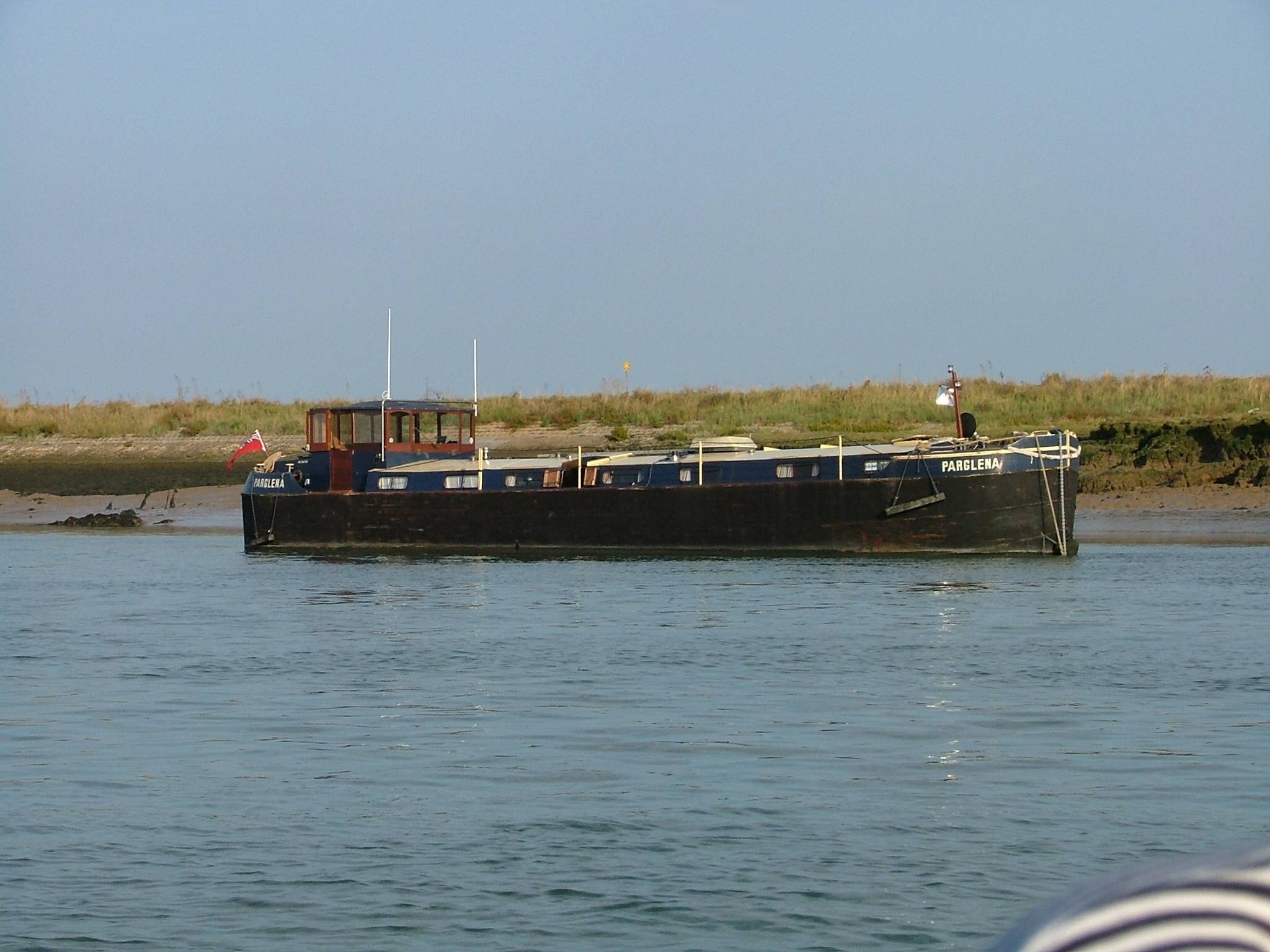

4 hours ago, k_lj said:
I'm interested in buying a boat that is LOA 18.20m, Beam 3.50m, Draught 1.00m, Air draught 2.00m.
Not far off the size of Parglena. LOA 18.7m Beam 3.50m Draught 0.91m AD 1.98m with the wheelhouse down.
Weight on the crane was 37ton so way lower than whoever calculated yours.
Had no problems on the Thames, the GU through London or the Lea and Stort. It did get a bit more difficult the further north I went on the GU,  we moored at Berko.
The only caveat is that this was over 12 years ago so it may be shallower now.
