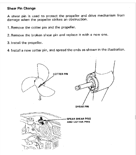

Ever since starting narrowboating I've been surprised that, considering the risks, a common item used on outboard and even outdrive legs is not used on 'the canals'.
A simple shearpin or rubber hub incorporated into the prop ensures that anything giving resistance to the prop limits and minimises any damage as it 'disconnects' the prop at a known load.
If the shearpin comes into play, you simply insert an new one and carry on.
Prop damage limited, damage to brackets, bearings and gearbox very unlikely.
Edited by Alan de Enfield
Dunno, all above my pay grade as they say,
but are shear pins for small engines?
without the gear box?
I’d be changing a shear pin every ten minutes if I had one,
with big engine, heavy prop and gear box ?
Ive a fenner tyre which stretches and allows some give until the engine stalls or the tyre slips and/or shears the bolts.
Saves the gear box and stops the engine turn over off its mounts.
Outboards and Outdrives have gearboxes - Fwd - N - Rev just the same as your NB.
Certainly, larger engines have a splined prop with a 'rubber'hub that slips at a known load.
I've had 200hp "straight 6" Volvo engines with that system.
This one is for 25-75hp which would cover most canal boats.
3 Balde 25-70HP 13 Spline Tooth RH SS Prop Rubber Hub Stainless Steel ...
In my experience most canal boat drive systems are very poorly engineered especially considering what would happen if you get a lock up on the propeller. Ideally the part that fails if the system cannot absorb the shock without damage should be cheap and easily replaceable. Something like a plastic R and D coupling in the prop shaft( you can remove the metal links). Most gearboxes used are far too small to do a proper job on a canal boat and the flywheel drive plates are too weak and don’t last. But of course the biggest problem is the operator who overrevs the engine when they get into shallow water and just pulls everything off the bottom instead easing off.
I'm not sure how easy it would be to make scaled up shear pins. I think the remains might tend to get stuck in the hole and complicate replacement.
It is also worth remembering that the shear pins on outboards are actually drive pins. Without the pin the propeller is not turned by the motor. Obviously.
Relying on a drive pin on a heavy Boat with large amount of torque could be problematic because if that pin breaks you have no drive at all.
