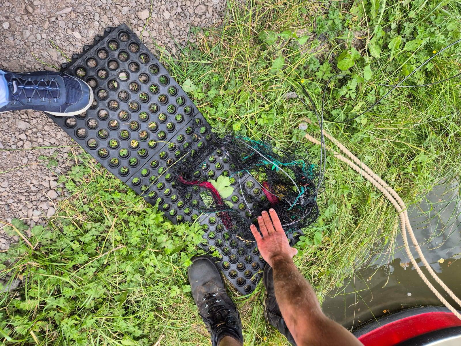

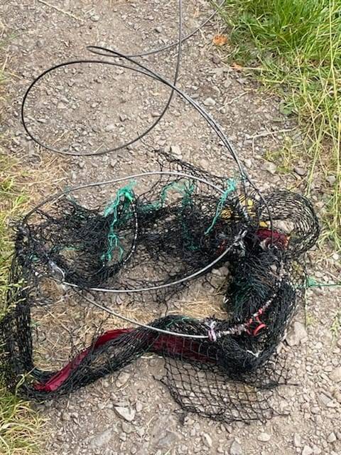

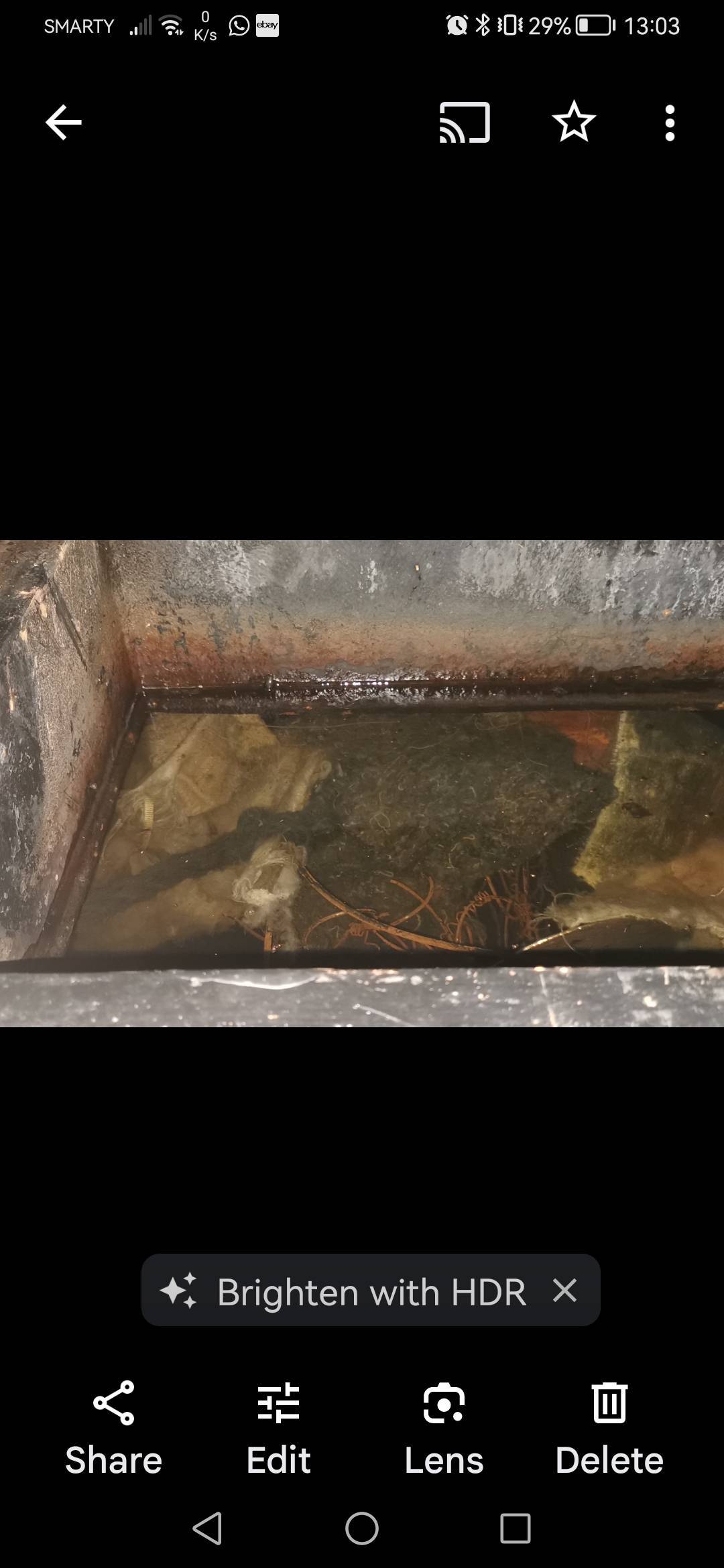

SLC Posted June 29, 2024 Report Posted June 29, 2024 On the Grand Union, my wife reported that our boat lost power. I'm not sure what this meant but whatever it wouldn't move forward but she did berth the boat successfully. I told her to look inside the weed hatch and see if anything was wrapped around the propeller. She had trouble removing the cover so lesson here, service it regularly with the greasey stuff. We found an unlicensed cray fish net firmly entangled around the prop, metal and all. My wife needed help as we didn't have the correct tool(s) on board. Questions. How common are these horrible things? How much trouble do they cause? Secondly, what is the best tool to remove the offending article? Bolt croppers? What size? Thanks in advance.

SLC Posted June 29, 2024 Author Report Posted June 29, 2024 If it was licensed, it would have a tag. It is illegal to use these traps except for scientific purposes. CRT state this too. It was so well made, that cutters wouldn't work. A mallet and sheer brute force did the trick and the boat is moving. Now which sites think cray fish traps are legal?

BilgePump Posted June 30, 2024 Report Posted June 30, 2024 When I can't get a full hacksaw to something I just use a fine tooth blade for one with a rag wrapped round the end to be held (to protect fingers). Manages to go through 10mm chain with some perseverence. Can only do short stroke cuts at the end closest to hand or it bends but otherwise successful. Could get it through the weedhatch and into the tangled mess. Would that work on a wire loop mesh like shown?
ditchcrawler Posted June 30, 2024 Report Posted June 30, 2024 The problem with bolt croppers down the weed hatch is opening the jaws due to lack of room, maybe hop in the canal to do it. 2
Jon57 Posted June 30, 2024 Report Posted June 30, 2024 37 minutes ago, ditchcrawler said: The problem with bolt croppers down the weed hatch is opening the jaws due to lack of room, maybe hop in the canal to do it. Or get someone who can 😁 1

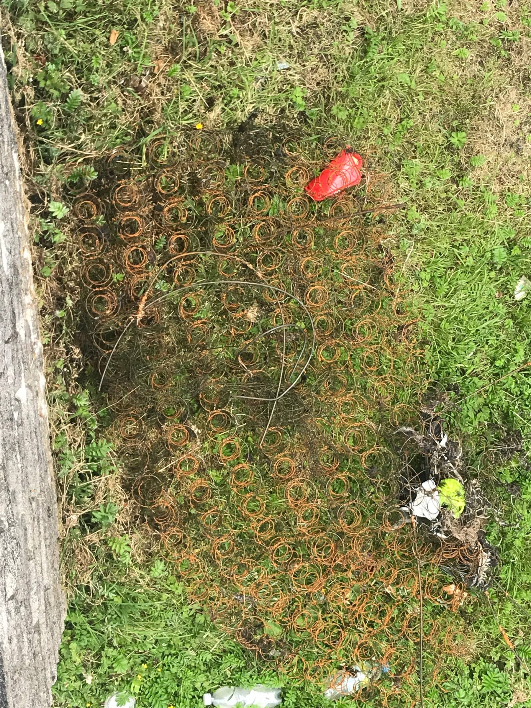

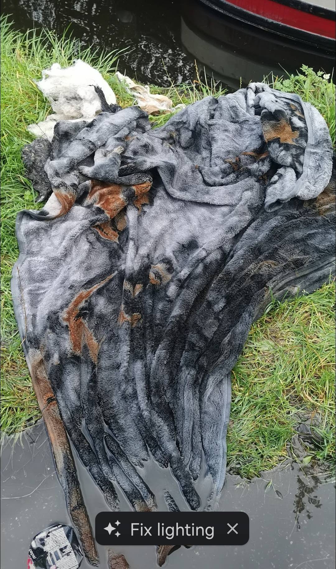

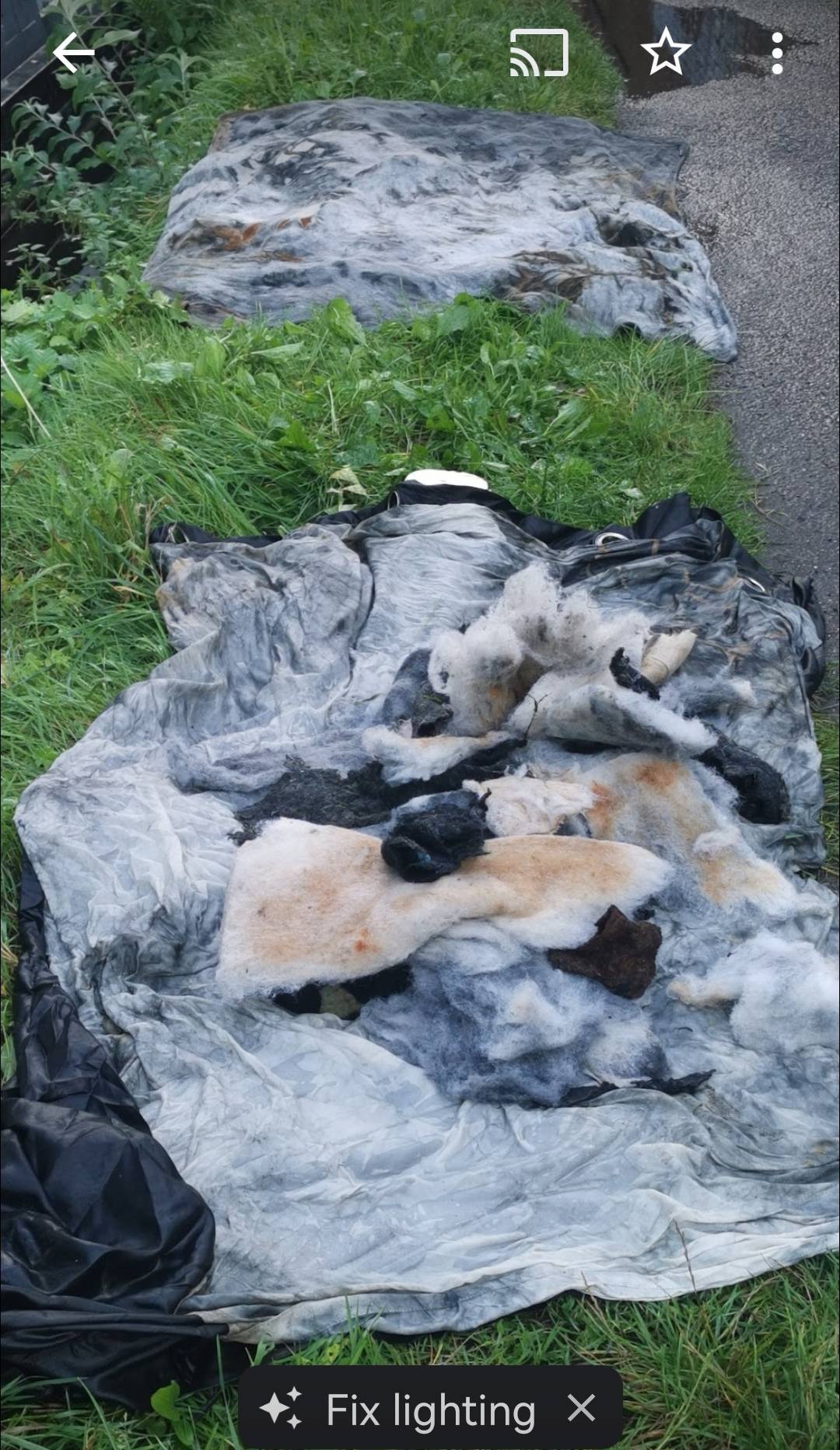

Stroudwater1 Posted June 30, 2024 Report Posted June 30, 2024 What a nasty foul. We find a sharp bread knife for fabrics, hacksaw for tougher stuff/ thick tubular plastic or metal or the thick metal borders of mattresses. Possibly useful for car tyres. Stanley knives can have their use too. Then these Knipex cutters for metal wire or springs probably thicker metal. Brilliant for mattress springs. https://www.knipex.com/products/cable-and-wire-rope-shears/wire-rope-cutters-forged Ditchcrawler is spot on, bolt croppers are fairly hopeless for most weed hatches as the arms don’t open sufficiently before the hatch restricts opening further to actually get the cutters around the metal. Knipex do smaller ones but I’m not convinced they would open enough without fouling. The problem is that some cuts need to be across the width of the weedhatch. The arms are long and unwieldy underwater too. Some elastic around the arm and tied to the tool can help avoid loss of them during work... Watch out for Weils too if working under water and wash carefully afterwards. It’s surprising how many put the results of a foul back on the towpath only for it to dry and blow/ get chucked in again. Keep under deck by the hatch and bin!! Lastly look after other boaters and please carefully yank out floating coats fabrics plastic bags and potential problems if possible when passing or at locks and bin too. 2

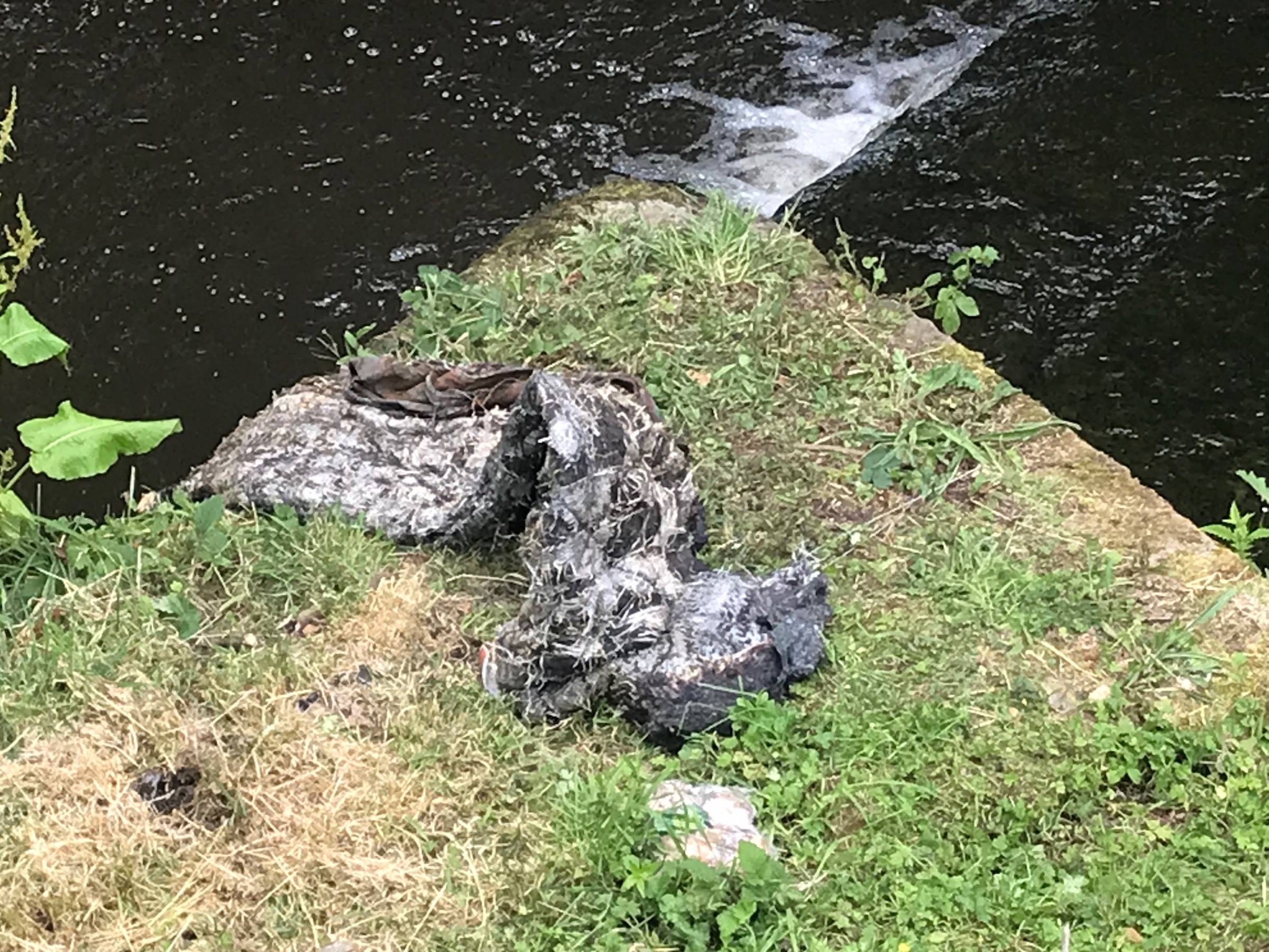

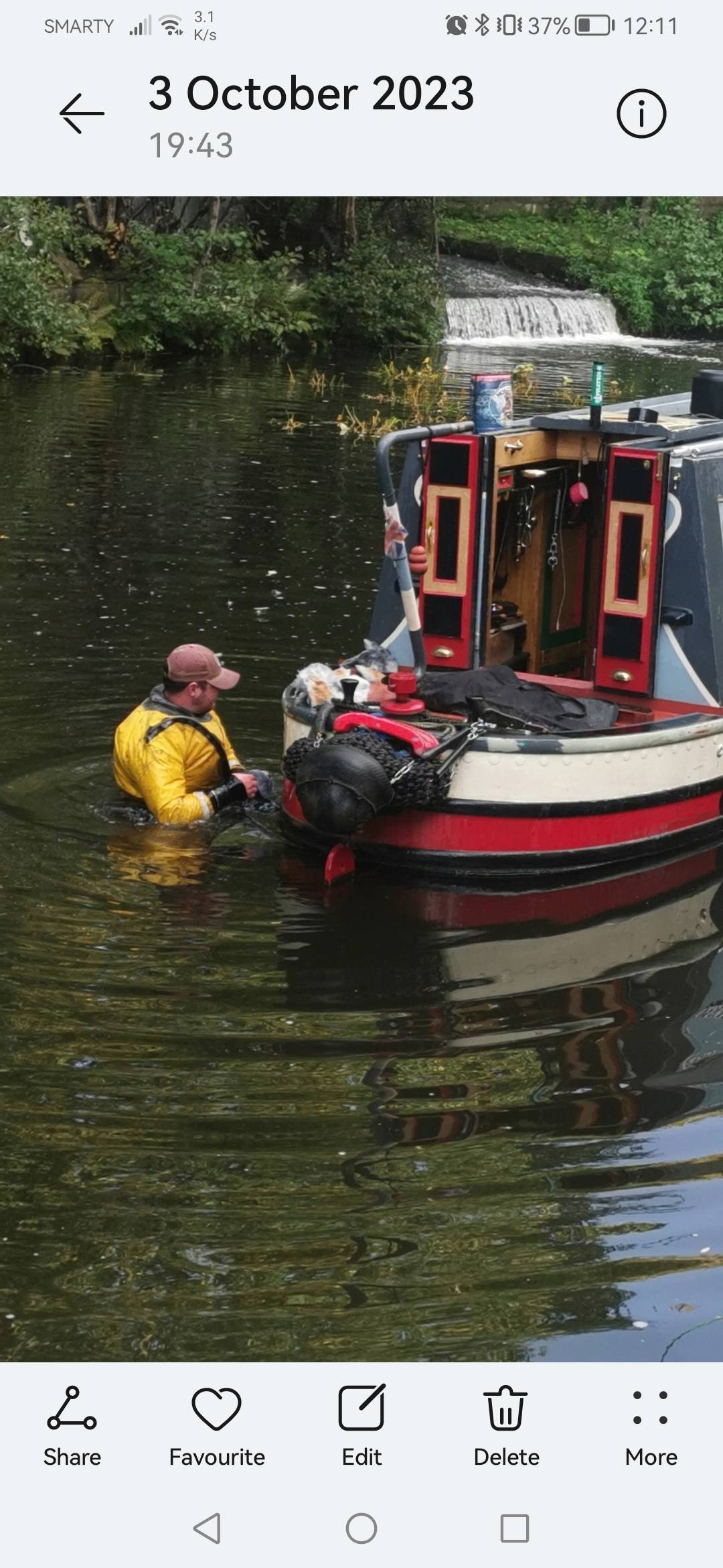

Jon57 Posted June 30, 2024 Report Posted June 30, 2024 17 minutes ago, Stroudwater1 said: What a nasty foul. We find a sharp bread knife for fabrics, hacksaw for tougher stuff/ thick tubular plastic or metal or the thick metal borders of mattresses. Possibly useful for car tyres. Stanley knives can have their use too. Then these Knipex cutters for metal wire or springs probably thicker metal. Brilliant for mattress springs. https://www.knipex.com/products/cable-and-wire-rope-shears/wire-rope-cutters-forged Ditchcrawler is spot on, bolt croppers are fairly hopeless for most weed hatches as the arms don’t open sufficiently before the hatch restricts opening further to actually get the cutters around the metal. Knipex do smaller ones but I’m not convinced they would open enough without fouling. The problem is that some cuts need to be across the width of the weedhatch. The arms are long and unwieldy underwater too. Some elastic around the arm and tied to the tool can help avoid loss of them during work... Watch out for Weils too if working under water and wash carefully afterwards. It’s surprising how many put the results of a foul back on the towpath only for it to dry and blow/ get chucked in again. Keep under deck by the hatch and bin!! Lastly look after other boaters and please carefully yank out floating coats fabrics plastic bags and potential problems if possible when passing or at locks and bin too. Even RCR took 3 hrs to get this lot off. We tied the mattress to the lock landing bollard and informed crt.
Stroudwater1 Posted June 30, 2024 Report Posted June 30, 2024 (edited) 1 hour ago, Jon57 said: Even RCR took 3 hrs to get this lot off. We tied the mattress to the lock landing bollard and informed crt. Luckily “our” most recent mattress on the Rochdale was more rotted down. 🤣It took around two or three hours too. A lowered pound can help too, moor on what feels stable but shallow then drain enough to expose a blade of the prop. As I expect RCR did you just have to keep cutting. Hopeless advice if this happens on the BCN main line though, / get carefully towed to a lock and a pound of short length Edited June 30, 2024 by Stroudwater1
