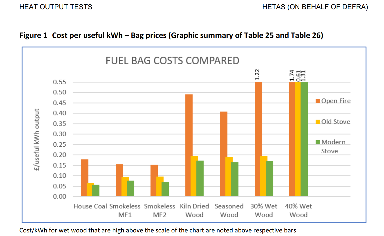

The government have done some heat output tests and the results indicate kiln dried wood is about 2.5 times more expensive per kw/h compared to smokeless coal. The only way it's cheaper is if you can get free wood.

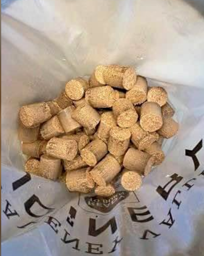

I have been trying these at home I pay £3 for 10Kg. I find them very controllable from just a smoulder to flaring away, a lot cheaper than logs.  I thing they would work well in a small stove. My stove is quite large so I mix them in with soft wood
What are they called? They look like giant wood pellets
Wood briquettes.
These need to be stored dry. If you get them damp they turn into porrridge.
Brilliant for burning and often very cheap depending on the season. I found some of these which were waste from a window frame production company and they only wanted 50p for 20kg. In the middle of the summer. Better than landfilling the sawdust.
A lot of wood product companies have bought the briquetting machines. I imagine there was some fairly well thought out marketing but I'm unsure as to whether it proved economically sensible. When I bought some of these they were offering to cart a van load to the Boat for a good price. Trouble is they turn into porridge (inedible but exactly the same consistency) at any hint of moisture. They really do. Would be great dehumidifiers or bilge soaker uppers.
Screenshot_2024-03-28-19-25-15-413_com.brave.browser.jpg.21b39419c51a676cafa5b2254c8510b1.jpg
Just a random example. There will be others.

1 hour ago, magnetman said:
Wood briquettes.
It was you who seeded the idea on a thread about getting wood and the fact there are lots of outlets near canals . I am using them at home so stacked in the garage

1 hour ago, booke23 said:
I've considered this question myself in recent times and it is certainly cheaper to burn smokeless coal per kw/h of output. As mentioned coal has a much higher output per kg.
Interesting bar chart, thank you.
I did my own cost comparison calcs back during Covid and I spent quite a lot of time researching the cost per kWh in the various fuels. Wood was the most difficult to pin down. I can't remember my methodology for the wood but it was based on the price of a cubic metre of kiln-dried oak, including delivery to me and the cost I came up with was 7p per kWh. Solid fuel was 8p per kWh.
Quite a difference from the bar chart above but mine was for the total calorific value of the fuel, not the 'useful' calorific value which strikes me as a matter of opinion!
