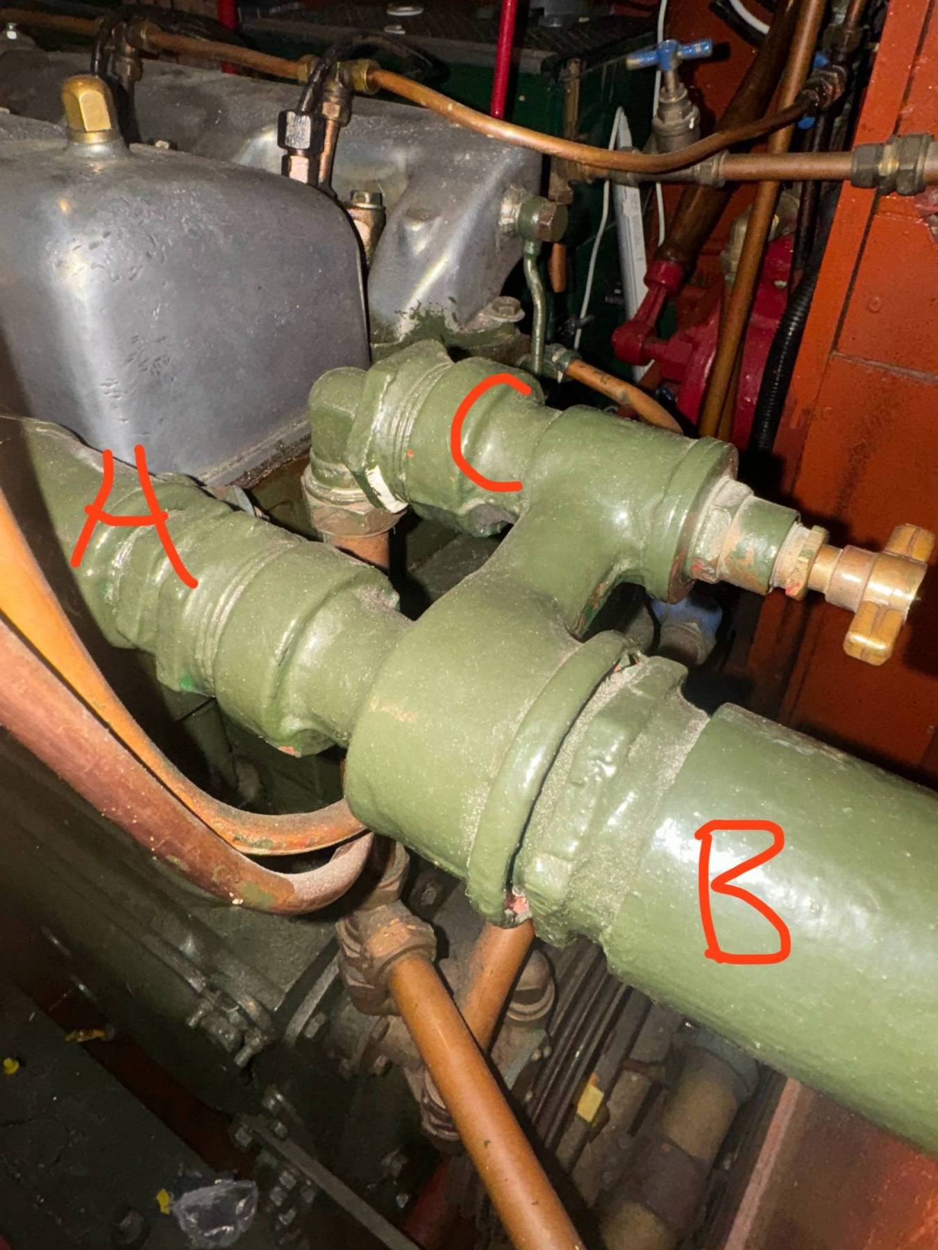

  1. I didn’t specifically ask because I couldn’t remember the exact setup. The calorifier is 15mm tube which I don’t think is enough for it to be included in the bypass circuit. Although again a restrictor pipe would help ensure that the calorifier is the favoured route. The thermostat does not shut off the bypass - it simply opens an additional 1” bsp pipe. However if this is going straight down to a 15mm pipe that doesn’t seem ideal?
  2. Sorry for the weird title. Thanks to some helpful pointers earlier for my old engine I am now the owner of a thermostatic housing to direct hot water away from my engine and towards the calorifier. However I am not sure whether I need something to restrict the flow back into the engine. Let me try and explain When cold - the engine thermostat will be closed and water will exit the engine and run directly through the pump intake and straight back into the engine with no restriction on the flow. When hot the thermostat will open and allow water towards the calorifier and skin tank. HOWEVER there is nothing stopping water flowing through the original circuit and back into the engine. I estimate most of the water will flow back into the engine. After all - it can either flow direct back into the engine unrestricted or push through the thermostat and round the calorifier coil and through a skin tank and back to the pump. Surely I need just a bit of resistance in the original engine bypass circuit? Some sort of fitting that increases the pressure build up behind so that when the thermostat opens it will prefer the longer route. Does any of that make sense? Or am I over complicating something very simple? Many thanks in advance
  3. Just been to redshaws and they have sorted me out with a thermostat to fit 😊 thanks for all the help.
  4. C goes directly back into the engine. So at the moment the bypass valve is either on or off. As soon as the engine is up to temperature and I close the valve the smoke from the exhaust turns white showing that it is not fully heated. I am getting better at not fully closing the valve to try and get a balance but that is obviously dodgy if I make a mistake and the water boils. The pump is never prevented from pumping - it either pumps back into itself or into the calorifier and then the skin tank. many thanks.
  5. Hi, I have a Ruston Hornsby 3 cylinder engine and the thermostat does not exist and so when starting there is a bypass valve that has to be opened to get it up to temp. Once up to temp (normally whilst cruising along) I have to run inside and close the bypass where the engine then runs cold until the calorifier is up to temperature. None of that seems ideal. I have been trying to find a thermostat that I can plumb in to the 22mm pipe or a BSP fitting. Does anyone know of anything suitable? On the attached picture A is the outlet from the engine. B goes towards the calorifier and C goes straight back into the engine. Many thanks.
