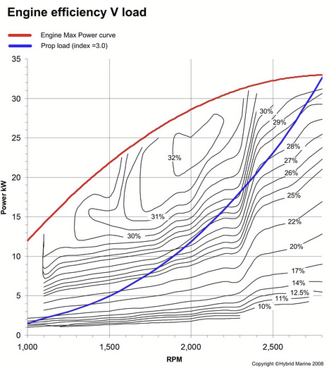

If you're running the engine just for charging, more load (higher alternator current) and higher rpm means higher engine efficiency -- see attached plot for a Beta 43 with some actual numbers.
As has also been pointed out, some engines don't like running under heavy charging loads at low speed for extended periods, for example Beta say in their manual (and on warning stickers) that this should not be done below 1200rpm.
And as Tony said, alternators also don't like providing lots of current/power while turning slowly, they get very hot. A 125A alternator probably won't provide full current for very long without overheating, at 100A (80% of rated) the alternator load on the engine would be about 2.5kW with the engine out of gear (12V alternators are only about 50% efficient).
The curves below show this is similar to prop load at 1200rpm for a Beta 43, and it turns out it's better to do charging while travelling if fuel consumption is the concern:
Charging out of gear at 1200rpm : 2.5kW load at 17% efficiency = 15kW from fuel
Cruising at 1200rpm : 2.5kW load at 17% efficiency = 15kW from fuel
Charging while cruising : 5kW load at 23% efficiency = 22kW from fuel ==> 7kW extra for charging ==> halved fuel consumption for charging!
-- even in this case engine output at 1200rpm is only about 30% of maximum, which is why the efficiency is low, peak efficiency is about 30% at 13kW output

Here's the chart from the Beta 43 manual. Notice the fuel consumption graph at the bottom....there is hardly any difference in hourly consumption between 800 and 1200 RPM, but likely a big difference in alternator output.
