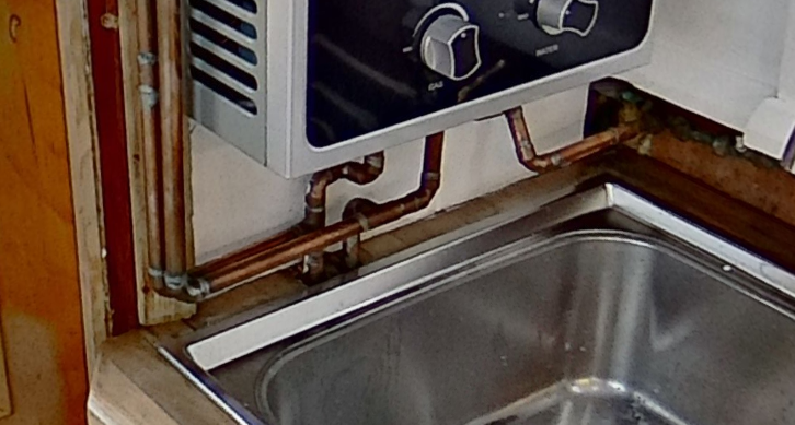

25 minutes ago, PaulD said:
Gas pipework to boiler has soldered joints. Next BSS will be interesting.
Maybe they are a silver-brazed
Is that gas or water ?
– brazed joints are also permitted, but examiners must take particular care when endeavouring to determine whether such connections are brazed or soft-soldered (which are not permitted).
Edited by Alan de Enfield
Both and all.  It looks like solder not braze, instant fail.
