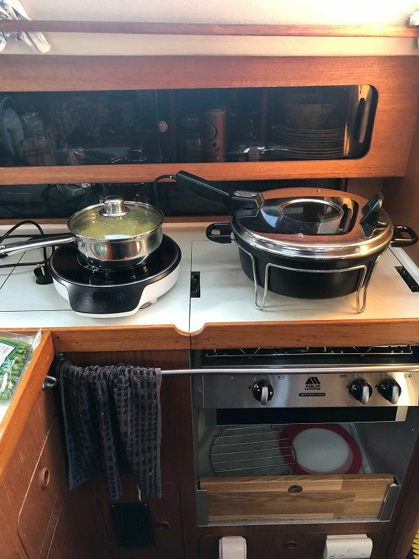

Yes we do lots.  It's a yacht, but many of the ideas from canal boat owners apply to yachts.  During the summer we will either use a yacht club or marina for showers, oh and swimming in the sea 😃
A combination of electric kettle, induction hob and remoska plus occasionally sandwich maker and slow cooker give us all the options we need to cook well on electric.  We didn't plan to go fully electric cooking, merely have the option when Calor became difficult to obtain after the first lockdown.  However, we liked cooking on sunshine so just carried on and expanded the solar from 300w to 600w this past winter.  A bit more Lithium would be nice for the hybrid bank, but 600w of solar should be more than sufficient for all domestic needs like VHF, Chart plotter and auto pilot etc and cooking.  It's hard steering a canal boat hour after hour as we found out on the Langollen, the auto pilot makes light work of the steering.
What's next? water heating by using surplus solar power via the inverter to run the calorifier.  This might need a bit more solar and we could mount another 300w on the yachts life lines.
Life is good.

2 hours ago, Pete7 said:
I like that little induction hob. Which model is it?
I've got one of the Bertelin ones cheap on ebay it works well but this one you have is a nice object.
Edited by magnetman

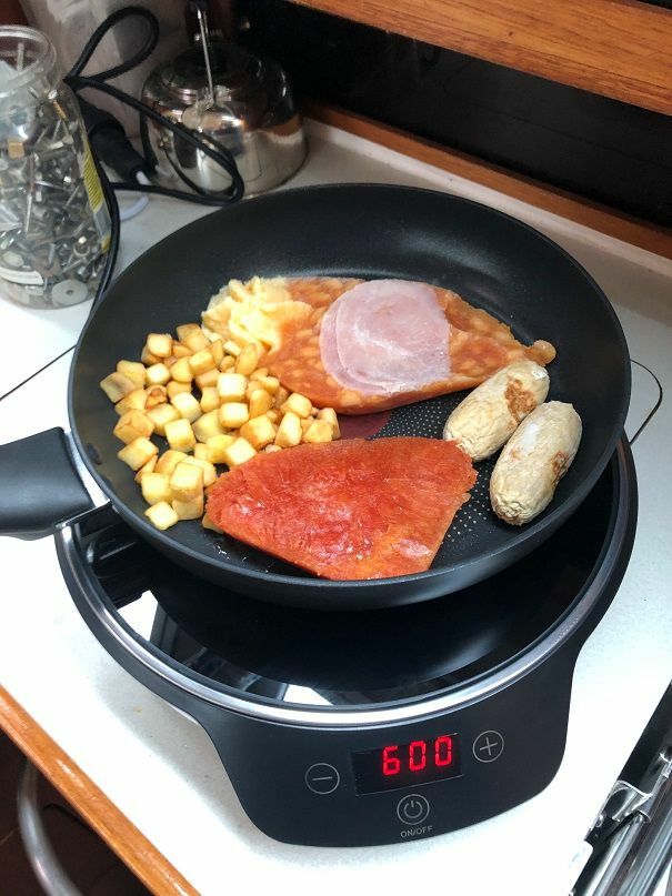

Came from Sterling Power, same folk who make inverters and chargers etc.  Max power is 1500w, but you will just burn stuff at that setting.  We use 200w for simmering pasta and rice once its boiled (use a lid on the pan).  Bacon and steak when seared 600 > 800w.
We have started using 1mm thick silicone mats off Amazon, so the pan doesn't slide on the glass top when another boat goes by.
Pete

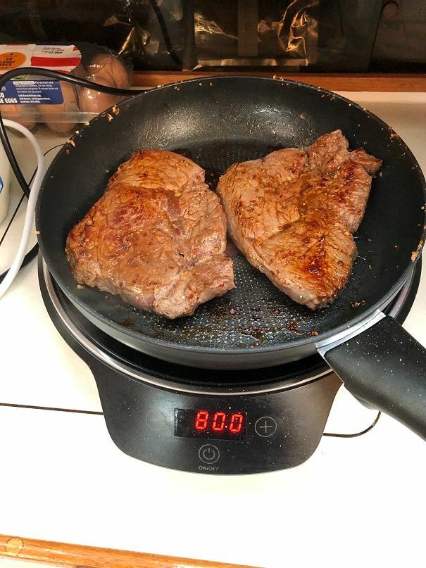

We've been using our little 800W induction hob over the last week using excess solar, its been really good so far.
