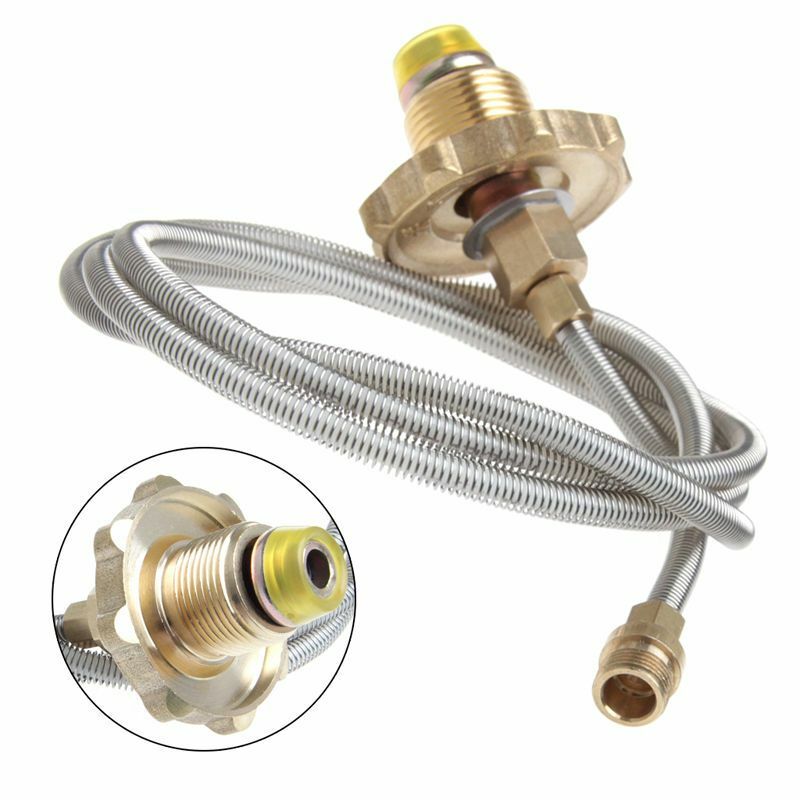

It is quite simple and works out far, far, far, cheaper than buying a 3.9kg refil ever did - however - from memory, in the past you have severely castigated me for explaining how it could be done.
Refilling gas cartridges / cylinders is done frequently by campers and walkers.
For the Propane fills you'll need one of these POL to POL connector and hose. (about £5)
Edited by Alan de Enfield
For the Propane fills you'll need one of these (about £5)
Yeah, but I haven't castrated you at all. Please explain the process. Summit to do with inverting the donor bottle innit.

To get the best transfer you should 'chill' the receiving cylinder (even standing it in a bucket of cold water helps).
Weigh the empty (receiving cylinder) and note weight.
Connect the two cylinders.
Stand donating cylinder inverted so it is higher than the receiving cylinder.
Open both valves so liquid flows from donating to receiving cylinder.
After a couple of minutes, close valves, disconnect and weigh receiving cylinder, note the difference in weight  from empty and extrapolate the time required to get to (say) 3,5 kgs (assuming it is a 3.9kg cylinder)
Reconnect and give it the additional time required.
Re-weigh, it. If has gone above 3.9kgs vent some off.
Underfill rather than over fill.

Presumably one could use a non calor bottle as the donor bottle, assuming the connection couplings are the same?
All (UK) Propane use the POL connectors. Yes you can use any manufacturer - its all the same gas inside.
