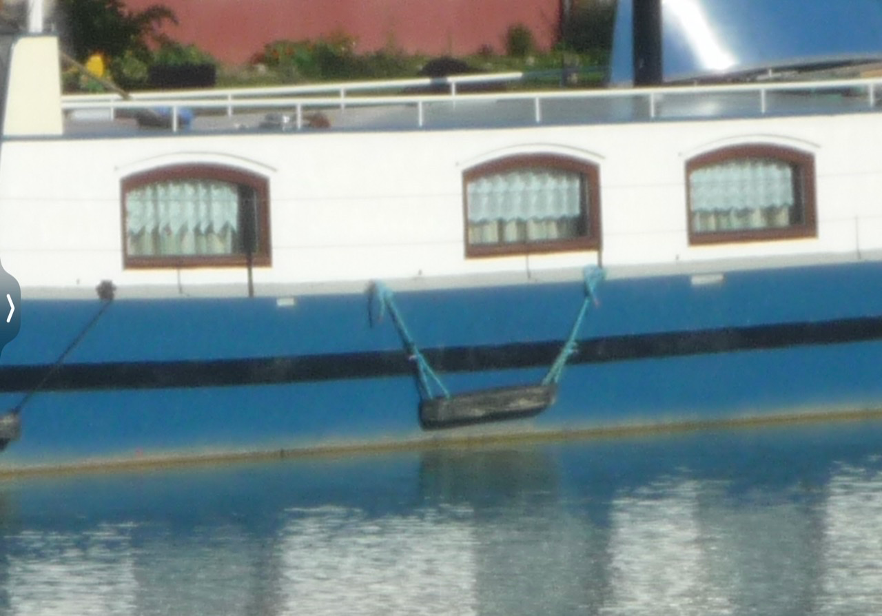

One of my German boatman friends told me that in Germany you were forbidden from using your engine when over the sill so as not to disturb any rubbish which could settle on the sill. Tyres as fenders were also forbidden as they could sink and cause problems with the gates sealing. Wooden fenders, similar to the photo, were used as they would float if they fell in the water. Dorfprozelten is a small village on the River Main which was home to many boatmen, and I was given this as a present when stopping there with another boating family.
That makes a lot of sense
The wooden fenders have mostly been superseded by these rubber fenders which also float but also have some give . They are made from old tyres.
