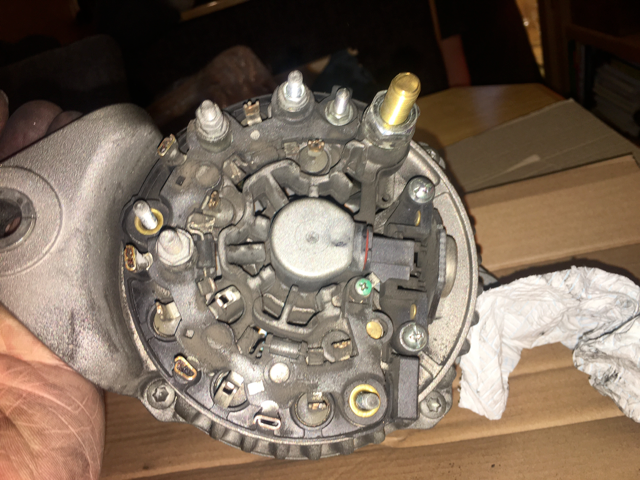

Back of the alternator looks like this, you can see the brush/reg module to the right
Just need to undo the two shiny screws and the little green screw (caution, a spacing conductor is beneath, don't lose it!). Of course yours might be totally different...
Thanks Nick, that's really very helpful indeed. It'll be a bit different on the 150a no doubt, but not vastly so as you say. It does help confirm the reg as a viable way ahead.

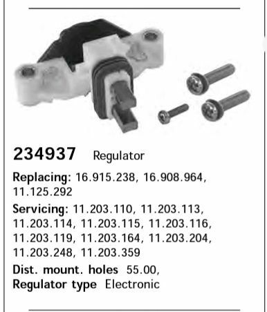

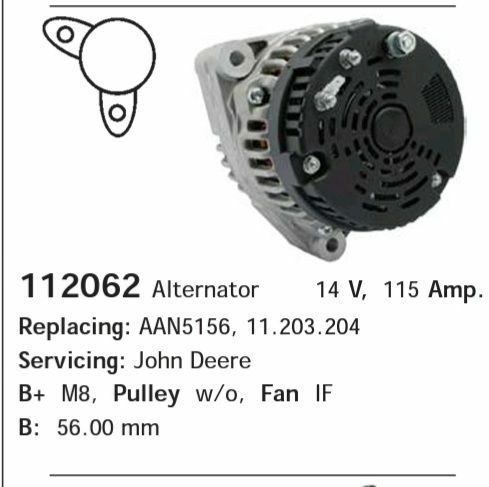

This is what comes up in the Cargo catalogue when you look up the Iskra number 11.203.124.
Thank Steve. I've been finding stuff like that, but noting that it shows a 115a alternator, not the original 150a, I'm inclined to think that whikst it may fit as a replacement assembly, I'm concerned that once it branches off into various component part numbers the match deteriorates. I suspect the right component might be in the maze, but how to find it? That said, if I have the back off, I can see if it matches the photo of 234937. Appreciate your help

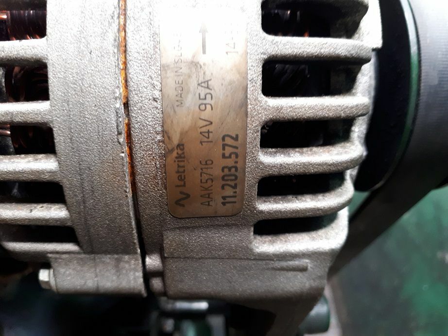

No idea if this is of any help but this is whats on my Beta 43.....
Different alt Rob, but thank you for taking the time to take the photo. How come it's not green!? Maybe a previous owner has has similar fun?
