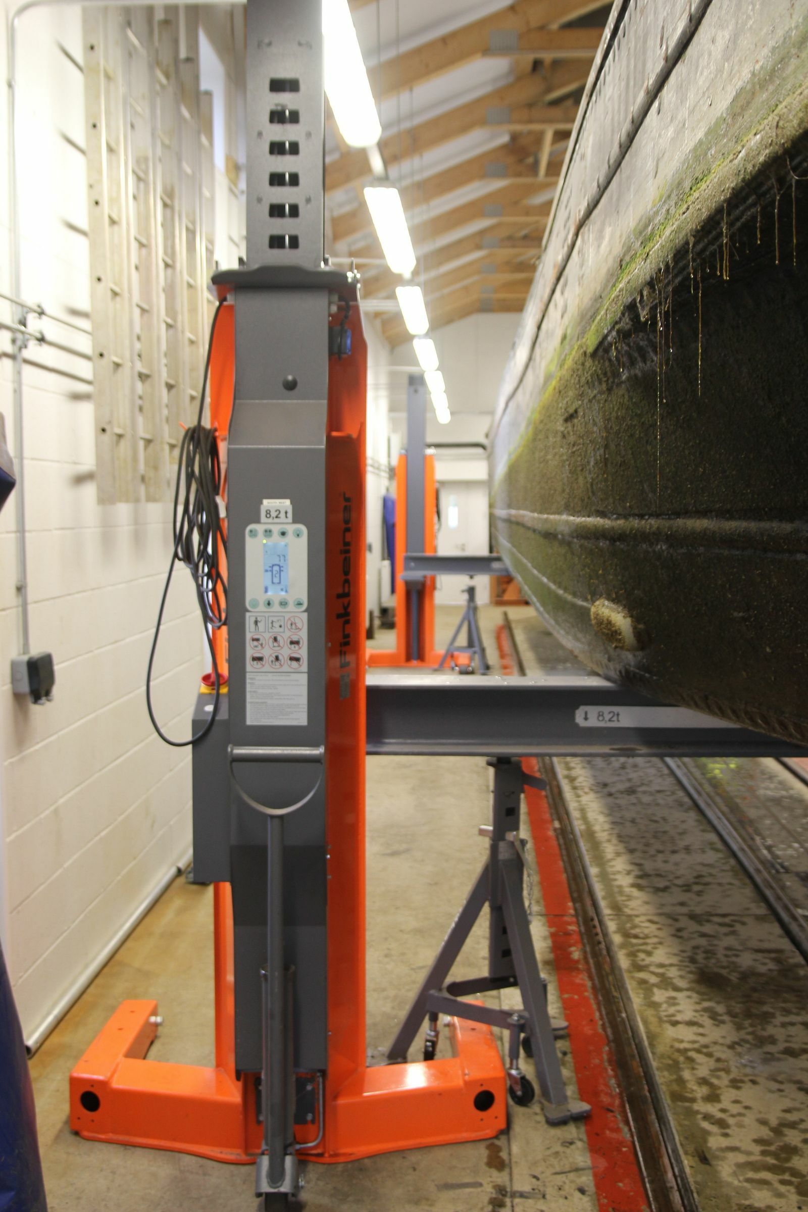

How do they hoist the boat? If this is a permanent enclosed facility they can't use a crane.
not sure David, it's what I was told. I guess a low-load trailer then they use several hydraulic jacks.
They have a fixed hoist which lifts the boat up and sideways onto a rather fancy remote controlled trailer which takes it into the shed. Inside they have a number of mobile lifts like half a car lift  which can lift the boat up above the trailer and you can walk under the boat, the trailer can be removed and the lifts re positioned easily to allow all areas to be worked on and the height easily changed . Makes most yards look very out dated. Roller shutter doors can then be closed.
There is a similar set at Circus Field in the covered slipway.
Pictures on the ACS website.  The lift columns work with beams that go across under the boat so as to spread the load onto the baseplate  and not rely on the chine corner to spread the load.  The lifts pictured above are really designed to lift a vehicle by its tyres.
N
N
The hoists at Circus Fields
