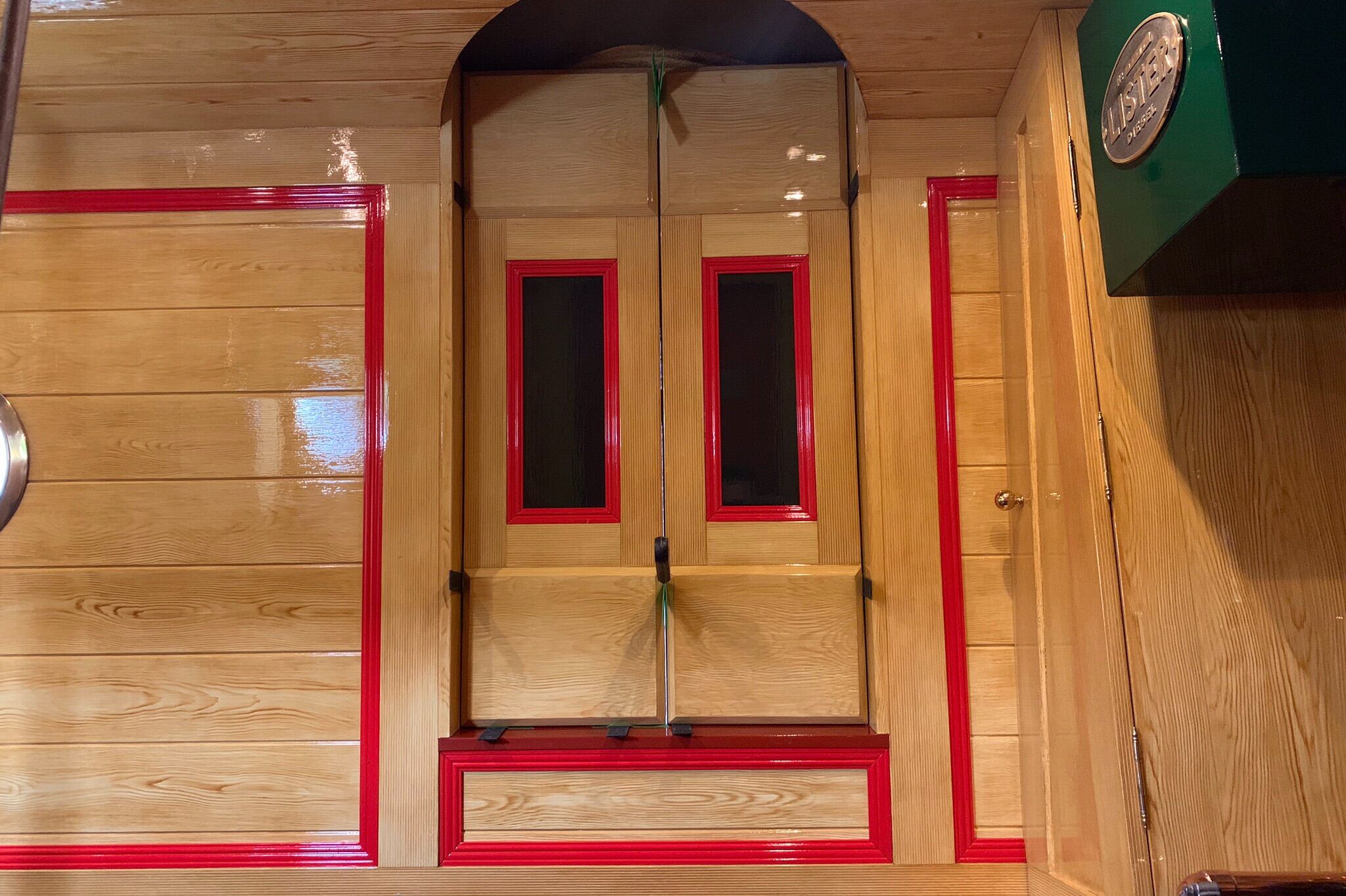

RAP Posted September 30, 2021 Report Posted September 30, 2021 In my back cabin and engine room I used Dulux trade undercoat coloured to 15868 or 66YY80322, which is a pale yellow, with Polyvine medium oak scumble and varnished with Screwfix’s finest No Nonsense yacht varnish. Here’s an example of the results. 4

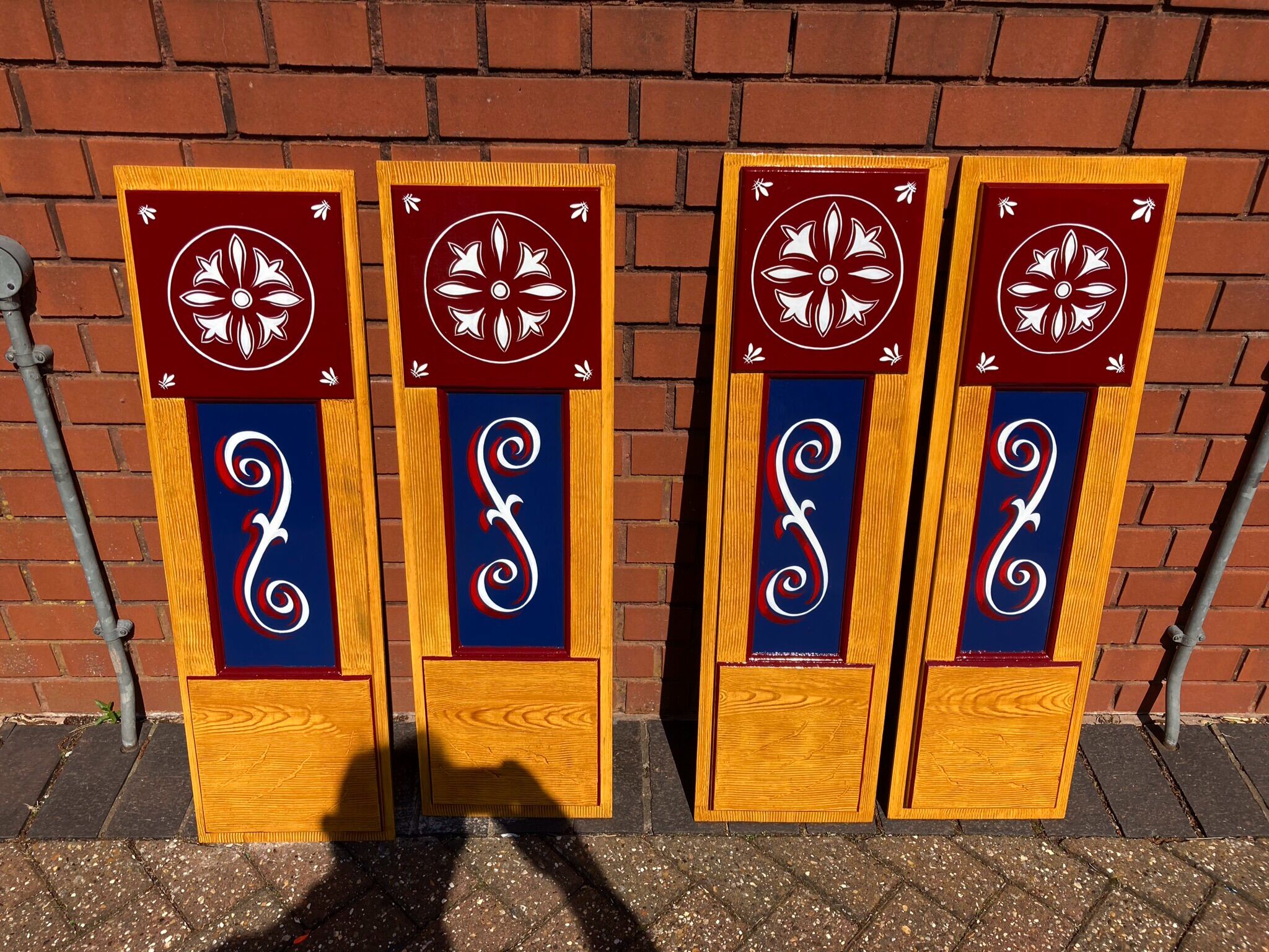

David Schweizer Posted October 1, 2021 Report Posted October 1, 2021 (edited) Dave is correct, repairing scumble is almost impossible, and the only lasting solution is to sand it down and re-paint, which is what I did on Helvetia, I used a canary yellow undercoat (as advisd by the late Ron Hough), grained it with Radcliffes Light Oak Scumble, and varnished it with two coats of Blackfriars Yacht Varnish. I was able to purchase a set of combing irons and graining rubbers on ebay, which are neccessary for a decent effect. Here are the doors finished and ready to take handles etc. The Roses and Castles were painted by Ron Hough :- Edited October 1, 2021 by David Schweizer 1
