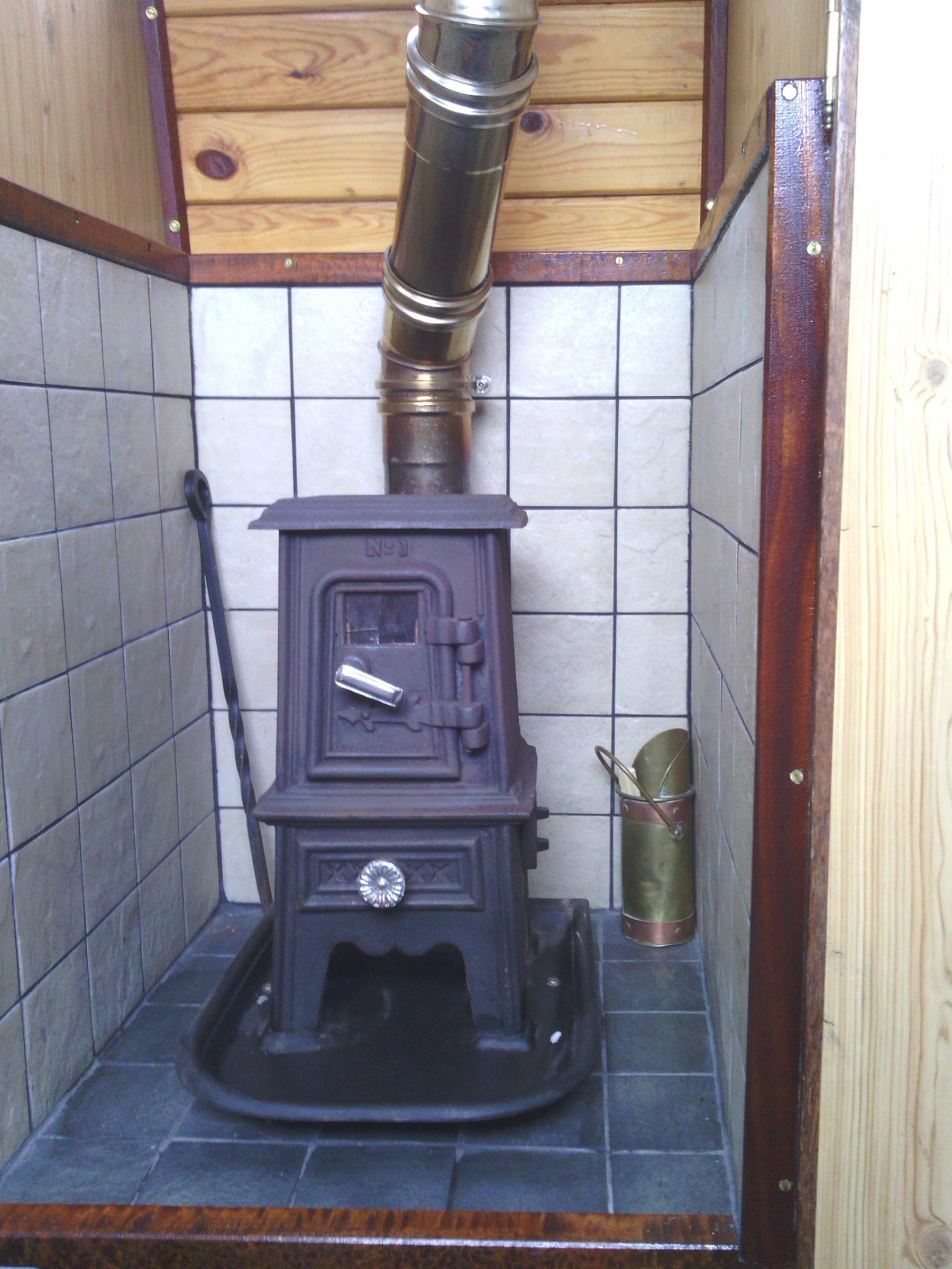

Alan de Enfield Posted July 30, 2021 Report Posted July 30, 2021 (edited) And, a bit smaller than the Hobbit is the 'pipsqueak' and excellent tiny stove from the same stable. Tried an experiment to get our 30' NB as hot as possible, but once we got above 55 degrees C had to give up as we couldn't breathe - Stove 1 : Humans 0   To give an indication of size, the firebox is only 8" square.  More a 'twig burner' than a 'log burner'. Edited July 30, 2021 by Alan de Enfield
