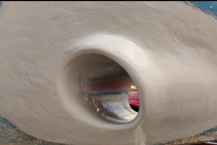

  1. Especially since most narrow boat thruster tubes aren't formed with the correct edge radius where they penetrate the hull. Most tubes also don't terminate perpendicular to the length of the boat, instead terminate to follow the line of the hull. Some even have grills over the ends of the tubes. Between these three, a large proportion of the advertised thrust is lost. The picture is of a thruster tube correctly installed for maximum thrust on a grp boat, but I've seen similar work done on a steel replica Dutch barge.
