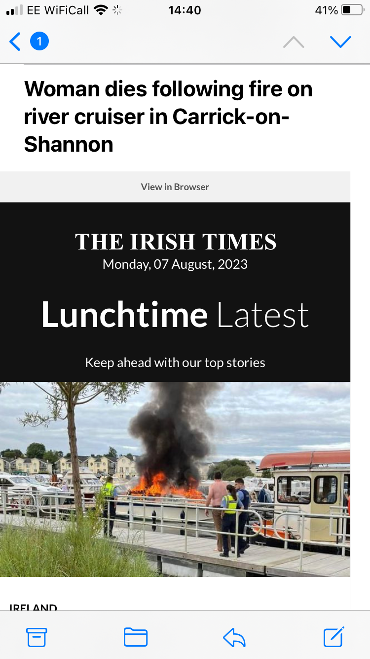

  23. Horrible incident on the river Shannon in county Leitrim in northwest of Ireland. Police not releasing much detail yet
