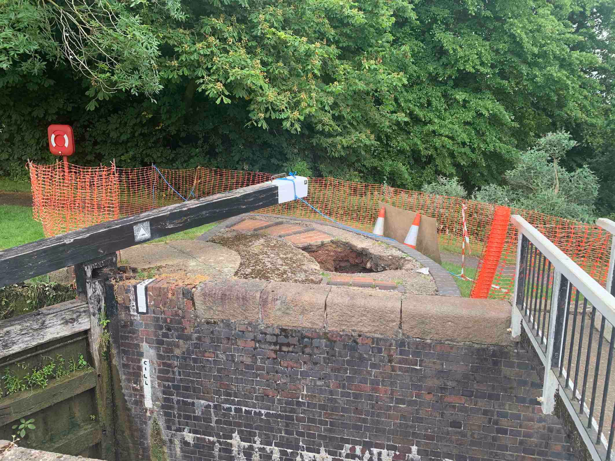

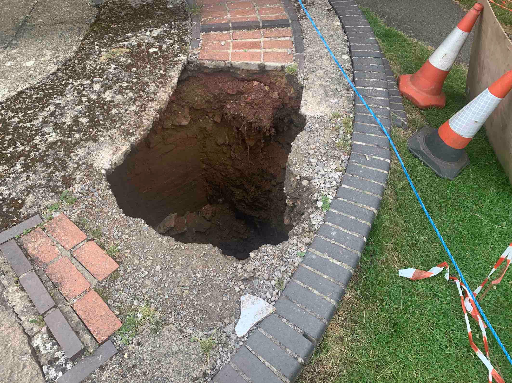

Heres some pictures of the hole....according to the Lockies its about 15ft deep and tunnels under towards the towpath....the  lock wall at present is not bowing and boats are still transiting the lock...however the lockies are thinking it might be shut once a detailed inspection has taken place and a repair plan worked out. Top marks to be fair with the rope etc keeping the navigation open. Apparently there is water running at the bottom of the hole....I didn't fancy getting closer and finding another weak point!

Wow, that's some sink hole! Just as well no one was moving the lock gate when it collapsed.
That has been washing away soil for months,may be years,with material from the top of the cavern falling into the void and (presumably) being washed through the brickwork into the lower pound. Eventually there is too little material to support the paving and down it goes. Could easily have happened with the additional weight of someone on top, so fortunate that does not seem to have been the case.
If the water and washed out soil is entering the canal below water level there would have been no sign what was happening - nothing to see in a routine inspection, and no preemptive action possible. One of the hazards of maintaining aging infrastructure!

It may not be easy to find and stop the source of the water that has been washing the soil away, probably for some time.
CRT are going to look into it...
And how many times do you see water leaking through the brick joints of the wing walls near the bottom gates of locks?
Well this is what is likely to be  happening every time.

I have to say unusually there wasn’t any obvious leaks here…I think it’s been going into the field or out under water.
