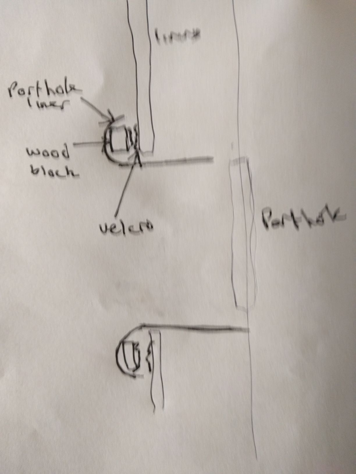

Recollection hazy now havent seen the boat for 9 months but when we used the velcro we had to glue wooden blocks to the porthole to fill the gap I don't recollect any issues here , with either the wood sticking to the porthole or the velcro to the wood the actual problem was sticking the velcro to the boat lining which had a vinyl covering. I think we probably used polyurthene glue for the wood.
So sort of like this? Tried that, fell off! (See photo below)

yes thats it, dont recall them falling off it should certainly be possible to stick wood to fibreglass, then just the self adhesive velcro, as I said it was the vinyl covered cabin wall that was our weak point the velcro never stuck to it well.
