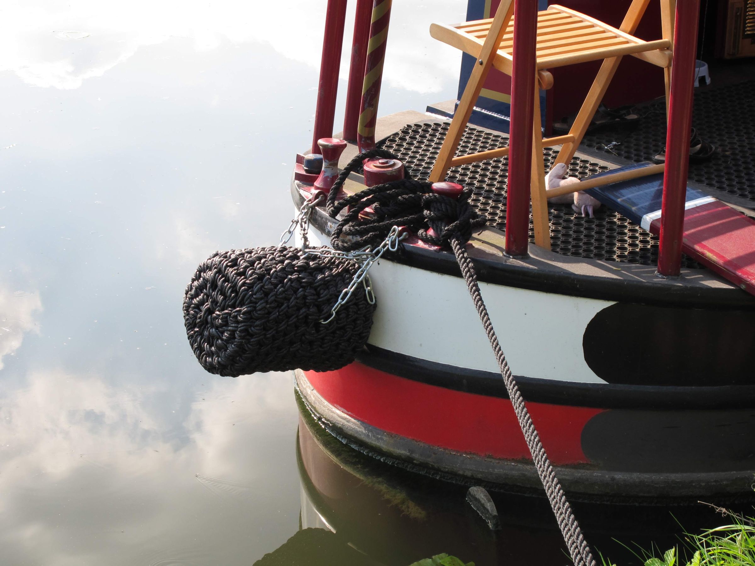

JoshS Posted January 20, 2021 Report Posted January 20, 2021 (edited) https://i.imgur.com/c3wLWIf.jpg We're pondering the idea of removing the suicide seats from our newish-to-us boat. We know not to use them for sitting on whilst steering, and they're definitely a hindrance to us when jumping on and off the boat with a centre line whilst mooring etc. But we're not sure if we'd miss them as a sort of handrail, something to grab onto and the fact they provide a bit of protection from falling off the back of the boat. What's everyone's opinion? Also, if we do decide to remove them, what's the best way to fill in the bolt holes? Edited January 20, 2021 by JoshS

Hudds Lad Posted January 20, 2021 Report Posted January 20, 2021 as a compromise you could remove the most forward pole from each seat and make new tops so more sort of T shaped than current Π shape, that would give you better entry/exit and still leave a seat. 1
JoshS Posted January 20, 2021 Author Report Posted January 20, 2021 4 minutes ago, Hudds Lad said: as a compromise you could remove the most forward pole from each seat and make new tops so more sort of T shaped than current Π shape, that would give you better entry/exit and still leave a seat. That's a cool idea! Will definitely give this some thought!

Tracy D'arth Posted January 20, 2021 Report Posted January 20, 2021 Dump them, fill the holes with coach bolts with rounded heads. Deck chairs are for sitting out on summer evenings. 1

magpie patrick Posted January 20, 2021 Report Posted January 20, 2021 I was going to remove them on Ripple, then I saw that my parents steadied themselves getting on and off when moored using the seats as a handrail So I settled for a rule of no one sitting on them when under way

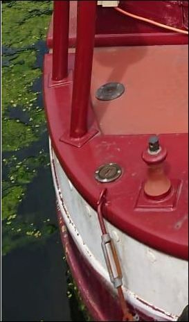

Ray T Posted January 20, 2021 Report Posted January 20, 2021 (edited) Slightly off topic. Are either of these two your diesel tank fillers? If so I believe they should have collar around them to stop diesel being spilled on the deck and possibly entering the boat. fuel filling systems | Boat Safety Scheme | Go Boating - Stay Safe FAQ TN 0X1 (boatsafetyscheme.org) May be a BSS fail? I stand correction. Edited January 20, 2021 by Ray T
Rob-M Posted January 20, 2021 Report Posted January 20, 2021 We had ours cut off, got it done at the same time as a repaint so no traces left.
Jen-in-Wellies Posted January 20, 2021 Report Posted January 20, 2021 40 minutes ago, Ray T said: Slightly off topic. Are either of these two your diesel tank fillers? If so I believe they should have collar around them to stop diesel being spilled on the deck and possibly entering the boat. fuel filling systems | Boat Safety Scheme | Go Boating - Stay Safe FAQ TN 0X1 (boatsafetyscheme.org) May be a BSS fail? I stand correction. The BSS says: Fuel overflowing from filling points must be prevented from entering any part of the interior of the vessel. Accordingly, fuel filling points must be positioned so that... the camber or configuration of the deck; or, a coaming; or, a diverter arrangement; ...causes any overflow to discharge overboard; On my boat, the filling point is incorporated in to one of the two towing/mooring dollies. There is no coaming around it, but the design is such that any spillage will be confined to the deck, with an upstand that prevents it reaching the engine cover, so is covered by "the camber, or configuration of the deck". The top picture looks similar in construction to mine, the upstand by the doors and the scupper each side will send any excess diesel overboard. On your lower picture, I can see a couple of what look like hinges for a lifting panel. As a result, that boat needs the coaming around the filler to prevent any spills going there. BSS isn't concerned about people slipping over on a diesel spill on the deck. Jen
JoshS Posted January 20, 2021 Author Report Posted January 20, 2021 Yep, there is a decent lip up to the stern doors and the recessed part of the deck is cambered and without an inspection hatch (which makes the weed hatch a hilarious contortionist act to access but with the benefit of a basically rust free engine bay).

Jen-in-Wellies Posted January 20, 2021 Report Posted January 20, 2021 If you are lucky, then the bolt holes in to the deck will be tapped, rather than drilled to clear the bolts. In which case, a bit of thread lock on the bolts, grind off flush with the deck and paint. If there is access to the underside, then a nut and washer on each side will lock the stud in place. Jen
