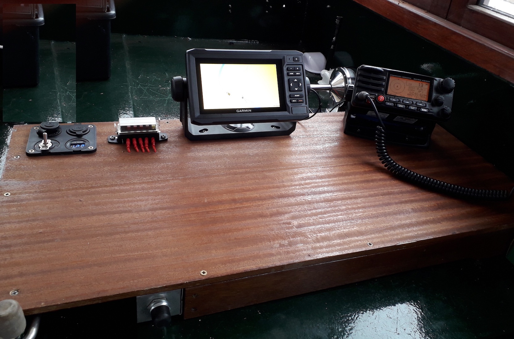

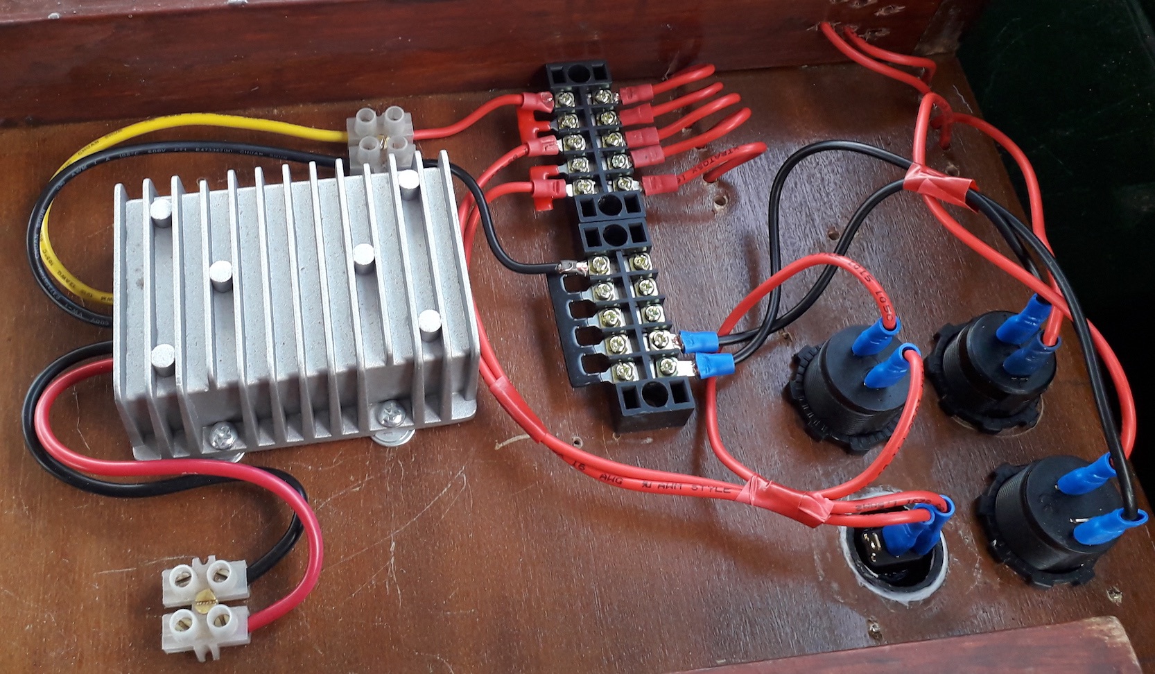

Trevor Lyons Posted June 6, 2021 Report Posted June 6, 2021 I've recently completed a "nav panel" in my wheelhouse comprising a number of 12v item: * GPS Chartplotter, * DSC/AIS VHF transceiver, * Horn * a 4-element console with digital voltmeter, cigar-lighter sockets and 2 USB ports. All items are individually fused, and the circuit has a dual pole switch (top left) to isolate the panel. Power is supplied via a previously unused 24v cable marked fed from the main consumer unit. The 24v current is converted to 12v using a solid-state converter. I am glad to say my wiring was faultless and everything works fine; but every third time or so when I turn the isolation switch, it trips the consumer unit. When I flick it back on, all is well. I presume that the occasional tripping may be due to a power surge or spike when the system is powered up. Is it possible to modify the circuit with a diode or capacitor or similar to smooth out the spike? It's only a minor irritation, and once powered up, all seems to be well, but I wouldn't want the system to trip at a vital moment. (The photo of the wiring underneath was taken before I fitted the horn button and the isolation switch). Any ideas, please?
Jen-in-Wellies Posted June 6, 2021 Report Posted June 6, 2021 (edited) Is this a mains domestic style RCD that is being used at 24V? If so, they aren't expensive, so worth replacing it with one of equal trip current. See if that solves the problem. How close are the combined currents of all the bits of kit to the rated trip current? Can you measure it? Do you have a clamp meter? Could be an inrush current, but I don't see a big inductive load in the list of items you gave. Your wiring is neater than mine! Jen Edited June 6, 2021 by Jen-in-Wellies 1
Trevor Lyons Posted June 6, 2021 Report Posted June 6, 2021 1 minute ago, Jen-in-Wellies said: Is this a mains domestic style RCD that is being used at 24V? If so, they aren't expensive, so worth replacing it with one of equal trip current. See if that solves the problem. How close are the combined currents of all the bits of kit to the rated trip current? Can you measure it? Do you have a clamp meter? Could be an inrush current, but I don't see a big inductive load in the list of items you gave. I shall investigate the first point, but the tripping is not due to any short circuit. (The central fuse panel was installed before I bought the boat. it's possible it's a 240v unit). The maximum amperage of the converter is about 15A, but even using the horn and the radio at 25W would still be consuming less than 15A, I reckon. Thanks for your contribution.
Tony Brooks Posted June 6, 2021 Report Posted June 6, 2021 I agree not much sign of an inductive load but what about inrush current into capacitors? 1
Alan de Enfield Posted June 6, 2021 Report Posted June 6, 2021 Is that a fuse box (with torpedo porcelain fuses) between the plotter and the cigarette lighter sockets. If so, they are terribly unreliable, ideally replace it with a more modern fuse system. If not - ignore the suggestion. 1
matty40s Posted June 6, 2021 Report Posted June 6, 2021 47 minutes ago, Alan de Enfield said: Is that a fuse box (with torpedo porcelain fuses) between the plotter and the cigarette lighter sockets. If so, they are terribly unreliable, ideally replace it with a more modern fuse system. If not - ignore the suggestion. Look like blade fuses to.me.
Jen-in-Wellies Posted June 6, 2021 Report Posted June 6, 2021 1 hour ago, Tony Brooks said: I agree not much sign of an inductive load but what about inrush current into capacitors? Yes, that is possible. Perhaps there to smooth the output of the DC-DC converter, as well as in other bits of kit. If it is an RCD that is tripping, then using a slow blow fuse of the same continuous current rating instead would get round this, while still protecting the wiring from faults.
Chewbacka Posted June 6, 2021 Report Posted June 6, 2021 45 minutes ago, Jen-in-Wellies said: Yes, that is possible. Perhaps there to smooth the output of the DC-DC converter, as well as in other bits of kit. If it is an RCD that is tripping, then using a slow blow fuse of the same continuous current rating instead would get round this, while still protecting the wiring from faults. Some D.C. converters have a large in-rush current, I would use a fuse/circuit breaker that is 150% of full load current to avoid nuisance fails - this assumes the wiring is safe at 150% of full load
Guest Posted June 6, 2021 Report Posted June 6, 2021 4 hours ago, Trevor Lyons said: I've recently completed a "nav panel" in my wheelhouse comprising a number of 12v item: * GPS Chartplotter, * DSC/AIS VHF transceiver, * Horn * a 4-element console with digital voltmeter, cigar-lighter sockets and 2 USB ports. All items are individually fused, and the circuit has a dual pole switch (top left) to isolate the panel. Power is supplied via a previously unused 24v cable marked fed from the main consumer unit. The 24v current is converted to 12v using a solid-state converter. I am glad to say my wiring was faultless and everything works fine; but every third time or so when I turn the isolation switch, it trips the consumer unit. When I flick it back on, all is well. I presume that the occasional tripping may be due to a power surge or spike when the system is powered up. Is it possible to modify the circuit with a diode or capacitor or similar to smooth out the spike? It's only a minor irritation, and once powered up, all seems to be well, but I wouldn't want the system to trip at a vital moment. (The photo of the wiring underneath was taken before I fitted the horn button and the isolation switch). Any ideas, please? I have the same setup on my boat with no issues at all, I think my unit is a 30 amp unit and I have had it for at least 3 years ish. The unit has a DC mcb to switch it off and my 12 volt consumer unit is a modern one. My fridge is the only item that runs on 24 volts and has a separate MCB on it. Sorry I am no help but my setup works great so should yours

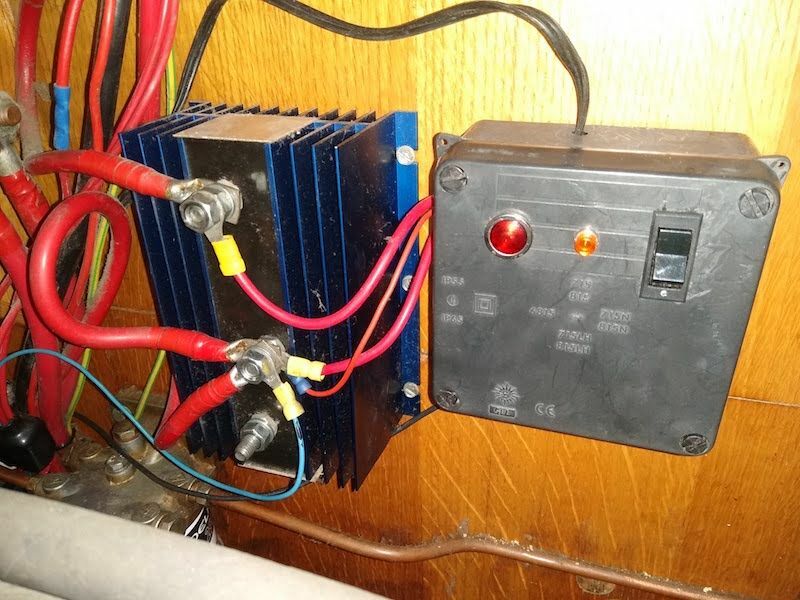

davidb Posted July 28, 2022 Report Posted July 28, 2022 42 minutes ago, Tony Brooks said: Why do you think it is not working properly and do you know about positive and negative rotor control? Because the alternator voltage is being reduced by the diode and the Adverc is not compensating for it, even when the sense wire is connected on the battery side of the diode. "do you know about positive and negative rotor control?" Obviously not, maybe the new alternator I got last year was modified wrongly?
nicknorman Posted July 28, 2022 Report Posted July 28, 2022 23 minutes ago, dmr said: Much too complicated and you would have to keep adjusting this voltage as any loads changed, and do this quickly, making yourself a sort of human voltage regulator. Top priority...Get the Adverc working. This is what I have done..... There is a preset (twidler) voltage adjudment inside the Adverc. With a bit of careful but easier solderring I have replaced this with a twenty turn preset with the screwdriver adjustment accessible from outside the Adverc box. I use a Smartgage to monitor the voltage but anything would do. Turn it up to 15.5 to equalise and remember to turn it back down afterwards (14.8 for Trojans). Its a bit more complicated because the Adverc does voltage cycles so you have to work out which voltage it is at before making the adjustment. Also the Adverc sometimes has a long rest cycle which is a right pain when equalising. Another option might be to use a solar controller, the Victron stuff is very adjustable. However in the real world you need quite a lot of amps to equalise, waiting for a 1% tail current is not viable, and older batteeries never get close to 1% anyway. Or, use a mains charge if you ever have access to shore power and again the Victron stuff is really good, do all the settings from your phone on a nice easy to read screen. and yes, Trojans are really good. Lithiums are really really good but are often compared to cheapo lead acids, when compared to Trojans they still win but its not a walkover. Jeez are people really still using lead acid/Trojans. Absolute pants compared to Li. Trust me, I’m a doctor/pilot/someone who has moved on from Trojans and now has Li (delete as appropriate).
