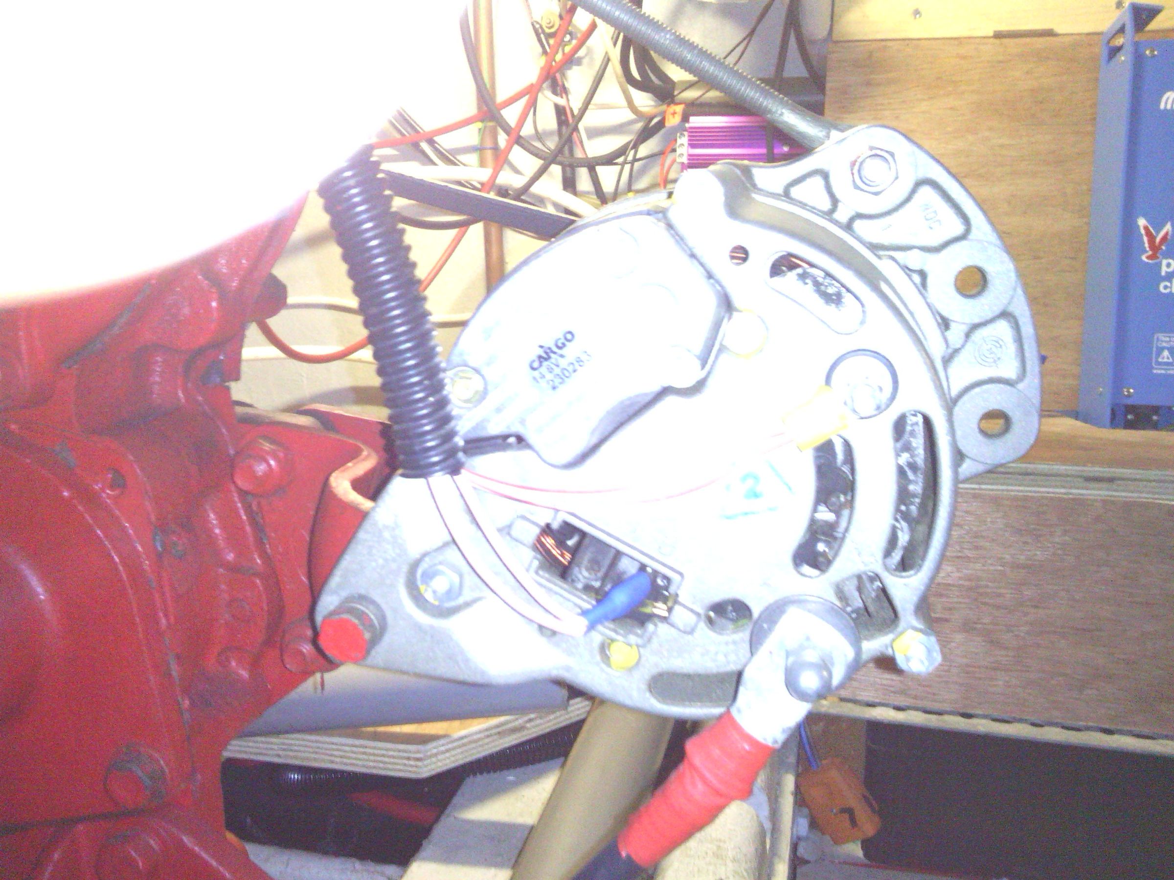

nicknorman Posted December 28, 2020 Report Posted December 28, 2020 42 minutes ago, Alan de Enfield said: Is 14.6v getter any better ? Both of my alternators are 14.6v The point is that it is not so much about the voltage the alternator finally manages to stagger up to once the batteries are hardly taking any current, it is about the ability for the alternator to supply a good voltage AND a good current at the same time - this affecting the mid-charge situation which is of course the situation that prevails for most of the time.
Tony Brooks Posted December 28, 2020 Report Posted December 28, 2020 22 minutes ago, dmr said: Soldering diodes inside an alternator does not appeal to me at all, I think Gibbo just said this as part of his anti-controller rant. First he said the voltage is already ok, then he contradicts himself by saying use a diode to increase the voltage. I think he just had a big downer on Adverc. A diode can only increase voltage in steps of 0.6volts (or is it 0.7 or is it temperature dependent ?.) So if my alternator is 14.4 volts and I need 14.8 then the diode mod only gives the option of 15volts???? Its very easy to investigate this stuff if you have an Adverc as you can unplug the cable harness whilst the engine is running and instantly see the substantial change in charge current. The only drawback of an alternator controller is that it make the alternator run a lot hotter (so it must be doing something). ...............Dave Providing its not on one of its 10 to 20 minute "rest" period running on the alternator regulator. You may have modified your alternator to leave all regulation to the Adverk but that is not the typical installation. Just because you can see more amps on the ammeter does not mean its all going into chemical change, some may well be wasted in gassing and more in heating the battery. I suspect @nicknorman's modified regulator that does not start regulating voltage too early in the charge may do almost as well as an Adverk. By the way if 14.8 volts is vital you could fit a lower voltage regulator plus diode. The Adverc will not do the regulation as defined by the OP at the start of his topic but other make seem more flexible.
