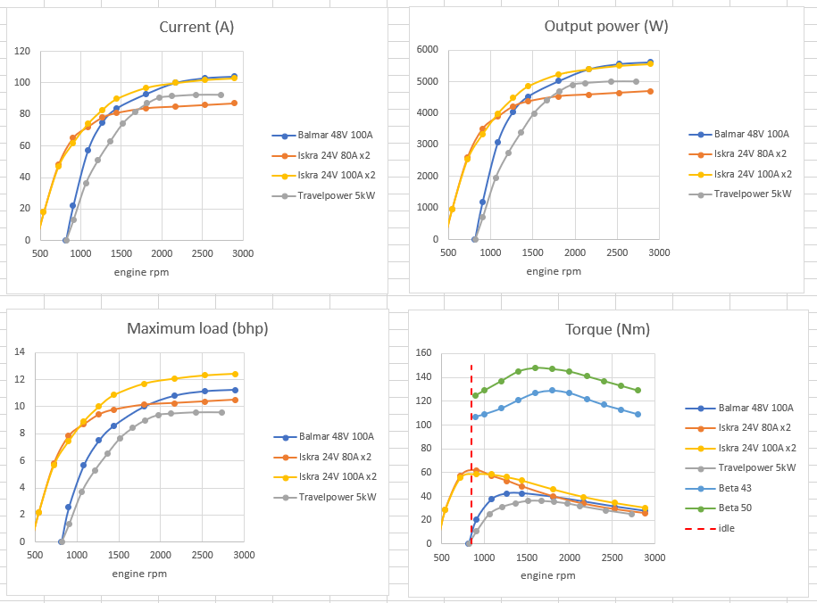

With those power levels you might be better going for a 24V (or even 48V) house system; according to Beta Marine it's possible to fit 2 24V 100A alternators to the Beta 50 (with brush boxes and an external alternator controller) which will generate 5kW together with a Victron Multiplus II (24V/3000 or 48V/5000), and this would cost much less than a Travelpower.
It would also mean you don't need to run the engine for hours when under heavy power load. Output at charging rpm is higher than even the Travelpower 5kW (see attached plots) so you can run at lower rpm, you could charge your proposed 5kWh LiFePO4 bank from 20% to 100% in less than an hour at 1200rpm (good for neighbours).
This would give you higher peak power (if you need it) and also be much more flexible if you want to draw power from onshore and add in onboard for higher power draw. Don't forget that you can't use the Travelpower and Multiplus you suggested (or incoming mains) together to generate AC power, the Travelpower puts out 115V AC on live and the opposite phase on neutral, both Multiplus and mains put 230V on live and 0V on neutral, so can't be connected together for obvious reasons...

True, and the dual 24V 100A alternator solution is also OK with this. However note that an intelligent alternator controller (Wakespeed WS500?) is needed to stop the alternators bogging down the engine at idle (would otherwise absorb 7hp!), this can pull back the alternator current at low revs to reduce engine load, as well as sensing battery and alternator temperatures to get the charging voltages exactly right and prevent the alternators being cooked.
As well as properly stopping charging for LiFePO4 at 100% (like the manufacturers say), this is also capable of properly terminating lead-acid charging using current measurement (e.g. bulk==>float transition when current is 2% of capacity) instead of just a crude timer, which is much closer to what is needed to maximise lead-acid battery life to anything close to the claimed number of cycles.
Tony makes some very valid points about reliability/diagnosis of these bus systems -- however it should also be pointed out that they're really the only way of making everything work together while protecting big expensive battery banks (especially LiFePO4) and maximising their life with proper charge control (mains, alternator, solar) in a high-power electrical system.
The old simple systems work but have longer charging times (sometimes with cooked alternators) and reduced battery life; not a problem with a couple of small house batteries, but not a good idea if the battery bank costs several thousand quid...
Its not the charging system that worries me. When that goes wrong its so vital and so complicated a Victron engineer will almost certainly be needed. Its adding the tank  level gauges and no doubt in time other system to it like entertainment and lightning circuits that I think may not be such a good idea.
