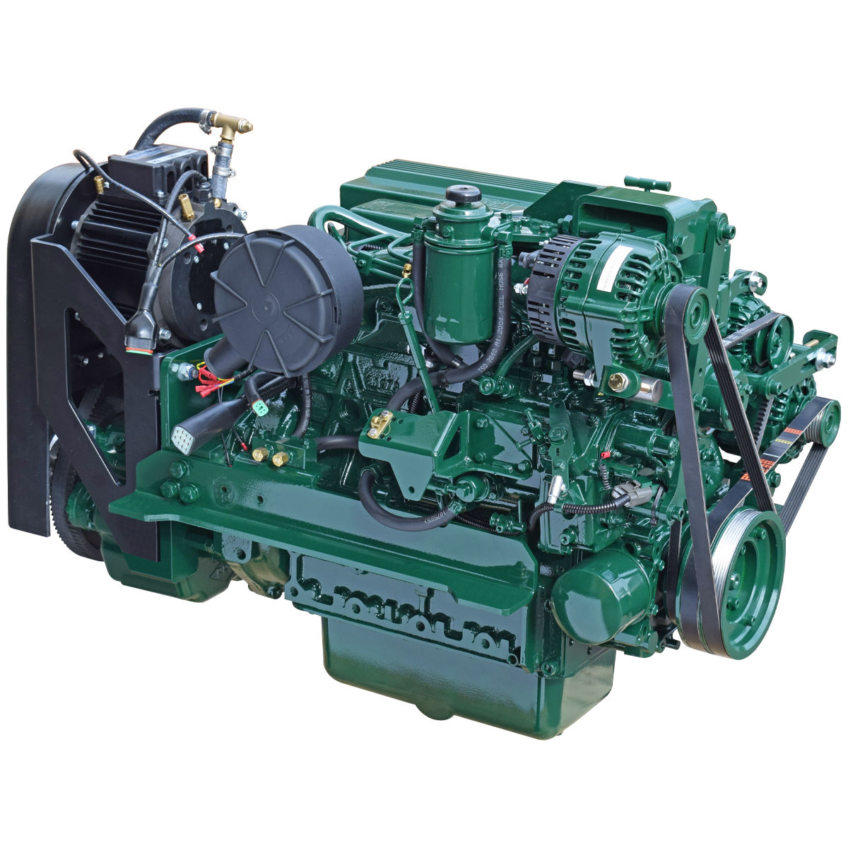

1 hour ago, IanD said:
My evidence is that I've actually spoken to Tim Watts at Beta about it ?
The list you showed (and various pictures, see the hybrid setup here) show 2 extra alternators, in the list they're 80A/24V in lieu of standard *plus* 100A/24V port side mounted, these are not exclusive, they can be fitted together (each with their own belt). And Beta don't care exactly which alternator is fitted, they're all physically the same Iskra case, 2 the same or different is no problem (12V/175A or 24V/80A or 24V/100A). Cost with the brush boxes fitted (to allow external regulator) is £670+VAT for dual 24V/100A (80A are not available with isolated ground, only 100A).
Ok I’ll give you that, in the text of the page I showed it does say that they will custom fit whatever you want (within reason). However I still maintain that you are sacrificing redundancy to get less overall power. 175 x 12 = 2.1kw, plus 3.5kw = 5.6kw, vs 100 x 24 x 2 = 4.8kw. Cheaper? Yes. Better? No.
And then you have the hassle of having to source 24v equipment and or providing some step down to 12v, when the vast majority of inland boat stuff is 12v.
Any 12V stuff (not high-power) runs off the 12V battery, with a 24-12V or 48V-12V or 230Vac-12V charger keeping it topped up from the house bank. The 24V/48V house bank is only used as an energy reservoir for the inverter, with charging either from shoreline (via the combi) or alternators (with external regulator) or solar (via MPPT), there's no 24V equipment on the boat, only 12V (low power) and 230V (high power). It's the way the hybrid boats work, except without an electric motor.
If you value redundancy above all else then by all means stick to your alternator/TP combo and run the engine faster when you want to charge the batteries.
P.S. You were right, a TravelPower can be used as the AC mains input to a combo inverter/charger (with some added bits) -- I got my wires crossed ?
Edited by IanD

34 minutes ago, IanD said:
Wakespeed WS-500 or American Power Systems APS-500. Hybrid Marine have used both suppliers (maybe not this exact part?) in non-narrowboat applications. They also said the Iskra 24V/100A alternators have proved very reliable when charging large battery banks -- presumably controlled from their hybrid box, I wouldn't be surprised if this also uses battery/alternator temperature sensors like the Wakepeed (and Balmar) regulators do. Wakespeed told me they have hundreds of WS-500 systems installed (not in narrowboats!) using high-power alternators to charge big battery banks, mostly LiFePO4 in yachts -- we're talking single large-frame alternators up to 24V/400A here...
This whole system is pretty much the Hybrid Marine one but without the hybrid drive and with the external alternator regulator instead, this has all been proved in the field -- or on the water, to be more precise... ?
This is very much what is becoming common nowadays in new-build lumpy-water boats (where decent AC power is needed) instead of a TravelPower, like LiFePO4 there's a lot of info on various cruising forums but this hasn't trickled down into the famously conservative (and often skinflint!) narrowboat world yet...
The wakespeed 500 is a good alternator controller but costs about £500 per alternator once you’ve got it into this country. Can’t find a price for the other one but it is presumably similar and in fact the spec and the -500 remarkably similar. Are they in fact the same product under the skin?
Anyway, in your pricing you therefore have to add about £1k for alternator controllers. Which by the way I agree is necessary with Li batteries.
All seems a bit faffy to me. In the graphs you posted in post #13 you did not compare like with like. You had either your 2 Iskra alternators, or one 5kw TP. You did not have one Iskra alternator and one 3.5kw TP which is the configuration we have. Therefore I’m not sure that your graphs show anything useful in the context of this discussion.
I found it interesting they gave engine speed, it would be interesting to know the pulley ratios.
2.7:1 for alternators (180mm crank/65mm alternator -- info from Beta), 3.3:1 for Travelpower (guesstimate based on pulley sizes in photos, look ~20% bigger ratio)
All the kind of stuff that's not easy to find out, neither are the current vs. rpm curves, for some reason manufacturers seem to want to hide this. Maybe because it looks better to say just "100A" or "5kW" without saying that you don't get this until a noisy 2000rpm which is far more than most people charge at...
Edited by IanD
