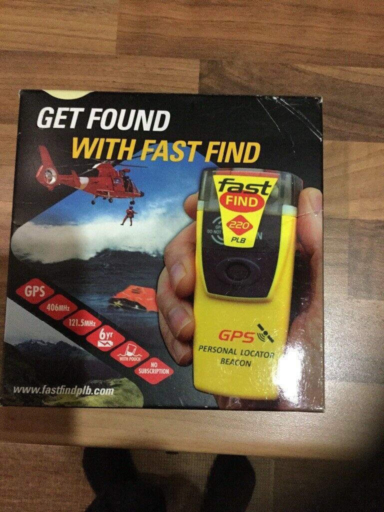

The problem with the system you identify is that after a week your phone battery is flat so no one can find you anyway.
You could always get a PLB (Personal Location Beacon) a one off purchase with no monthly annual fees to pay. Unless it is an 'instant death' you just press a button and the emergency services are contacted, it tells them your name, details of friends or relatives and your location anywhere in the world, to within about 5 metres)
You register it (free of charge), the batteries last about 6 years (and are replaceable) - that's it.
You are maybe familiar with EPIRBS from you boating days, it is a personal version of an EPIRB.
Very small, clip it on your belt of keep it in your pocket - feeling seriously ill ?
Press the button.
Edited by Alan de Enfield
Just now, Quillan said:
Right I have one but I thought you couldn't use it on land/inland?
You cannot use an EPIRB as that is registered to a ship / boat, but a PLB is designed to be used on Land, Sea, or 'air'. They are commonly used by hikers who may be in remote spots, slip and break a leg, and there is no telephone signal to call for help.
I have one for hiking, and SWMBO has one for when  she is horse riding 'in the wilds'.
Mountain rescue teams love them - it makes their job so much easier and puts then at lower risk - rather than combing a mountain in a snow storm they can walk directly to the casualty.

Done a bit of research on the PLB's and think they are brilliant. Perhaps the reason I didn't know they existed for land use was because they are relatively new. Great idea even for hiking on your own which I like to do. I mean for an average cost of £50 a year for peace of mind (batteries last for 5+ years after which you send it back to the factory for new batteries) working on paying a one off £250 and no other costs. One thing I did notice is that for these devices they have to be bought for the specific country in which you would normally use them i.e. the UK and the country code 0044 is burnt into them. They will work internationally of course but seeing as you pick up the bill for the rescue in some counties they need to know where to send it I guess.
