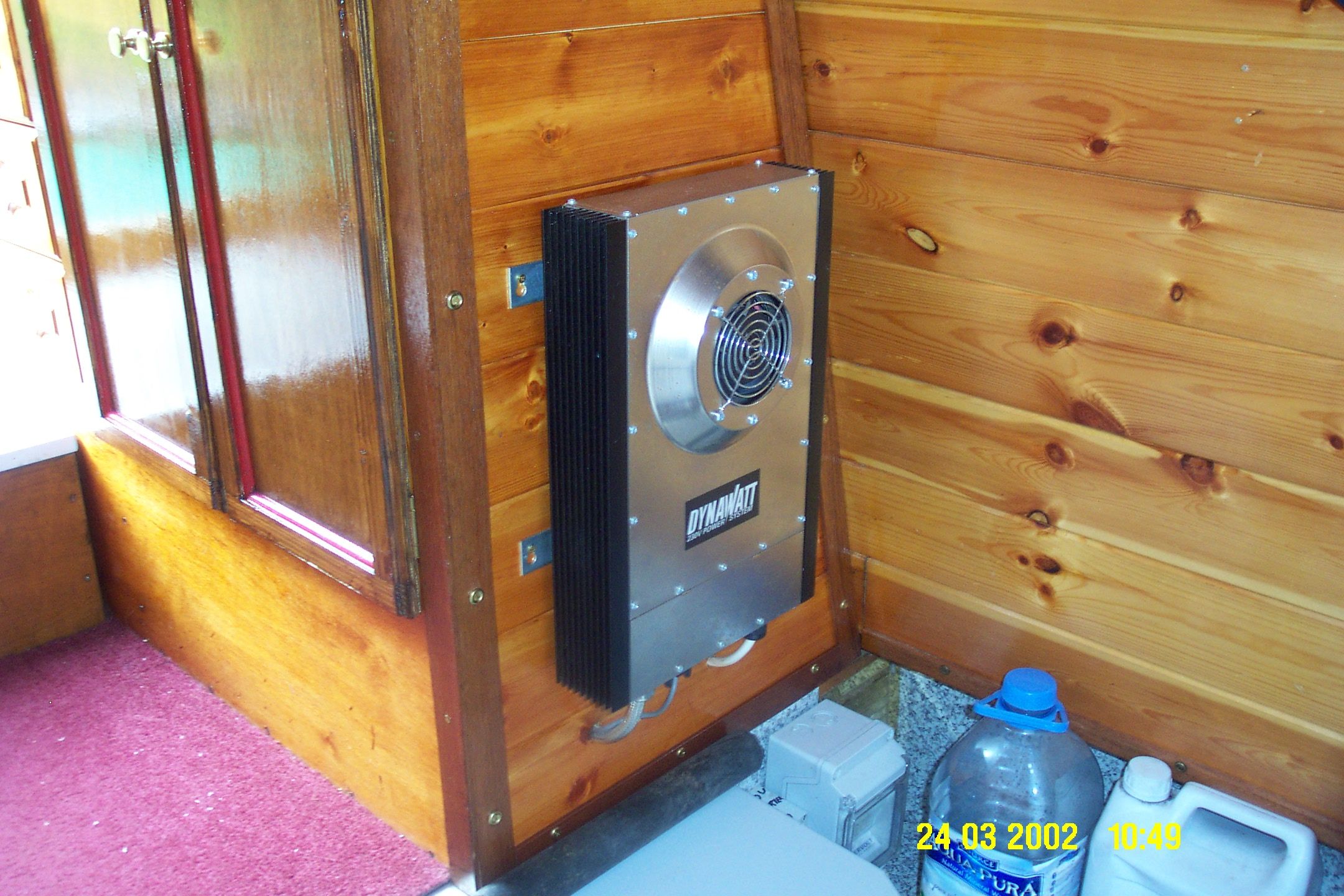

  2. Actually it's a three phase 240v ac alternator. The speed in RPM sets the frequency. I tried to explain but not much good at it so I deleted and added the following link which explains better than I, https://www.sterki.ch/de-wAssets/docs/Downloads/Manual-4-5kW_08.18_engl.pdf

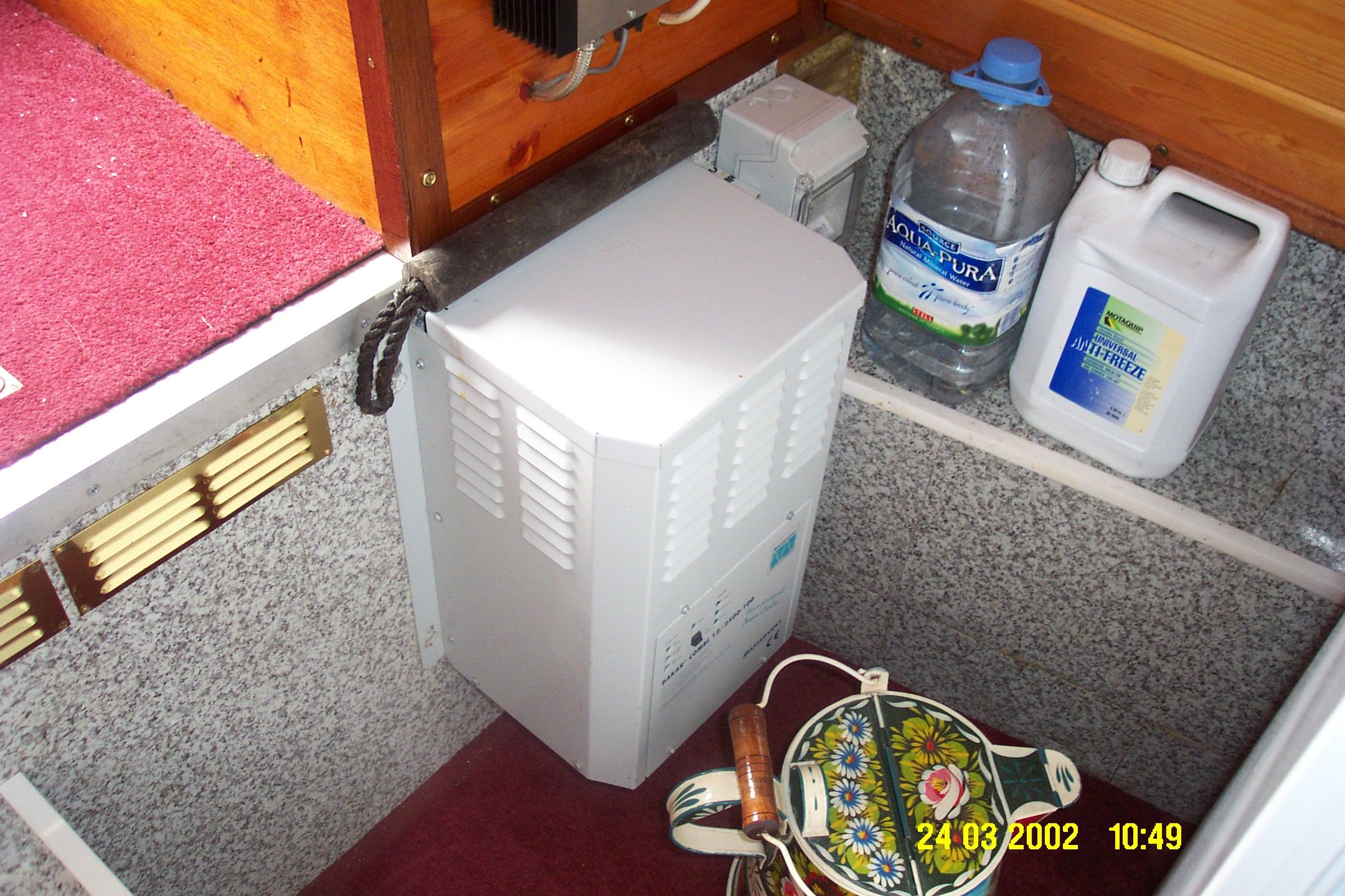

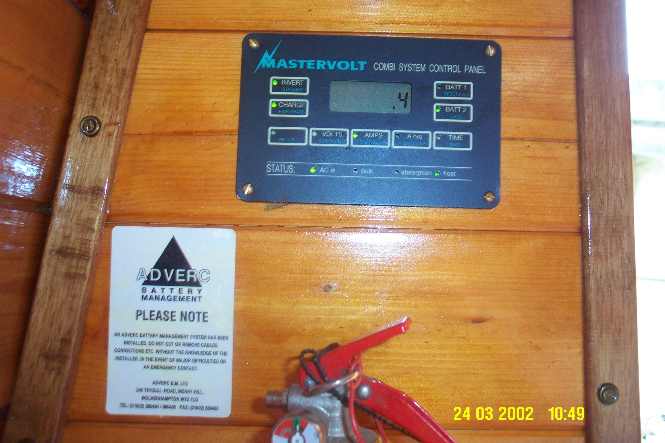

  3. The clever bit is the control box. Below is a photo I have from Merchant in which you can see the Dynawatt controller and the Mastervolt inverter/charger below. New ones are much slimmer. The frequency of the AC is pure sinewave but the kw changes with speed. I think it was at about 2,500 rpm it delivered the whole 3.5kw on a BMC Calcut engine. With a hospital silencer you wold hardly know the engine was running inside and out. This is the control and battery management panel that came with the Mastervolt inverter/charger.
