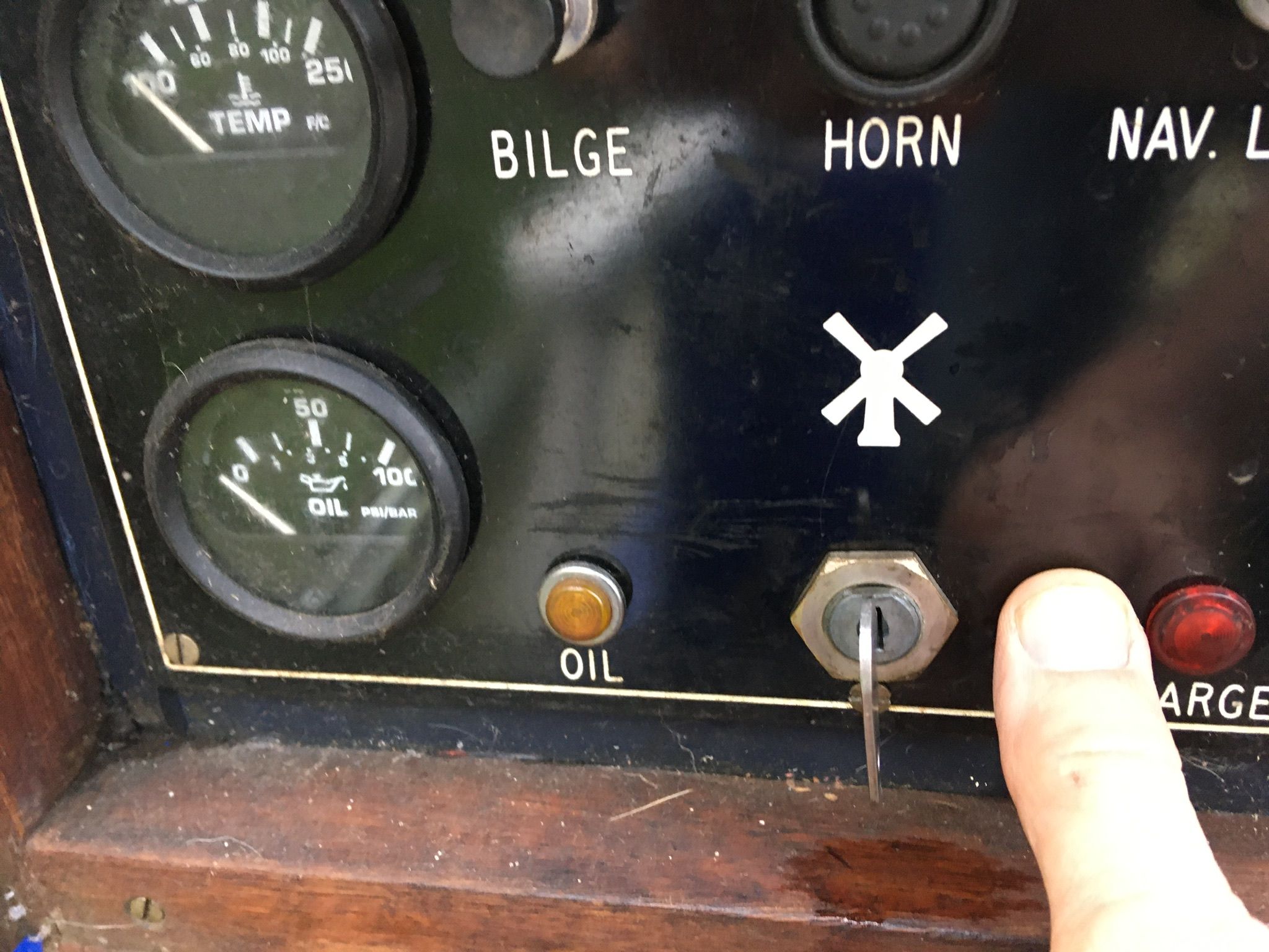

I unfortunately left a slightly bent ignition key in the key box and my better half tried to use it to start the engine (see photo). It worked fine but because of the slight bent at the shoulder of the key it is now stuck in the barrel. I’ve been reluctant to force it as it may snap off on the barrel and I will then be unable to start the engine. I’ve tried WD40 with no joy.
any ideas?
Does leaving it there do any harm? Our ignition key rarely leaves its slot, or barrel. As long as it starts the engine, there is surely no problem.
I guess that if your boat has a cruiser stern you might be concerned about an unauthorised person starting the engine; if you have a trad, then you hav eno such concerns.
There’s no trick to removing it. Wiggle it, pull it etc. Oil won’t help because it’s mechanically held, not through corrosion.
If you truly feel that it’s likely to break then buy a new barrel before attempting to remove it. If it doesn’t break then you have a spare, if it does break then well, you have a spare :)
Looking at the photo it appears that the key is a simple 'tractor' type. This suggests to me that the barrel is basic budget type widely available on the internet. Any decent chandlers would also stock them.
As WotEver said when you have a new one just pull the old one out (imagine yourself a dentist). You may wind up with a spare.

Looks like a Calcutt panel, probably attached to a BMC B series endine.
As stated, it is just the standard "one key fits all" tractor type, so easily replaced if the worst happens,
I'd get hold of it with decent pliers and try a straight pull, I think if you are lucky you could exert quite lot of force with nothing breaking, but I'd push firmly against the panel near the switch with my other hand whilst pulling, as the panels are quite a fragile material, and I imagine you could break it away from the four screw heads where it is retained only at its corners.
Put a pair of snipe nosed pliers either side of the key, parallel to the panel and with  a bit of  tin (a lid?)  under the tips to spread the load.
Then lever gently outwards.

Known as a plant key, tool hire shops will have them for the mini diggers etc.  A bit pointless really, just about any bit of metal that will go in the hole will turn the barrel.
They often get stuck even if not bent, a straight pull required.
