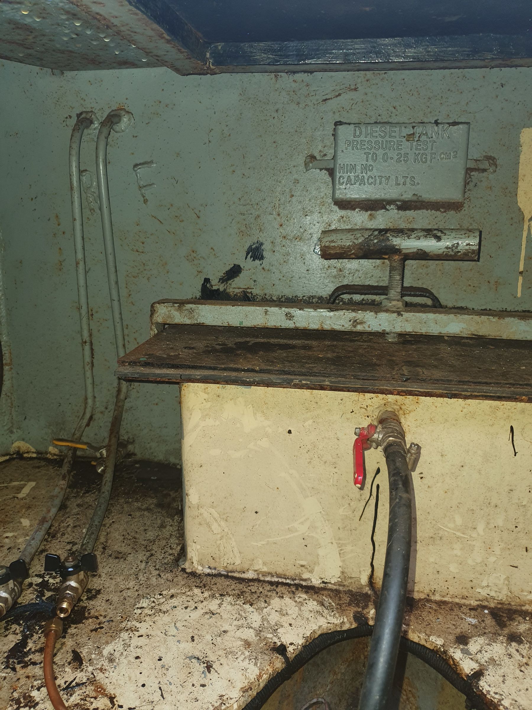

Alan de Enfield Posted January 4, 2020 Report Posted January 4, 2020 3 minutes ago, Deano1988 said: This is the tank area in engine bay. Just making sure the 1 with the handle on is for the lubricant for the propeller? Do you all think fuel polishing will do the trick? Thanks dean I'd be more than a little concerned about the unconnected diesel pipe, and the 'yellow' drain tap (that alone is a Boat safety test failure) 2.8.1 Is the fuel tank drain fitted with a plug or cap which can only be removed with tools? Check each fuel tank for the presence of a fuel drain facility. If present, check the drain outlet for the presence of a plug, cap or blank.If present, the outlets from fuel tank drains and drain valves must be terminated with a ‘tools‐to‐remove’ plug, cap or blank. Hopefully you have just disconnected them whilst you sort out you fuel problem , but if not then you now know you must have a 'tool needed to remove' fitting on the ends of the pipes. The pipe with the red handle LOOKS LIKE it is the water supply for the propshaft, but without seeing where the other end goes, it could even be a bilge pump hose.
bizzard Posted January 4, 2020 Report Posted January 4, 2020 I'd also be concerned about the screw thread on the weed hatch lid securing clamp. Looks like it is probably seized up, needs oiling and screwing up and down to lube the thread, or when you come to need to use the hatch to clear the prop it might not undo or even snap if too much force is used on the handle.
frahkn Posted January 4, 2020 Report Posted January 4, 2020 9 minutes ago, bizzard said: I'd also be concerned about the screw thread on the weed hatch lid securing clamp. Looks like it is probably seized up, needs oiling and screwing up and down to lube the thread, or when you come to need to use the hatch to clear the prop it might not undo or even snap if too much force is used on the handle. Particularly as the handle looks like a wooden 'T' on the metal shaft. OTOH the (currently illegal) drain may help with cleaning the tank.
bizzard Posted January 4, 2020 Report Posted January 4, 2020 For £6 odd I'd buy one of those pumps from Ebay, that I depicted in post 24. They really suck well and will suck up sludge and small particals of rust. Just poke the bendy plastic pick up pipe into the fuel filler. You can bend the pipe better if its heated a bit with hot water to reach all corners of the tank. You will need some old cans to pump the mucky fuel into.
Deano1988 Posted January 4, 2020 Author Report Posted January 4, 2020 1 hour ago, Alan de Enfield said: I'd be more than a little concerned about the unconnected diesel pipe, and the 'yellow' drain tap (that alone is a Boat safety test failure) 2.8.1 Is the fuel tank drain fitted with a plug or cap which can only be removed with tools? Check each fuel tank for the presence of a fuel drain facility. If present, check the drain outlet for the presence of a plug, cap or blank.If present, the outlets from fuel tank drains and drain valves must be terminated with a ‘tools‐to‐remove’ plug, cap or blank. Hopefully you have just disconnected them whilst you sort out you fuel problem , but if not then you now know you must have a 'tool needed to remove' fitting on the ends of the pipes. The pipe with the red handle LOOKS LIKE it is the water supply for the propshaft, but without seeing where the other end goes, it could even be a bilge pump hose. The fuel tank was disconnected and put to temp tank while I got the engine started (it's now running fine) just don't want to reattach tk the tank until it is sorted. The only drain for the fuel is the yellow tap in picture. 1 hour ago, bizzard said: I'd also be concerned about the screw thread on the weed hatch lid securing clamp. Looks like it is probably seized up, needs oiling and screwing up and down to lube the thread, or when you come to need to use the hatch to clear the prop it might not undo or even snap if too much force is used on the handle. I will have a look tomorrow at the handle and take some lubricant. The handle is metal So this is a weed hatch? What is the pipe for it goes to the prop shaft?
bizzard Posted January 4, 2020 Report Posted January 4, 2020 (edited) 8 minutes ago, Deano1988 said: The fuel tank was disconnected and put to temp tank while I got the engine started (it's now running fine) just don't want to reattach tk the tank until it is sorted. The only drain for the fuel is the yellow tap in picture. I will have a look tomorrow at the handle and take some lubricant. The handle is metal So this is a weed hatch? What is the pipe for it goes to the prop shaft? You probably have a rubber Cutless water lubricated sterntube bearing, Vetus possibly and the tube is to vent it to the weed box to allow canal water to run up inside the the cutless bearing to lubricate and keep it cool. Edited January 4, 2020 by bizzard
Alan de Enfield Posted January 4, 2020 Report Posted January 4, 2020 10 minutes ago, Deano1988 said: The only drain for the fuel is the yellow tap in picture. That is the one that to be granted a safety Certificate, MUST be closed such that it can only be operated using a 'tool'. This is to avoid (little hands, or accidently opening) it filling your bilge with 100's of litres of fuel then your bilge pump pumping it all out into the canal.
Deano1988 Posted January 4, 2020 Author Report Posted January 4, 2020 13 minutes ago, Alan de Enfield said: That is the one that to be granted a safety Certificate, MUST be closed such that it can only be operated using a 'tool'. This is to avoid (little hands, or accidently opening) it filling your bilge with 100's of litres of fuel then your bilge pump pumping it all out into the canal. Thanks for that I will have to get this done because it defo doesn't have this Cheers
WotEver Posted January 4, 2020 Report Posted January 4, 2020 2 hours ago, Deano1988 said: Do you all think fuel polishing will do the trick? It won’t get rid of any of the crud in bottom of the tank. How much fuel is in the tank? If it’s not worth loads more than £200 then why polish it? Dump it at your local tip and then cut an access hole and get the tank cleared of all the gunk while it’s empty.
WotEver Posted January 4, 2020 Report Posted January 4, 2020 37 minutes ago, Deano1988 said: Thanks for that I will have to get this done because it defo doesn't have this Removing the handle should do it. That just leaves a little stub sticking up which requires tools (like the handle) to undo.
David Mack Posted January 4, 2020 Report Posted January 4, 2020 37 minutes ago, WotEver said: Removing the handle should do it. That just leaves a little stub sticking up which requires tools (like the handle) to undo. The appropriate suzed BSP threaded cap would be much better, preferably with a fibre disc seal inside it as this looks like a parallel threaded valve fitting. Get a hexagonal cap (some are round) and it can then readily be fitted and removed with a spanner.
