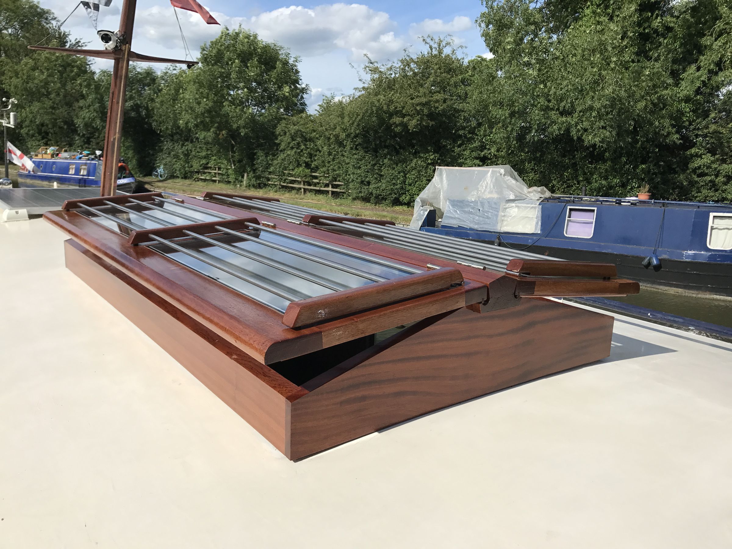

The trouble is that materials alone for a quality Dogbox like the one below are over a grand, closer to £1500. Then, if it’s the same design as this one it’s a LOT of work to build it. But... it won’t leak  0729EA9D-A0BA-4D21-A8E6-336EDED7F83F.jpeg.42936c31619c3c5c3b6d53db3fba5b3b.jpeg
Every time I see that I'm equally impressed. Lovely job.

Sure, but the price you quoted would be pretty close, depending on size and fittings (brass v stainless).
The design shown in the photos is taken from my book "Narrow Boat & Dutch Barge Joinery Designs" and very unlikely to leak if properly made with flush glazing.
available on Amazon.
I think it's fair comment to say that most dog boxes and deck lights are poorly made and tend to leak (those from Wotever and myself being exceptions of course) the easiest way to spot a duff one is to look for a diamond shaped rail fastened to the top of the ridge, this is usually a desperate (and futile) attempt to keep rain off the hinged joint and stop it leaking. A look at my gallery will show fitting and water proofing systems that work well! It's not rocket science, just old fashioned standard joinery methods.
