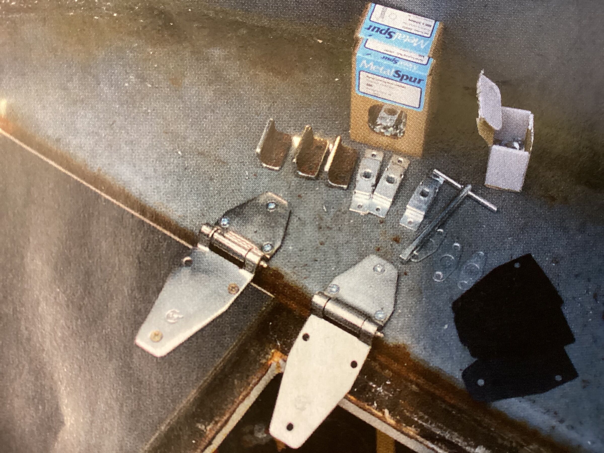

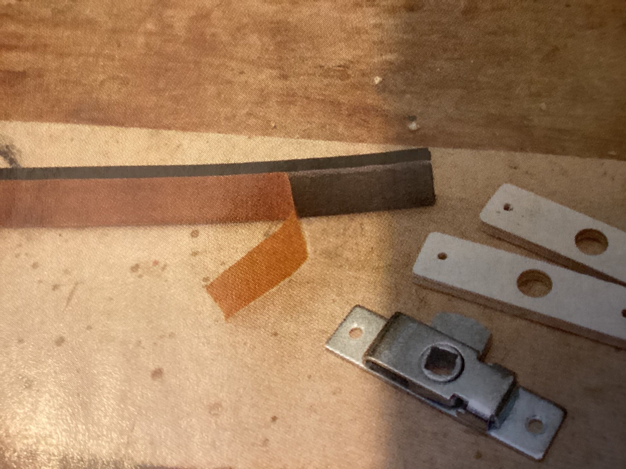

As already suggested it’s far more effective and cheaper to effectively seal the engine space to contain the noise. The deck boards are ideally hinged and fitted with “budget” locks which operate with a square shaped key together with gas struts to hold them open when needed. The adhesive foam strip must be compressed when the boards are locked down to make the deck airtight. Obviously air must be admitted through a sound trapped vent to keep the engine running. It’s not a five minute job but works much better than trying to absorb the noise. My last two boats were treated in this way together with absorbent materials on the underside of the boards. On several occasions I was asked what engine I had, only to surprise the person asking by saying it was a 1.8 Leyland rattling like all the others but sealed in. Photo to follow with luck! -
