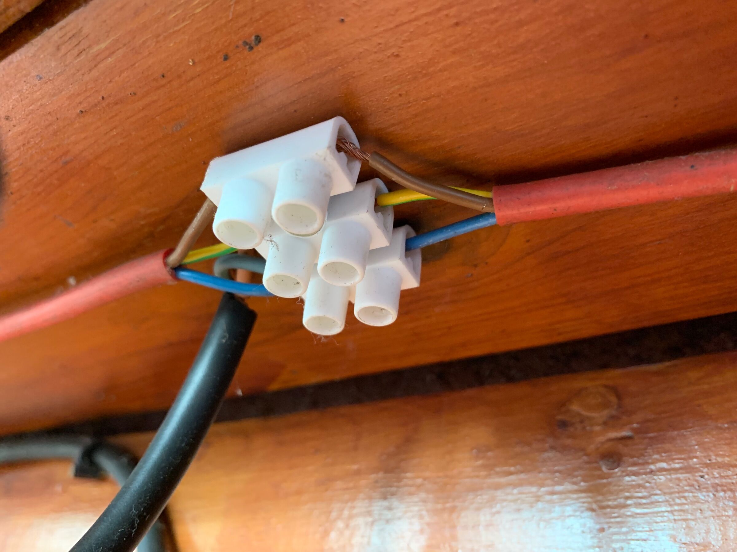

  8. Ok. Just another query but the cable (quite thick) running from the inverter then goes into this connection block. Is this sort of block acceptable or is this a weak point?

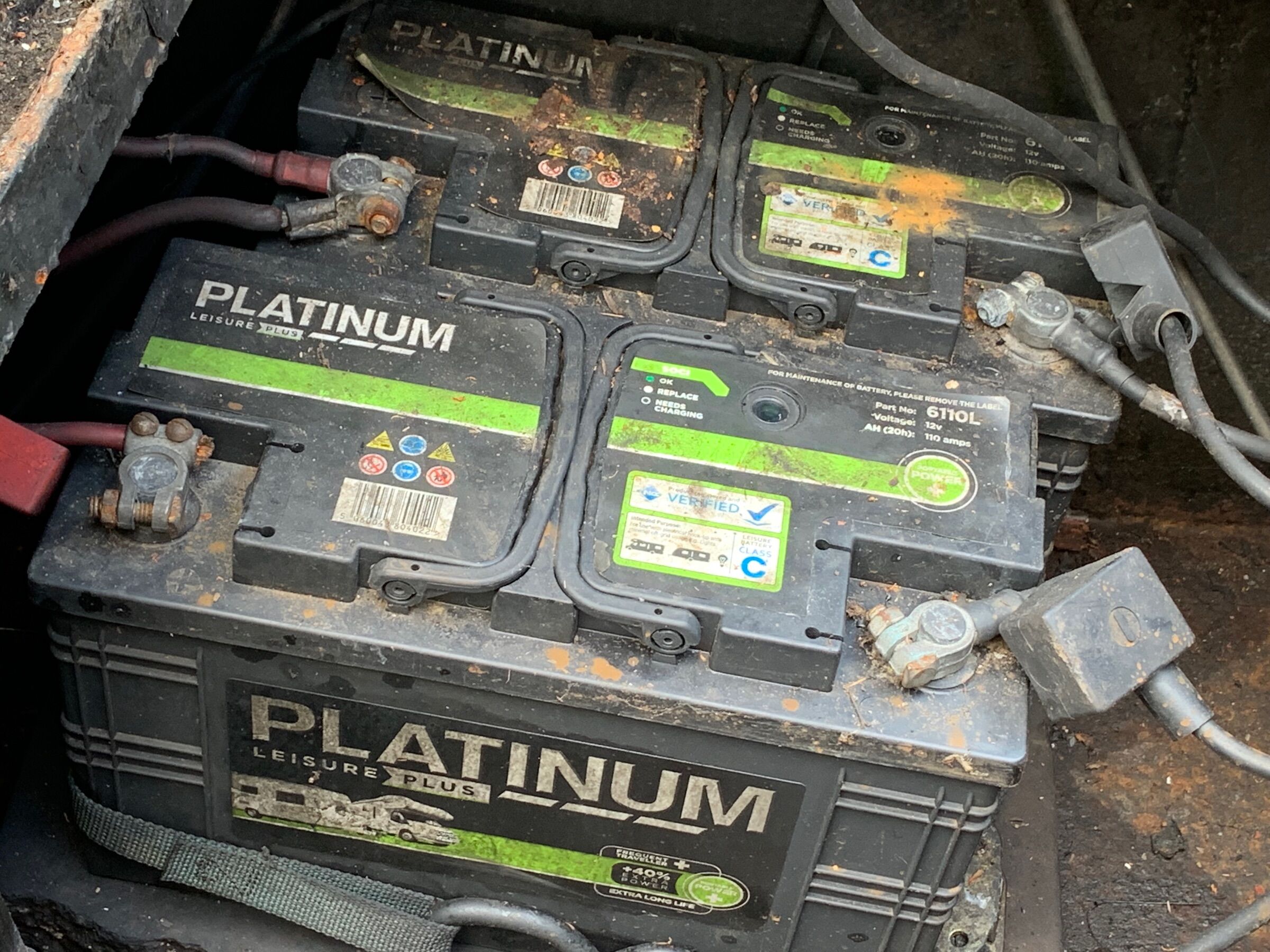

  9. OK. A bit of further inspection done. 3 of the 4 batteries have green spots in the inspection eyes, one is black. Could a single battery failure be the issue, presumably not? Wondering whether to isolate that one (along with the one already isolated). I did bring a spare (small ish) battery I had in the garage at home just in case it might be useful. It’s in the car now… mo’s engine still running and volts now 13.4 and rising so charging is happening at least.
  10. OK. I am prepared for it being the batteries so I’m not in denial, just trying to look at the other options before having to sort out a load of new ones only to find it is something else. Engine running 10 mins now and they are back up to 13. inspection eye still looks green…) ps solar now sorted, I found a loose connection!
  11. Right. Hoover worked for a minute and then cut out. fuse was between the controller and the battery packs. woth engine running (apparently the hoovering is the main priority I am told) the batteries are testing at 12.3v…WHAT??? alternator belt looks tight and alternator looks fairly new.
  12. OK - at the boat now. solar was showing 12.7V and batteries tested 12.7v solar disconnected and batteries tested at 12.79v turned inverter on and they dropped to 12.78v downside is solar is now not wanting to work but maybe it takes a little time after removing the fuse to work again? OH is now about to hoover so let’s see what happens!!

  14. Thanks Tony, that’s a good point on the solar. Sorry for all the questions… - the electrics are turned totally off but the solar is on. Will the solar still charge the batteries even though the electrics are off? I know you don’t know how my boat is wired up but usually the solar would continue to charge even with electrics off? - I should in theory come back to healthy battery levels given the above (sunny weather and no usage drain for the past week)? - the volt meter in the boat (the one that gives a mis-leading reading I think) will be taking an average of all 4/5 batteries will it? - given all the leisure’s are linked when I stick the multimeter on one battery am I effectively getting an average of them all, or genuinely getting that particular batteries reading? They were all within very tight tolerances when I last checked, hence me wondering. - your point about solar voltage, so if I understand the point it’s that whilst the solar is charging any reading taken at the +ve and -ve terminals of an individual battery isn’t the voltage of that battery but a function of what the solar is chucking in…a bit like doing it whilst the engine is running…that makes sense now you point it out. Thanks
