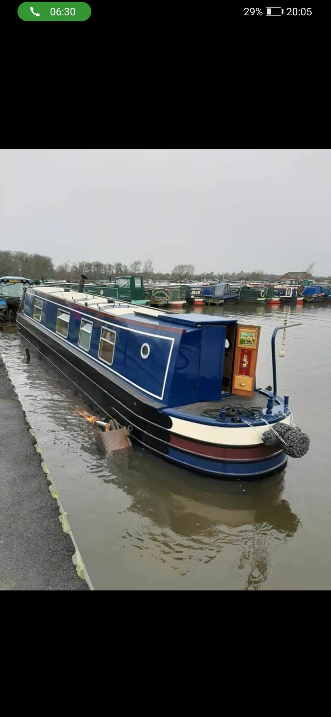

  2. That was when refloated after repaint
  3. The company that cleaned fuel cut the other inspection hole in top of stern deck. The picture were taken when she was refloated after full repaint. Thanks for all the help and ideas given. Going to just book her in to yard and get them to sort it

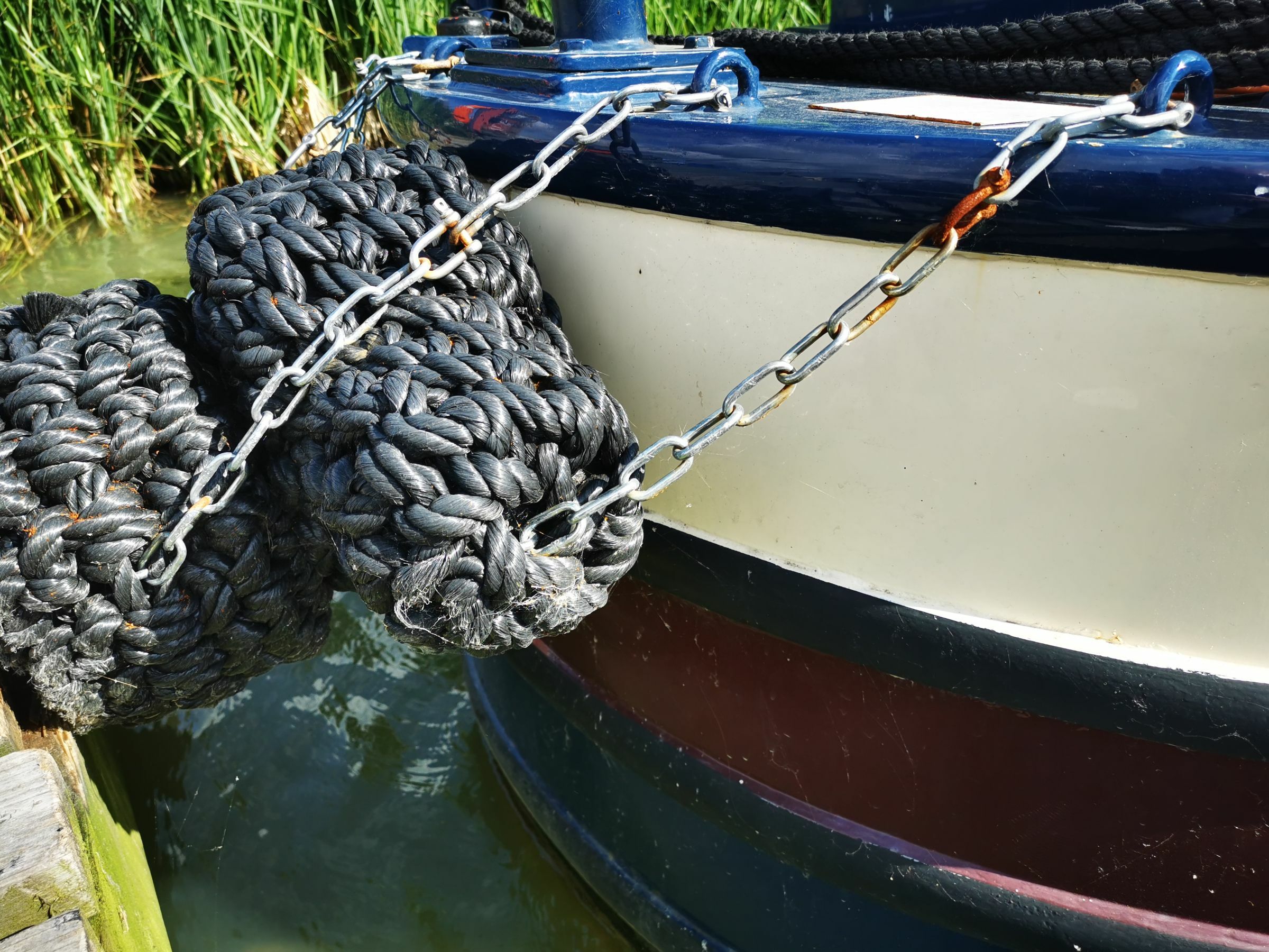

  4. Can't upload other file. As to big. Basically on deck tiller is has plate with four bolts holding it on deck. When you crawl inside all that faces you is a flat piece of steel. But have solid stern with no plate. This may be better picture
  5. Will try upload some photos. Have no removable plate on stern. Inside Hull have only flat still plate but when we cleaned tank cut second hole and could see pipe at bottom joining both sides together so we presume tiller runs up inside and water getting in through the tube and small pipe at bottom. To be honest had engineering friend look at it who works for local canal hire company and he came to same conclusion
