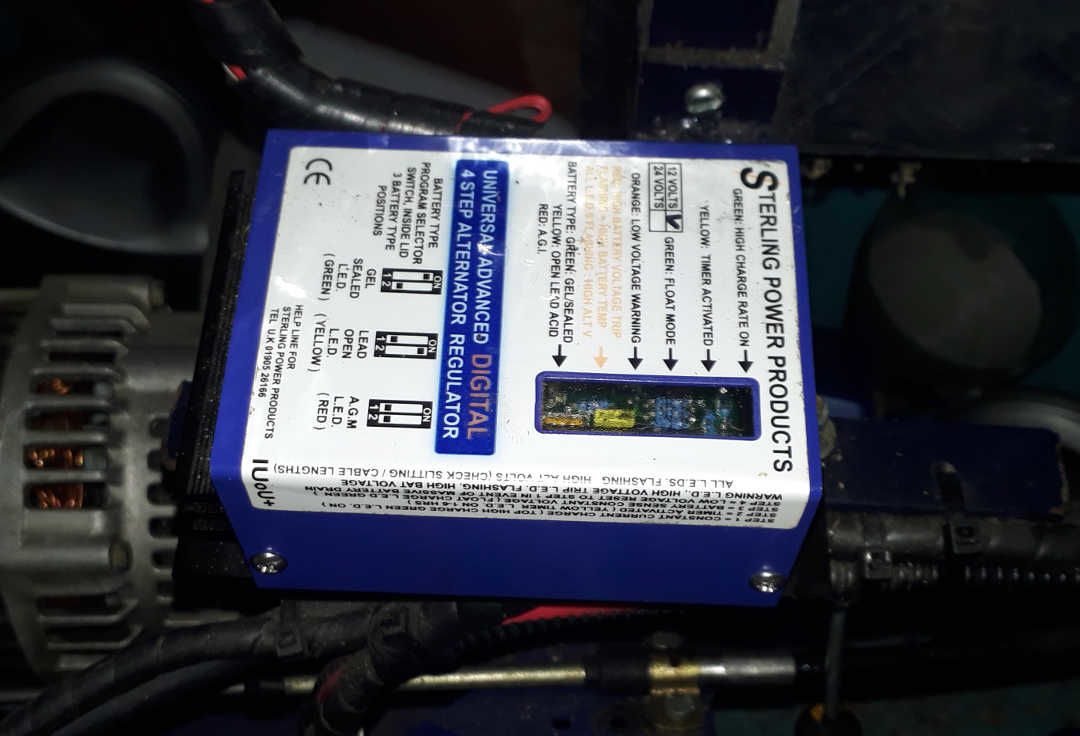

It is this one:

eid, that looks like an early Sterling regulator. These didn't have automatic sensing of battery bank size. Instead they had a user adjustable timer via tiny dip switches inside to control how long it was in the higher voltage absorb charge mode. If it's already set to the max, which from distant memory is two hours, then there is nothing more to be done, unless you buy latest version. Otherwise set timer to max.
Note the timer switches are a separate set from those depicted on casing which set battery type. Worth checking they are set appropriately though.

5 hours ago, eid said:
It is this one:
That's the one I had, the older yellow ones are fine. Personally I wouldn't entertain one on my system, just change the internal regulator for a higher voltage one.

That’s the mk2 version, it is self setting for battery bank size, mine has always worked fine. Check it is set for the correct type of battery.
It should/will have a temperature sensor fitted to one battery and wired into the box. Check it’s fitted correctly.
I realised last night that I have never before seen this regulator go into float mode. Or rather, the float light comes on but it stays at 14.5v.
I'm not sure it has a temperature guage. I'll check later.
