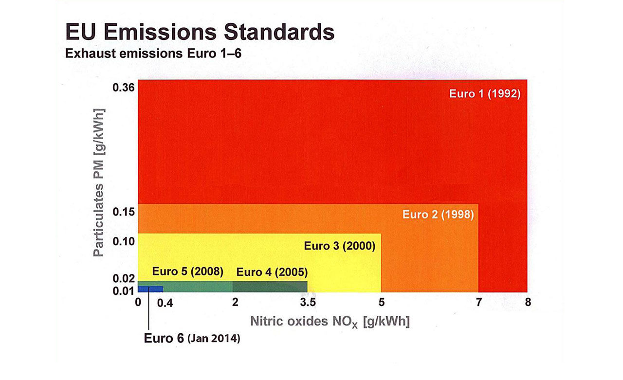

  5. Little consideration seems to be given to the latest Euro 6 approved diesel-engined cars . Our own 2015 Mini attracts just £30 a year VED, others zero in line with all electric cars. If the government holds them in such high regard aren't we on track to meet the pollution goals, especially as the next even tighter Euro 7 standards are being prepared. See below the massive advances made since 1992 when Euro 1 was introduced.
