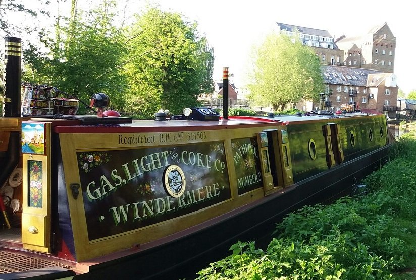

I had good result using a random orbital polisher (battery powered). To apply and polish the wax. Blue paint is > 5 years old.
