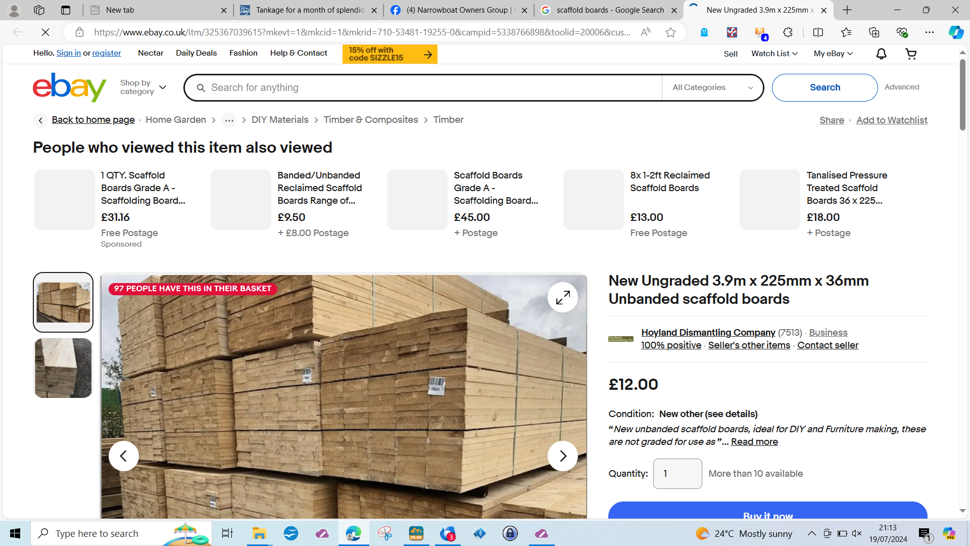

Surprisingly the budget spreadsheet already has an entry of £150 for the initial hire of 2 calor bottles.
The floor will be scaffold planks and I hope in the £1500 budget for those there will be one leftover spare. They are 38mm thick so possibly over spec'ed and over weight for a shore plank?
Scaffold planks, seem like a good idea, and if well planned could give good access to the bilge, unlike the conventional ply sheeting, which prevents access. They will get pinned down by various bulkheads, kitchen cupboards, bathroom fittings, beds and the like. It will require some planning of the plank layout. They are a bit industrial, and you could budget to hire a floor sander to prep the surface once down. They come with metal end straps which you will need to remove, or cut the ends off.
They will be strong enough to use as a gangplank, but a heavy lump to shift around from one end, though they can be had in different lengths.

Cost-wise I saw new scaffold planks for sale in a huge B&Q the other day. £30 each for 8ft (IIRC) long planks.
£20 in Homebase.

4" x 8" x 9 feet Railway sleepers (new) can be had on ebay for £18
You will lose a lot of headroom with 38mm boards.
Edited by Alan de Enfield
38mm is a bit thick,  mm of vertical height are precious.

With 38mm boards, you don't need the 25mm ply boards, so the loss in height is only 13mm ~ ½ inch.  If this is a new build and headroom is a problem, then it shouldn't be too difficult to sort it with the builder. But for ½ inch? I suppose it depends on how tall you are, and the shell you go with. Use thinner battens on the floors?
If it is a sailaway with a ply floor already fitted, then you need to speak to the builder, about the headroom, but then scaffold boards would be a complete overkill, and would benefit from a change of plan.

In use your gang plank will span 6-8 feet from boat to shore. On a proper scaffold, the boards would be supported every 3 feet or so. Just saying...
 Ooo no, not at that price given the quantity involved. £30 for 8ft would equate to £3000+ for a whole shell fitout.
These planks are 9" or 225mm wide, so call it 10 across with some wastage. Building trade scaffold boards are 13ft or 3.9m long. I need a hundred full length boards or more at 8ft.
I will be buying in bulk from a major trade supplier in Immingham. £15 per 13ft board. That is still £1500. I have not costed out the more typical floor make up of ply finished with Amtico or other domestic laminates.

For multiple reasons I am now erring towards a non sailaway shell. Looking at the floor makeup it would be difficult to loose 13mm. Between the ribs there would be 100mm of concrete brickettes and 10mm of PIR insulation plus an air gap. Good practice requires resting the bricks on small plastic spacers for more air circulation so we are looking at about 122 plus 38mm. I am 6ft tall.
Thinner timber floor bearers? Maybe, need to allow for long timber floor fixing screws with the counter dual threads that pull both timbers together.
If you just want a wide-boarded floor why not buy planed timber at 200mm or 225mm x 25mm, and save yourself all the time and effort of sanding down rough scaffold boards?
My local timber yard has these in medium quality redwood, but if you are willing to accept narrower boards and whitewood the cost comes down, and the boards are already t&g'd.
