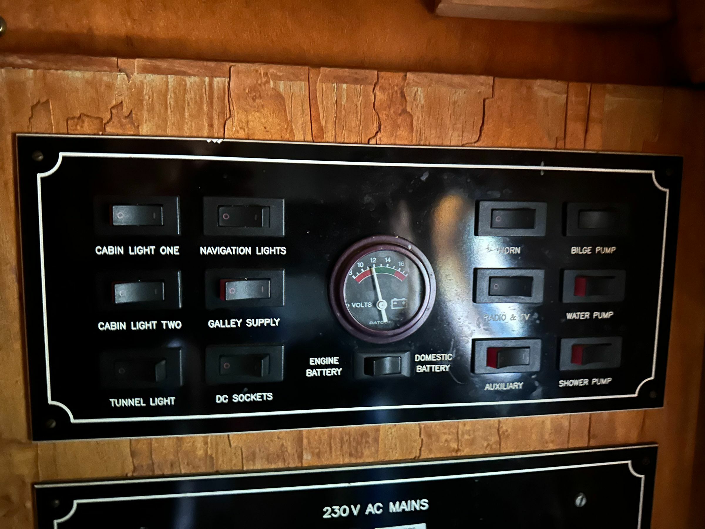

This and that the voltage indicated looks to be at, or below 12V suggests that the batteries are flat. That either could be down to undercharging over weeks, leading to the batteries losing capacity, or possible the engine alternator not charging. What does the voltmeter say when the engine is on? Flat batteries can often still light LED lamps, but any pumps won't turn, or only with great reluctance.
The panel voltmeter is no more than an indication. Not capable of measuring voltage with the degree of precision really needed. Not able to measure tail current, which you need to ensure the batteries are fully charged. There are various options, but first things first on the question above.
33 minutes ago, newbienarrowboatowner said:
We were told to read the charge here, it usually goes up to around 12.6V:
12.6 volts is nowhere near fully charged, and (apart from the fact you cannot even read 12.6 on that gauge - it could be 12.3, 12.4, 12,5) it could be anywhere between about 70% to 90% State of Charge.
By not fully charging every time you are slowly killing your battery capacity.
You need to be charging at around 14.4 - 14.6 volts
Your domestic batteries are showing about 11.5 volts (dependng on which side of the needle you use) and that is a 'dead' battery.
(Sorry for our ignorance, it's a steep learning curve!)
Yes, you can get a very rough idea of the charging or battery voltage on that toy gauge. It is not accurate enough to imply state of charge. At least half an hour after all charging stops, including solar, will allow you to imply the state of charge (as per the batter primer), but not by that meter. If it was an accurate digital meter, then 12.6V would indicate a well charged, but not fully charged battery. I fear that may be the solar voltage, not the artery voltage, very soon after the charging has stopped.
I fear the 12.6V is the engine battery voltage, not the domestic bank. This to put a digital voltmeter on the domestic bank.
When the engine is running a 1200 to 1500 rpm (for most engines) you should get a bit over 13 volts at first and gradually rising over the several hours to something in excess or 14.2 volts, could end up as around 14.4. to 14.5V. On the face of it the alternator of batteries is faulty because with very flat batteries or batteries with internal short circuits the high charging current will pull the charging voltage down to, perhaps, sub 13V.

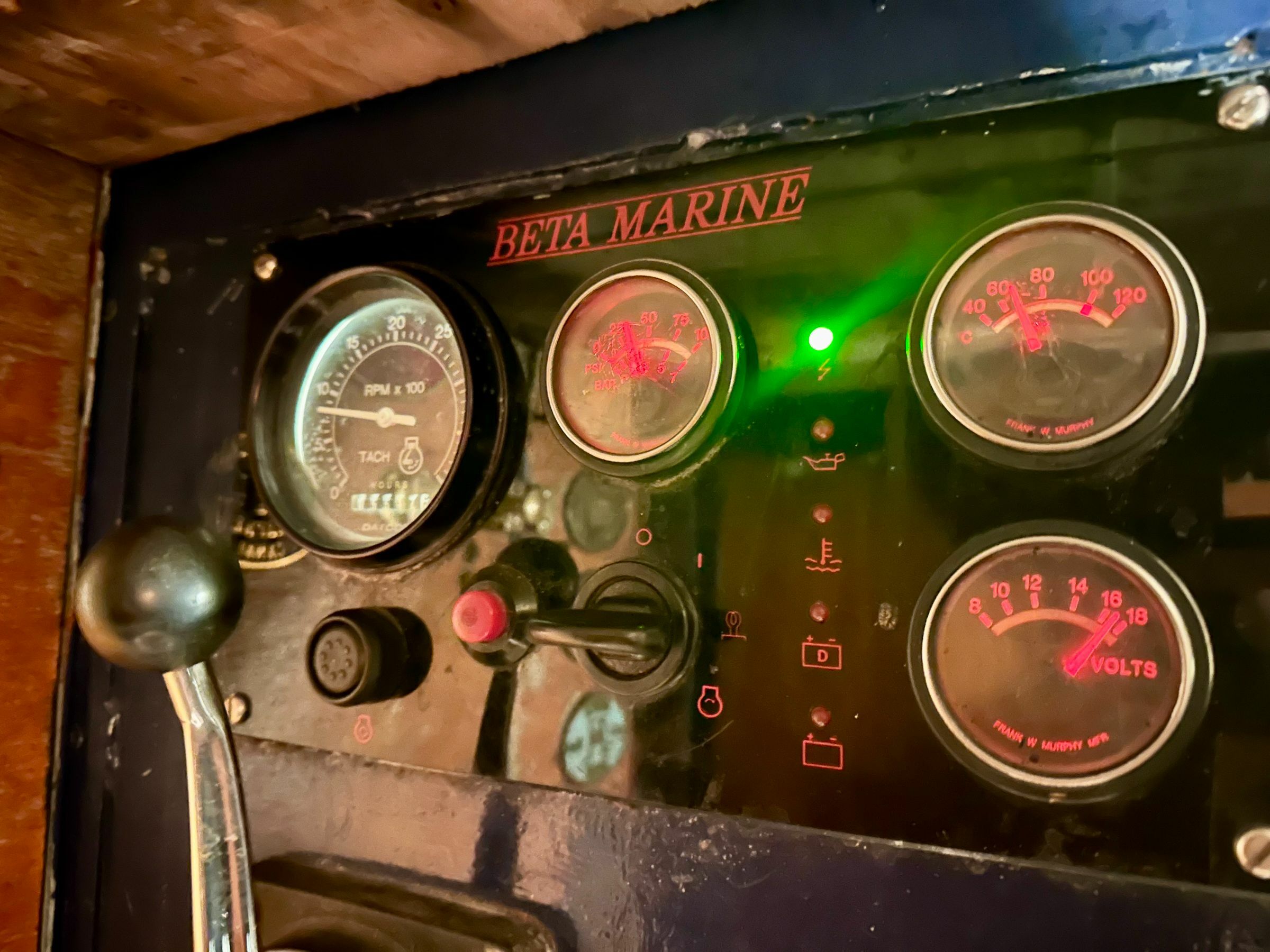

Is that green one on before you start the engine?
Apologies, yes the belts on the engine are turning the alternator, and there are no warning lights lit on whilst the engine's running. Just the green one to say it's charging.
Almost certainly that is wrong. The charge warning lamp should come on when you turn the ignition on and then go out when the engine has started and you have given it a bit of a rev. That will be the case for about 98% of boats. I would suggest that it says one alternator is indeed not charging. When running properly, ALL warning lamps should be out.
this assumes of course that he boat is wired up as most (but not all) are and that the 'green light' is on the engine control panel and not on a charger or inverter or some other equipment.
might be helpful to confirm the engine details and/or post a pic of the engine and control panel (where the green light is) so that relevant advice can be given.
if the voltage when the volt meter is switched to 'domestic' (as per your picture) and the engine is running, does not change then as Tony and others are suggesting it would point to a problem with that alternator or its wiring.

This is where the green light is, with all of the engine controls. It has a small lightning bolt underneath it, and we were told that when that's green, the batteries are charging. Apologies for our ignorance with this, if that's not the case!
When the volt meter is switched to 'domestic' and the engine is running, the number is now around 14V.
