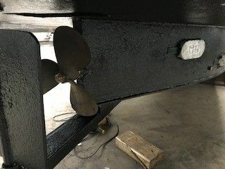

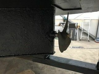

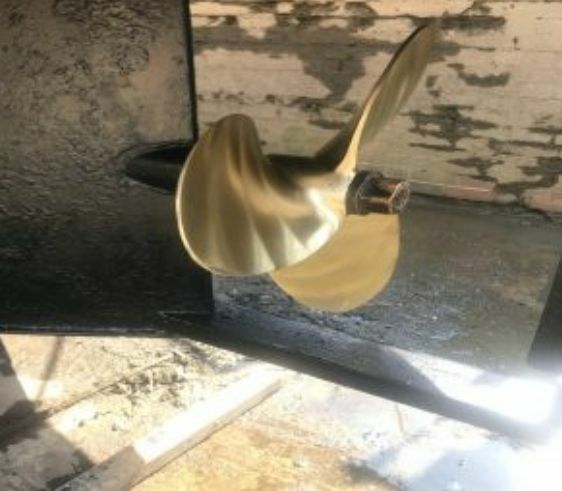

Hi All
Since getting Lily in 2019 she's been a fab boat, but I noticed that when moving forward and wish to stop/go into reverse she's not keen!  When we have the dance at bridges when someone else is coming through I can sit there in reverse for a fair while before she will actually go backwards and i jus have to smile nicely while people wonder if im going to do anything!.... I'm sure I've not noticed this on other boats i've been on. Always thought its just one of those things, but thought i'd ask the question at least. I dont have much info other than the prop is 18" - some rubbishy pics below....
This is especially bad in locks where i can have her in full reverse but still she moves forward - i know this occurs in the 'rush', but just checking if i can improve it?

Thanks all. It all engages fine and i see the wash up the side etc... its definately 'different' to our other shareboat in how responsive stop/reverse is.
 as an aside when generally cruising i seem to need more revs than others i see - seems to be around 1700rpm for slow walking pace... could this be related?
