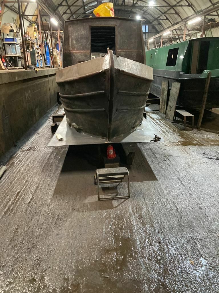

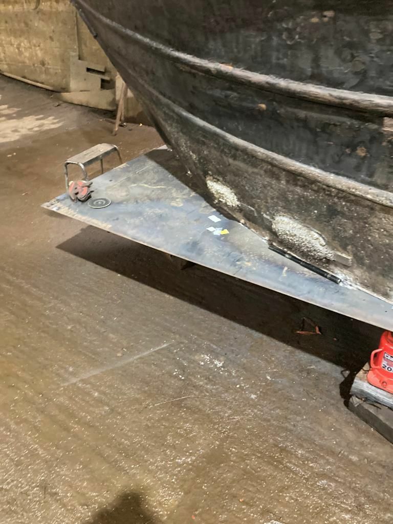

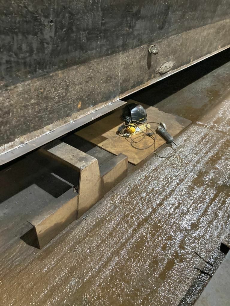

Mark R Posted Thursday at 16:03 Report Share Posted Thursday at 16:03 Hi all, Further to my previous posts regarding the potential purchase of a Fenchurch narrowboat, the current owner has sent me a copy of the survey dated in July of last year. Since then the boat has been overplated with a 6mm base plate, according to the seller (who I have no reason to doubt), he asked the surveyor to inspect this work once carried out. Having read plenty of posts regarding overplating I know some on this site don't necessarily agree with it. He is happy for me to speak to the surveyor for peace of mind. Obviously I’d not purchase the boat without a survey. Is it worth a punt? I’ve attached a copy of the survey and some photos of the overplating. I’d really appreciate your expert opinion on what you see and read! It’s a 120 mile trip to see the boat, if there’s an obvious reason not to I’d love to know rather than make the journey. Apologies if I should have attached this to my previous post regarding Fenchurch boats. Hull survey mystic Dancer.pdf Link to comment Share on other sites More sharing options...
Paul C Posted Thursday at 16:22 Report Share Posted Thursday at 16:22 So it was recommended to fill in the pits in the base plate and re-ballast (ie remove ballast) because the weedhatch sides were deemed too low. But its been overplated on the base - have the weedhatch sides also been raised? Are the various hull fittings still sufficiently clear of the waterline? These are some basic questions worth asking. Other than that, no real red flags in the report, although obviously its just a hull survey with a ton of caveats and CYA clauses in there. 1 Link to comment Share on other sites More sharing options...
Mark R Posted Thursday at 16:42 Author Report Share Posted Thursday at 16:42 20 minutes ago, Paul C said: So it was recommended to fill in the pits in the base plate and re-ballast (ie remove ballast) because the weedhatch sides were deemed too low. But its been overplated on the base - have the weedhatch sides also been raised? Are the various hull fittings still sufficiently clear of the waterline? These are some basic questions worth asking. Other than that, no real red flags in the report, although obviously its just a hull survey with a ton of caveats and CYA clauses in there. Cheers Paul, appreciate your input! I shall certainly ask the seller. Link to comment Share on other sites More sharing options...
GUMPY Posted Thursday at 16:55 Report Share Posted Thursday at 16:55 That square plate is going to make it very difficult to nudge lock gates open 😱😂 1 Link to comment Share on other sites More sharing options...
Alan de Enfield Posted Thursday at 17:00 Report Share Posted Thursday at 17:00 53 minutes ago, Mark R said: I’d really appreciate your expert opinion on what you see and read! It’s a 120 mile trip to see the boat, if there’s an obvious reason not to I’d love to know rather than make the journey. I'd reiterate what Paul C has said. If the surveyor commented that it was sitting too deep in the water, then overplating will have made the situation much worse. What, if anything, has been done to counteract the additional weight ? (Ballast removed, hull fitting raised higher, etc etc) 2 Link to comment Share on other sites More sharing options...
Mark R Posted Thursday at 17:11 Author Report Share Posted Thursday at 17:11 9 minutes ago, Alan de Enfield said: I'd reiterate what Paul C has said. If the surveyor commented that it was sitting too deep in the water, then overplating will have made the situation much worse. What, if anything, has been done to counteract the additional weight ? (Ballast removed, hull fitting raised higher, etc etc) From what I gather it has had new ballast, I'm assuming this might be to meet the recommendations. Here is a link to the boat... https://narrowboats.apolloduck.co.uk/boat/fenmatch-58-cruiser-stern-for-sale/731667 I'm not sure if you can tell much from the pictures on there. Link to comment Share on other sites More sharing options...
ditchcrawler Posted Thursday at 17:13 Report Share Posted Thursday at 17:13 18 minutes ago, Loddon said: That square plate is going to make it very difficult to nudge lock gates open 😱😂 Behave 1 1 Link to comment Share on other sites More sharing options...
Mark R Posted Thursday at 17:14 Author Report Share Posted Thursday at 17:14 18 minutes ago, Loddon said: That square plate is going to make it very difficult to nudge lock gates open 😱😂 He's reliably informed me it has been done like that so if the canal freezes over it can be used to skid across the ice. He told me it's a one of a kind. 1 Link to comment Share on other sites More sharing options...

Bod Posted Thursday at 20:37 Report Share Posted Thursday at 20:37 My initial comment would be, the surveyed boat, is different to the photographed boat. There is no indication of re-plating needing doing in the survey. The photographed boat has had the paint removed, possibly the interior stripped(?) Before travelling to view, a recent time stamped photo, showing the identity of the boat might be an idea. Bod. 1 Link to comment Share on other sites More sharing options...

Mark R Posted Friday at 06:51 Author Report Share Posted Friday at 06:51 10 hours ago, Bod said: My initial comment would be, the surveyed boat, is different to the photographed boat. There is no indication of re-plating needing doing in the survey. The photographed boat has had the paint removed, possibly the interior stripped(?) Before travelling to view, a recent time stamped photo, showing the identity of the boat might be an idea. Bod. Hi Bod, The boat is a project where the current owner's situation has changed (as is always the case). What makes you think it's a different boat? Is it the window to the rear? If so this was welded up. One thing the owner did tell me was that the boat was partially submerged a couple of years ago, this was partially at the stern end, it didn't sink as such. The interior was stripped as it was a total overhaul due to water ingress inside (as a result of the water intake in the stern end). 9 hours ago, MtB said: People do so love to have boats overplated unnecessarily. Now the boat had been ruined, I recommend you don't buy it. What makes you say it's no longer worth purchasing? I understand it might have been overplated unnecessarily but how does it ruin the boat? Link to comment Share on other sites More sharing options...
Tony Brooks Posted Friday at 07:33 Report Share Posted Friday at 07:33 32 minutes ago, Mark R said: Hi Bod, The boat is a project where the current owner's situation has changed (as is always the case). What makes you think it's a different boat? Is it the window to the rear? If so this was welded up. One thing the owner did tell me was that the boat was partially submerged a couple of years ago, this was partially at the stern end, it didn't sink as such. The interior was stripped as it was a total overhaul due to water ingress inside (as a result of the water intake in the stern end). What makes you say it's no longer worth purchasing? I understand it might have been overplated unnecessarily but how does it ruin the boat? In reverse order. Probably Mike's sense of humour. Otherwise, a number of people would never buy an over plated boat because of the difficulty of proving it is a serviceable job. If it went down by the stern, the engine was probably under, and that might explain what looks suspiciously like a nice clean "bitsa" BMC engine. One thing is for sure, it is in the vehicle colour, not marine. That is not necessarily a bad thing, but who knows its history or work done. It looks like a new skin tank, and it looks as if it passes through the rear bulkhead. This is an unusual feature, and prevents the assessment of size, it may well be inadequate for river or high power work. That is two things I would want a lot more info about. Link to comment Share on other sites More sharing options...
