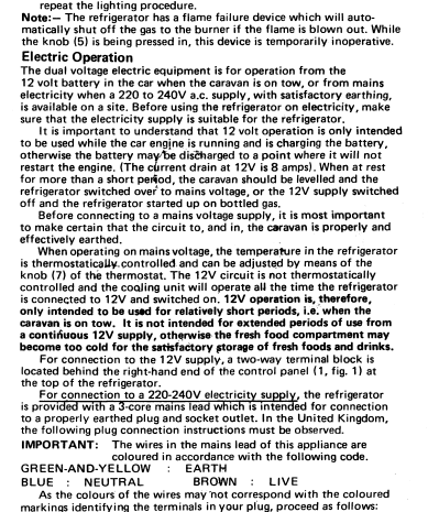

Basically there are two types of 12v fridges - to put it simply
1) Absorbtion
2) Compressor
A compressor fridge costs about £500 - £700 and uses comparitively little 'electric' An absorbtion fridge runs continuously and uses loads of electric. The instruction manual for an absorbtion fridge states that it should not be used without the engine running as it will flatten the batteries - they are designed for caravan use whilst being towed, if the car is stopped the fridge MUST be turned off.
A 'cheap' Facebook 12v fridge has a high chance of being a absorbtion fridge.
See extract from owners manual.
A 230v (mains) fridge will use a similar amount of electric as a 12v compressor fridge does, but, you will be using an amount (varying between not very much to quite a lot depending on make of Inverter) to power the inverter that changes 12v into 230v.
Only you can know how you intend to use the boat and make the decision to have 12v or 230v, but, if you intend to be in a marina most of the time and have electri hook-up I'd suggest sticking with the 230v one.
You can pay for a lot of Diesel or mains electric hook-up for the £600 you'll save by not buying a 12v fridge.
