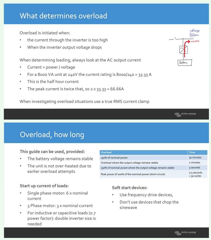

That's because fridge power ratings (e.g. 50W) are usually average power over a day according to testing (50W would be 1.2kWh/day or 438kWh/year, which seems rather high).
If this is the case and the compressor is only on for (say) 3h a day then the power while it's running would then be 400W. Typical startup current is often taken to be 3x-4x running current, which would then be up to 2kW for a fraction of a second. If the 50W is power while running then the peak power would be much lower than this, but then that wouldn't trip the inverter...
I don't know what the measurement interval on your Cerbo is (1 second?) but if the duration of the startup current is less than this (very likely) it could well be under-reading the actual peak value, which is what would trip an inverter.
P.S. Inverter overload data for Victron attached, this gives 6x nominal current at startup for single-phase motors like a fridge compressor.
