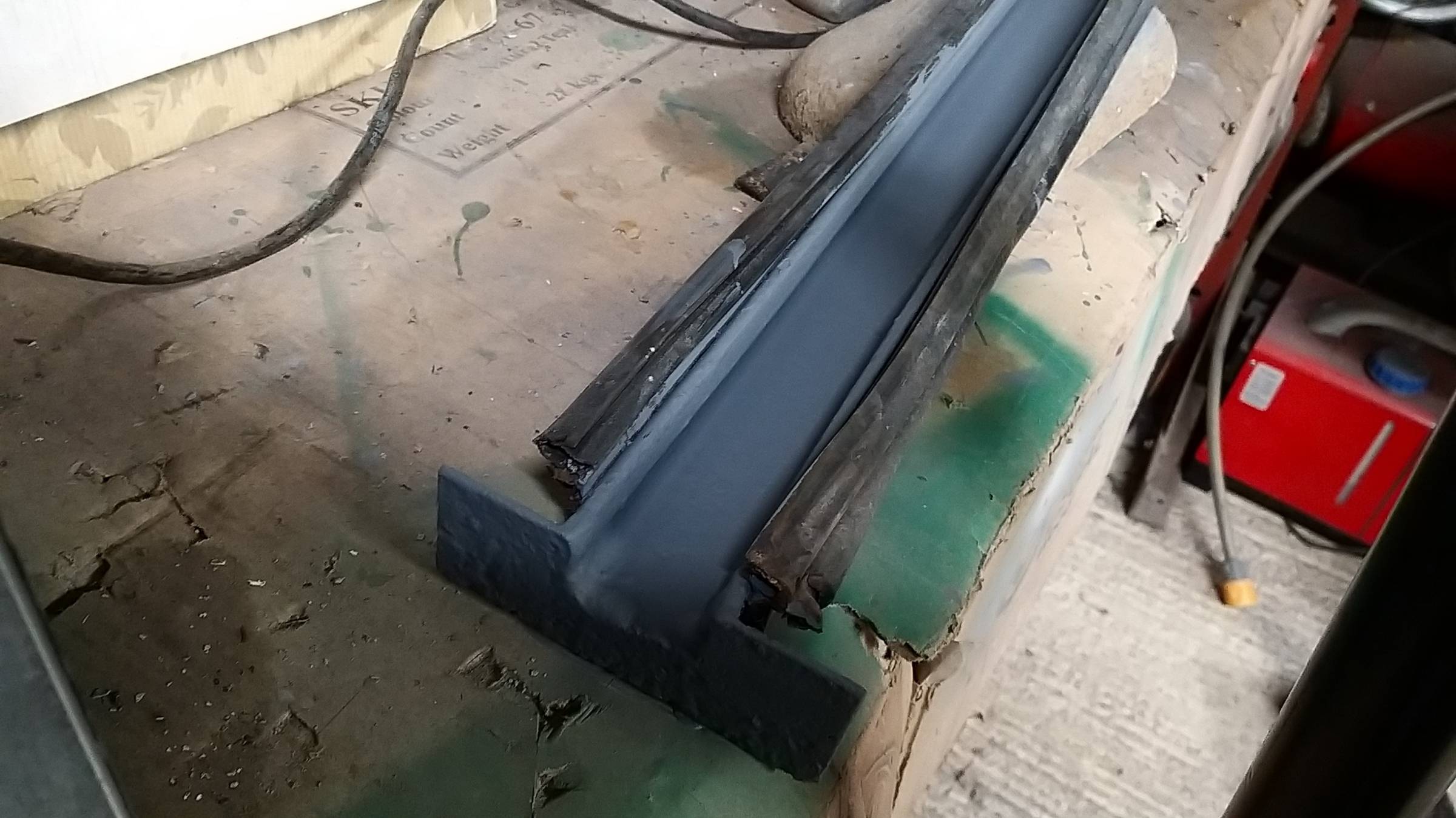

FWIW I used counter hinges where the two main arts are joined by an articulated joining piece. When opened, this allowed the board to drop slightly and rest on the side channels. This made it a little bit more difficult for it to fall down accidently.
