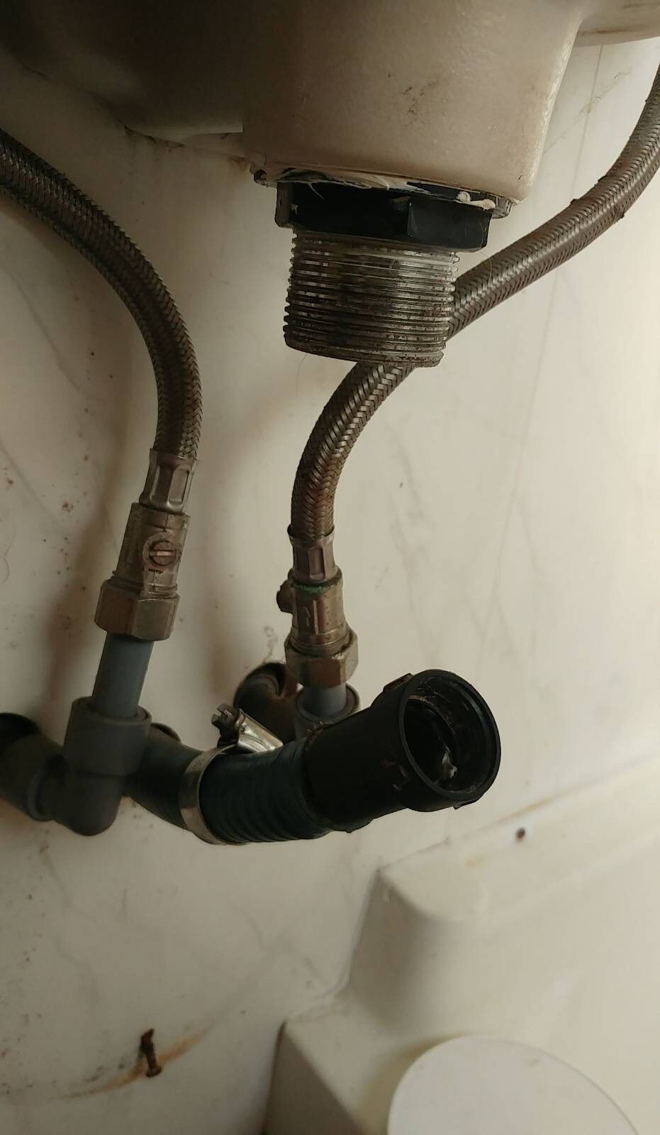

Parts to go from 42mm sink to 25mm pipes?
james2 replied to james2's topic in Boat Building & Maintenance
oh my gosh - thank you so much - as usual just knowing the right terms (in this case seems like '1 1/4" bsp' and 'hose tail' really helped the googles) makes alllll the difference. i think this will sort me out! now to try and get one quickly! -
Thanks for the reply but posting as I have spent a while searching all the usual places and can't find anything that does it. Links to specific parts that'll help me much appreciated. "42mm to 25mm hose adapter" doesnt have any useful hits that I can see -
I have a sink with a 42mm threaded outlet on it and need to connect that to a ~25mm outlet pipe that's already installed. The outlet pipe has a female threaded end on it, but this could be chopped off if needed. The space between the sink and the current end of the pipe is Can't find a single adaptor/reducer that does this, and I don't want to bodge it as this is the repair for the previous bodge. Pic attached. The space between the two ends is only about 4 or 5 cm, but I s'pose current end could be cut off the outlet pipe to make more space. Thanks for any ideas/part suggestions J
